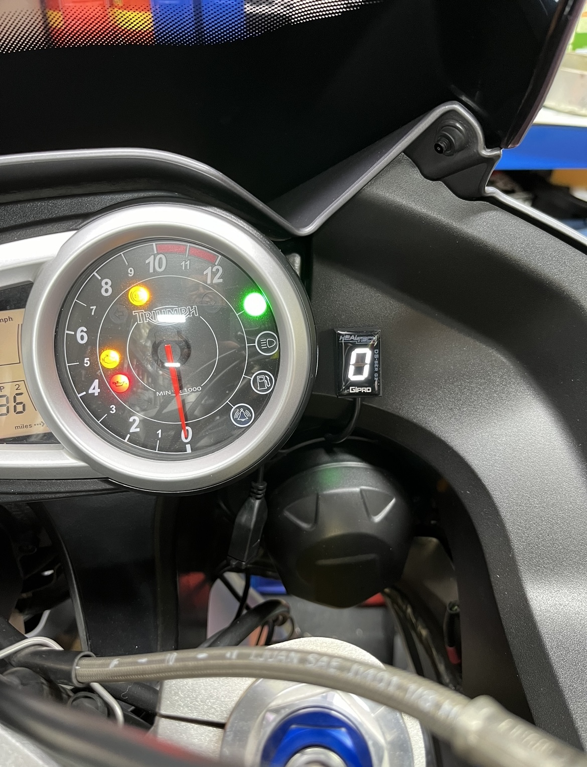

    Just to update. The £105 Healtech GIpro DS-Series G2 (GPDT) part number GPDT-T01 WHITE turned up mid week and I fitted it today.
    Plugged in to the diagnostic socket and tapped (soldered) in to a switched live feed. Routed from under the seat round the right side of the tank and through the fairing side trim to sit to the right of the clocks. The indicator lit up fine when the ignition was turned on but the weather is too rough for pulling the bike out and running the setup, so that’ll have to wait for now.

    Happy to report that the ‘Learning’ of the gears by the indicator went without issue and all appears to be working correctly.
    It stopped raining briefly enough this afternoon which gave opportunity to pull the bike out and do the set up. With the bike running up on the centre stand it was all very straight forward.
    Wasn't fit to go out for a run, but went up and down the gears a good few times and response is within a second I’d say of releasing the clutch for the display to change to the gear you are then in. I’ll give an update for how it performs on the move after the weather offers a chance for that to happen, but so far I’m very happy.
    When I spoke to Healtech before the purchase they did say the Series 2 units are a lot better than the first generation. Mind you, he was selling them so who knows - I’ve no previous experience to go off.
    With the Series 2 you do get options the previous model didn’t have - you can fine tune the response, increase/decrease the display brightness and even invert the display if it works out better routing wires to come from above rather than below.
    As you can see I opted for the white display and I’d say that’s in keeping with the bike - had briefly considered red, but that was the fireblade side of me coming to the surface I think :laughing:

    Finally got out on the Tiger to put the gear indicator in to real world testing and alls well. Shows the correct gear within second of releasing the clutch. Not confused if you change down (or up) by a few gears at a time. Was a low and bright sun but the display was still visible - I’m happy with it.
