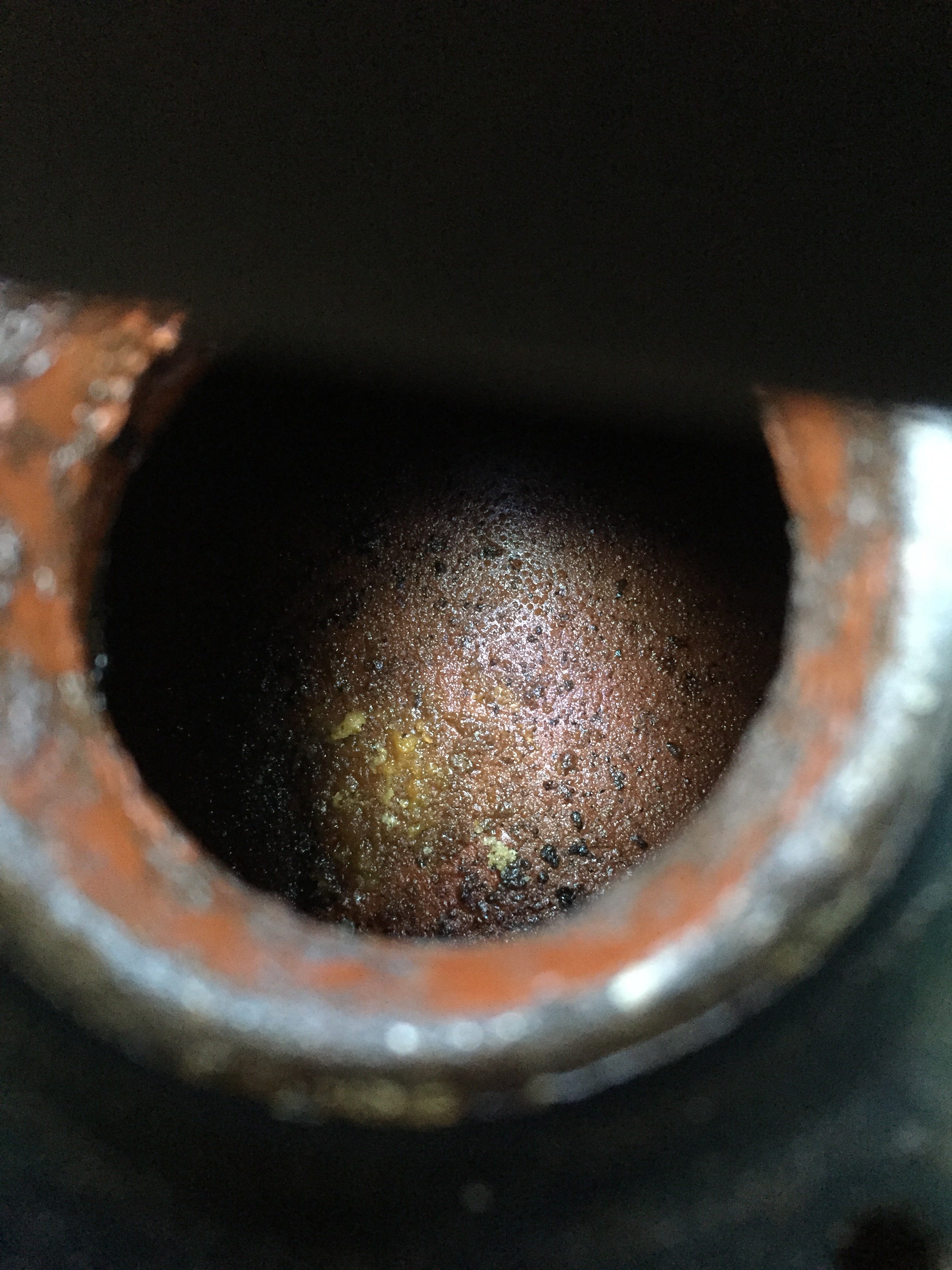

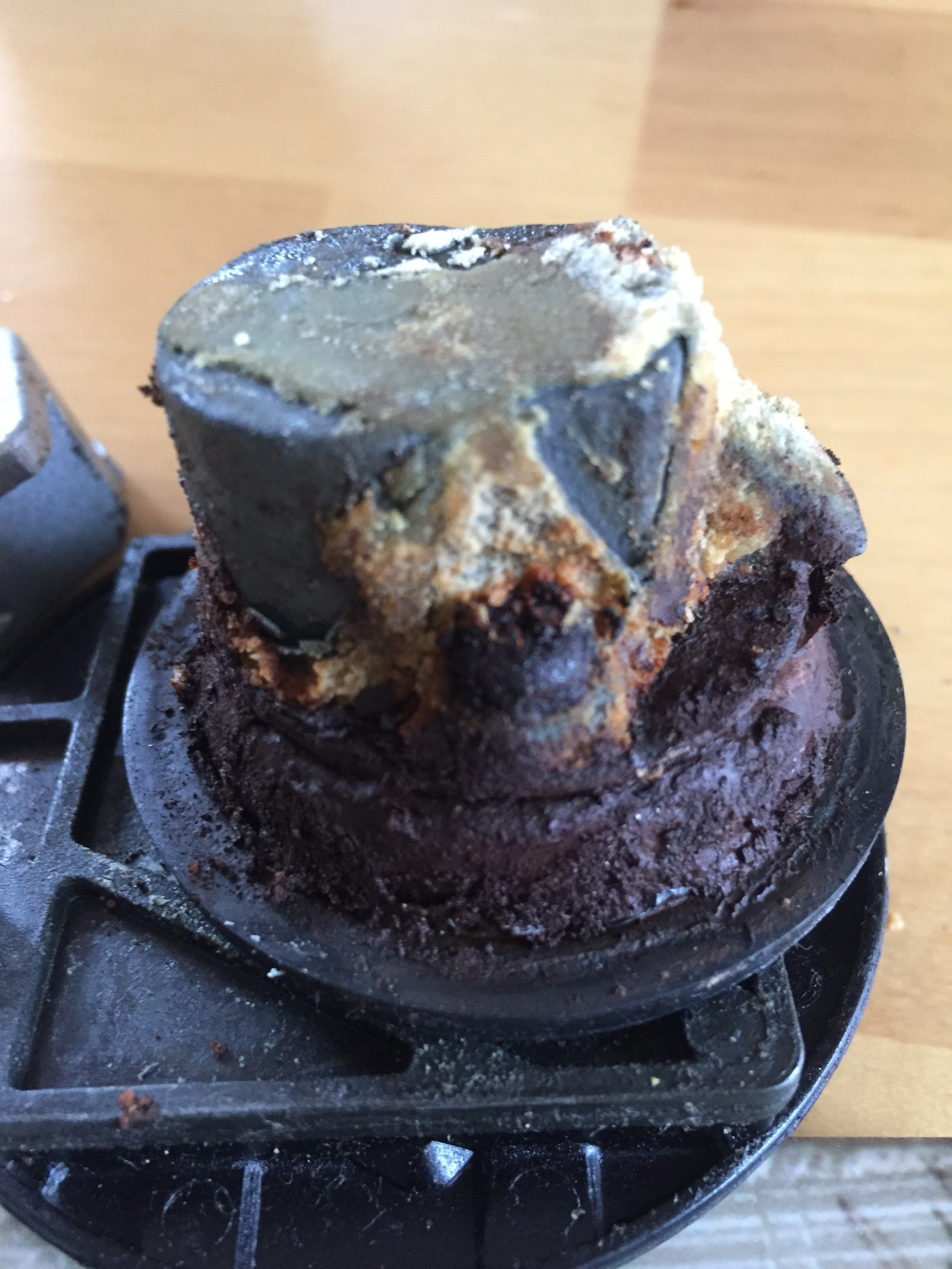

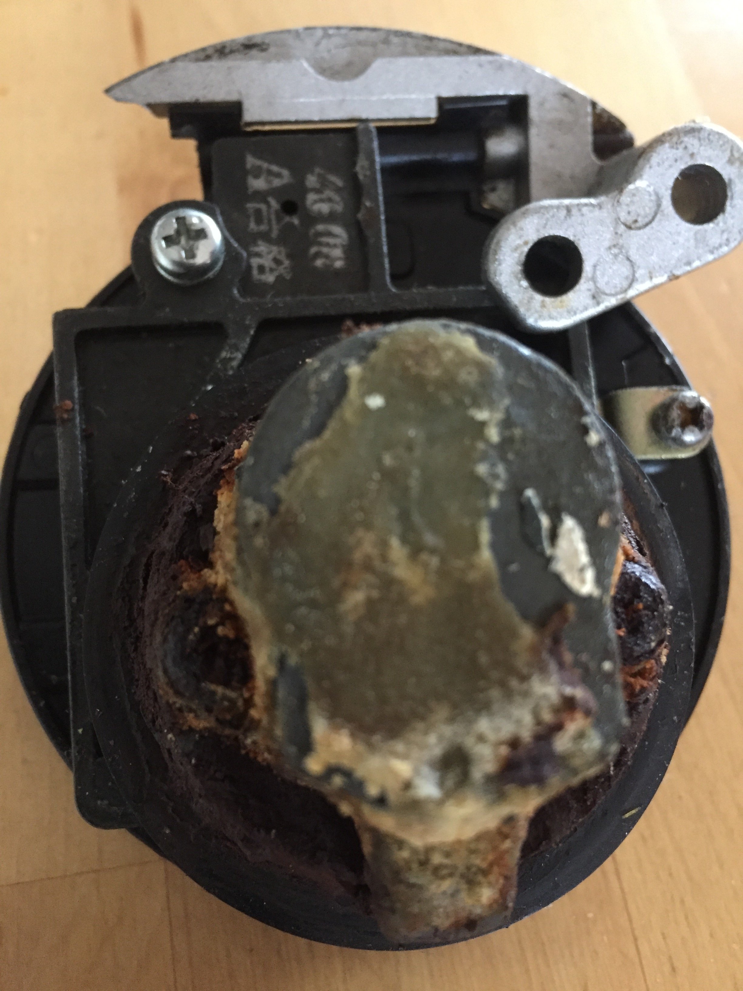

    Happy new year everybody, update on the fuel cap issue (see photos). No wonder it wouldn't unlock, the inside of the tank doesn't look too clever either. So new fuel filler cap and associated parts plus possibly a new tank?. Took the opportunity to take the carbs off as well, will pull them apart later. Now pros and cons on re-fitting original air box or fitting K&N filters, thoughts please.

    lol. Barn find? If the rest of the bike is in similar condition you’ve got a big project ahead of you.

    Before you bin the tank, or try expensive cleaning treatments try ordinary cheap vinegar.
    Almost fill the tank with vinegar, add a few large nuts shake the tank and then leave it for a few hours, shaking to rattle the nuts about, drain out the tank, separate the sediment and then put the vinegar back and repeat for several times. It might take several days but you will be surprised at the difference.
    When finished with the vinegar neutralise the tank with a solution of bicarbonate of soda.
    I did this on an old moped tank and the inside of the tank ended up looking like new - Best of luck!!!

    Wow, that really is bad

    Wow seconded.
    Replace the air box and get everything running, if you want upgrade later then fine.
    At least, that way you know whats to blame if you have problems.

    Thanks for all of the replies. I have just found out from the previous owner that the bike hadn't been in the shed for 2 years, in fact it has been in the shed since July 2007 and it hadn't been run for 2 years. No wonder it is in a state.
    Am I right in thinking that the filler cap is a "non vented type".
  14. Samsgrandad
    Samsgrandad Senior Member
    Dec 15, 2019
    Somerset
    It's certainly non vented now!!!
