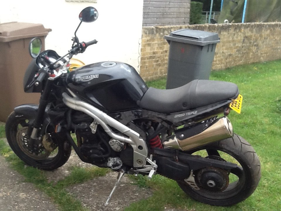

    image.jpg Hi All,
    Further to my newbie post regarding speed triple not starting, I have found out that this might be a fuel issue. I squirted a little petrol into the intakes and just for a second she fired up. So I took the fuel pump unit out of the tank as I could not hear it working. The inside of the tank and the pump/filter unit looks like it's from a bike from the 50's !
    The inside of the tank is so rusty that I find it hard to believe, the unit too is rusty and has had a botch job done. I think I need a new one. Have looked on ebay but unsure which to go for. This bike had. A different engine put into the frame as it does not tally up according to information I have been given.
    Questions, how can I find out what cc my engine is? Triumph dealers say they cannot help by just the engine number.
    Will any of the pumps work or will it have to be one for the engine cc?
    Can anyone tell me what tank has been fitted to the bike as if I can't clean out the tank, it will mean a new one?
    I'd be grateful of any info.
    Thanks
    Nigel

  12. nigel Bessant
    nigel Bessant Member
    Sep 26, 2014
    Well, the TT600 fuel pump arrived today and................it doesn't fit, the base plate is a larger diameter than mine.
    I'm at a loss as to the pump and tank I have

  14. Keith Inglis
    Keith Inglis Member
    Feb 17, 2015
    Kings Lynn
    Can you put some picks up so we can see if we can help.
    Keith

  16. nigel Bessant
    Sep 26, 2014
    I will Keith, photos are the only way forward with this thread me thinks.
    The coke and harpic is currently working it's way through the metal of the tank and if there is anything left of any resemblance I will take photographs.
    Joking aside, I have to leave the tank soaking for a week but will add pictures as soon as.
    I still can't identify the tank though, despite viewing 1300 of them on eBay as a reference!
  17. Keith Inglis
    Keith Inglis Member
    Feb 17, 2015
    Kings Lynn
    Nigel,
    I keep looking at your tank are you sure that is not a Trophy 900 tank it looks very similar to my 1992 Trophy ???
    Keith
  18. thebiglad
    5,064
    What year is your Speed Triple? Might be interesting to see what an original tank looks like?

  20. nigel Bessant
    Sep 26, 2014
    Definitely not a Trophy tank.
