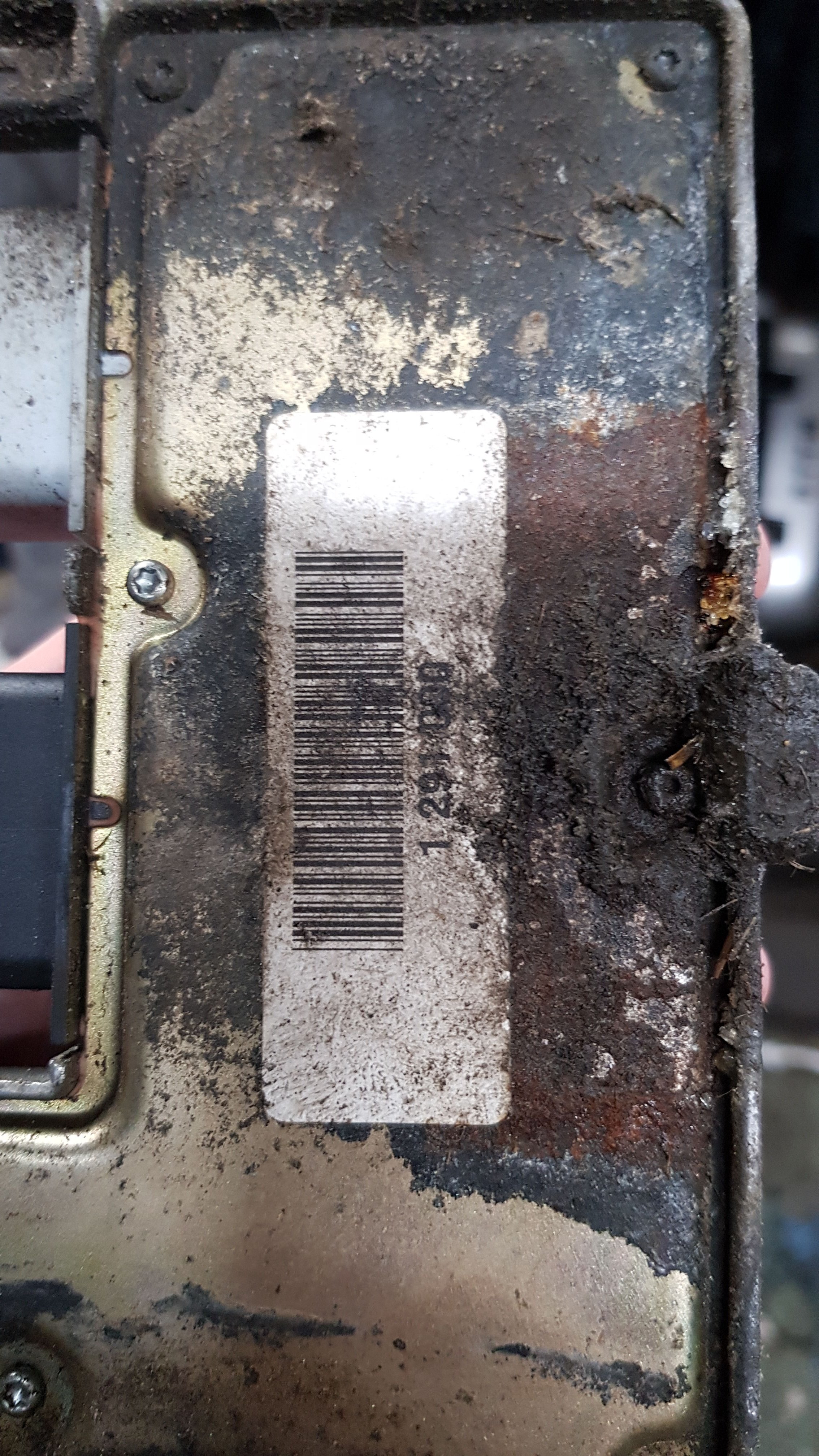

    Fault came back today. Swapped ECUs, fired right up. Swapped back, same issue. This photo shows state of the ECU I removed.
    Hopefully sorted!!!!
    Thank you everyone for your input.

    Sounds like you've sorted it.
    Pretty manky looking ECU you photographed there...hope that's the old one!
  12. freck
    freck Elite Member
    May 4, 2017
    1,719
    Preston, Lancs, UK
    Yep, that one’s f@#ked! :p
