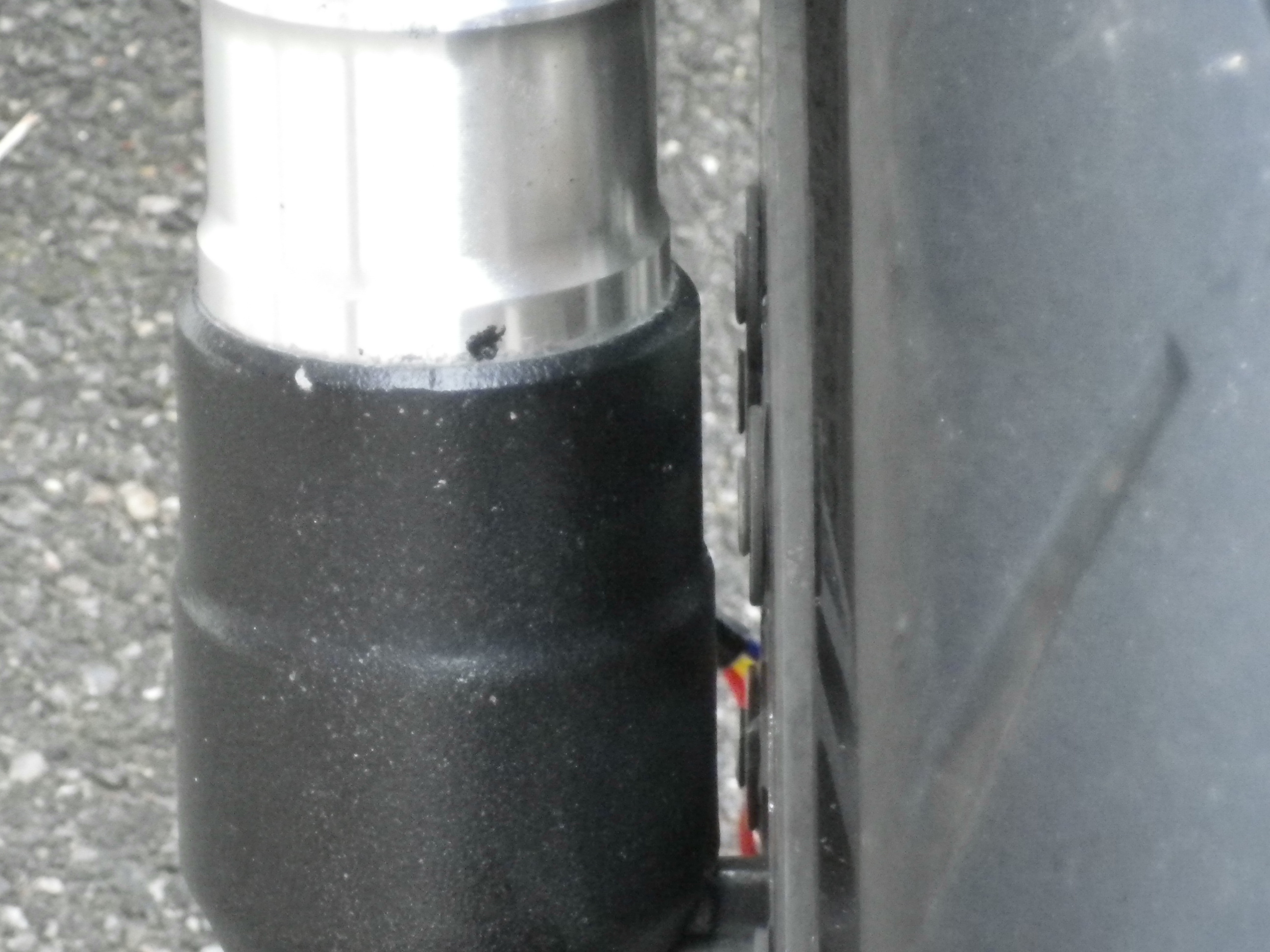

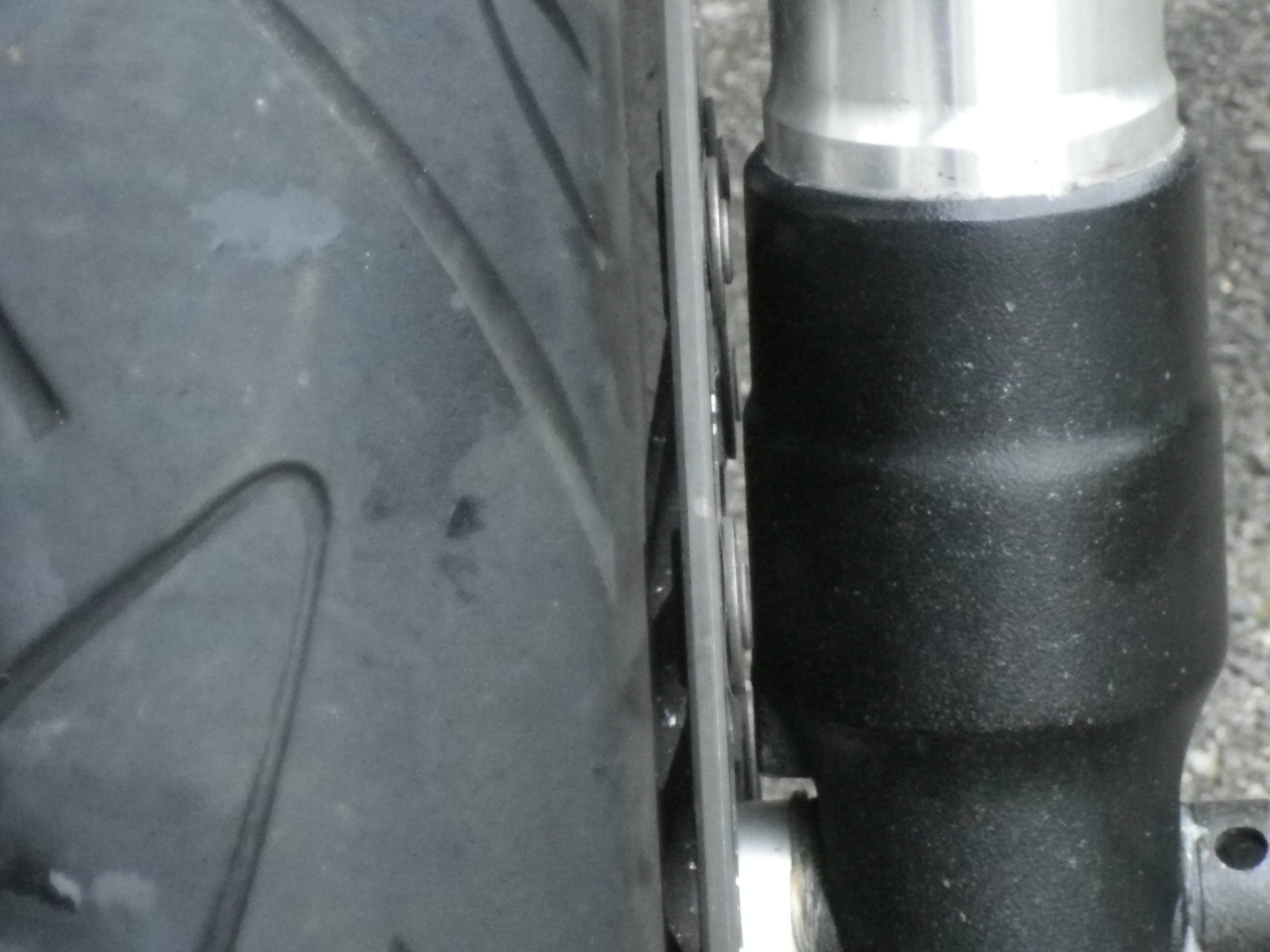

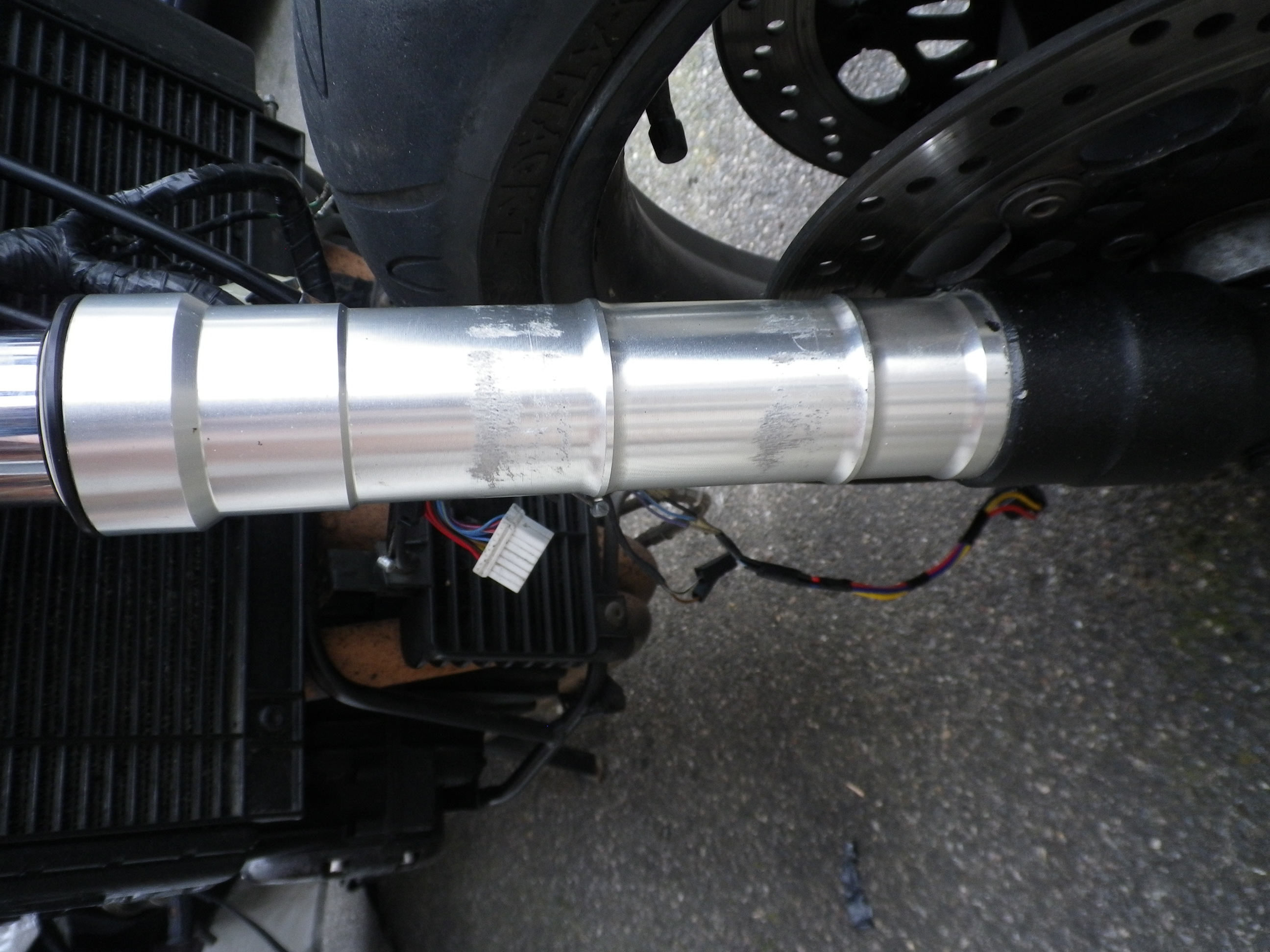

here are some pics of alignment also condition of forks. I did buy these cheap off e-bay and as shown is some scrape marks to sides. Bought them with a view to getting better set when can afford them. Then break these ones for p arts to sell
Is it purely spacing ie. Needs shifting left or right or are the forks pinching together at the axle meaning only one side needs spacing Is there much space to get the wheel and spacers inbetween the forks as it should be quite a snug fit with the correct overall width
When you have the calipers you will be able to determine how much you will have to move the wheel, this can be done by shaving one spacer down and making a new bigger one, the marks on the forks are the mudguard mountings
I think it is like darkman says once have calipers will be a bit wiser. Might just need, as t552says, the fork swiveling to get it to fit. If this happens then would indicate that fork is probably a bit bent. Just have to wait and see. Cheers for advice etc
