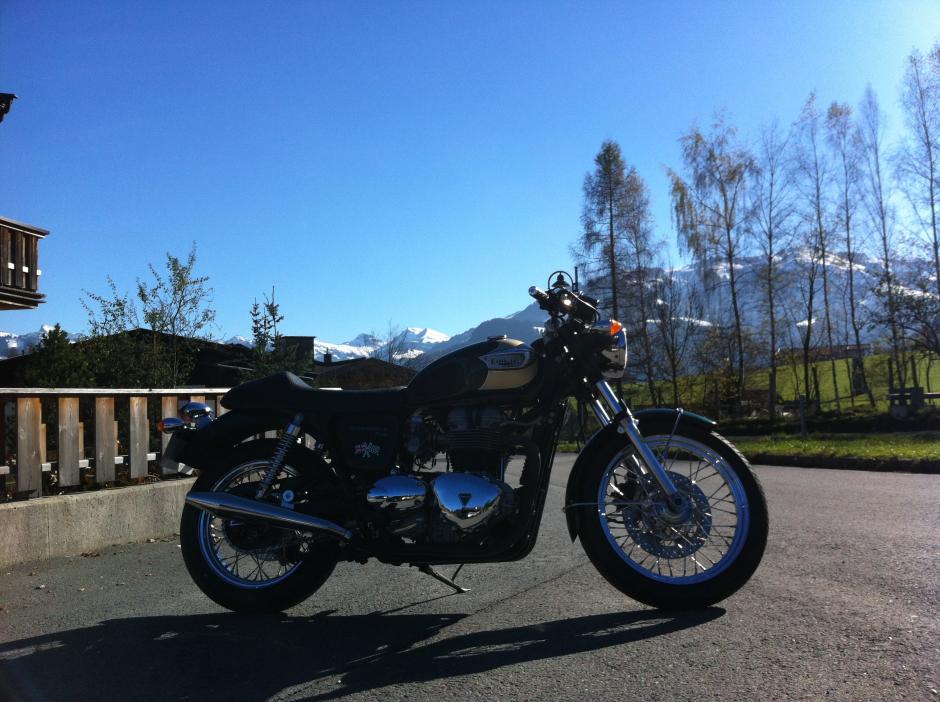

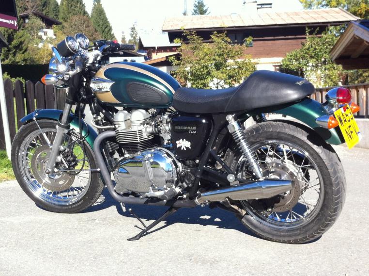

    I spent the entire morning thoroughly cleaning and polishing my bike. See attached image:
    But given that its now so clean and I rode a lot in the last 3 days I think I'll give it a well deserved rest today. My first experience of Bonneville ownership was amazing, the Ardennes, the Black Forest, some beautiful scenery on an amazing machine that is great fun. Plus I've never had so many comments like "nice bike mate" in my life!
    A massive thanks for your help!

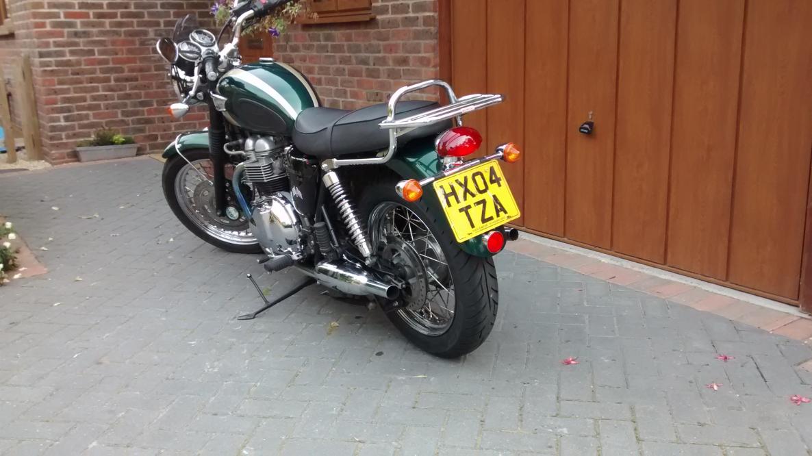

  11. steve lovatt
    9,230
    As our bikes are of a similar age I'm not surprised that they are the same colour ,but I'm amazed that we appear to have the same stickers on the side panel! IMG_20140917_095052613.jpg
