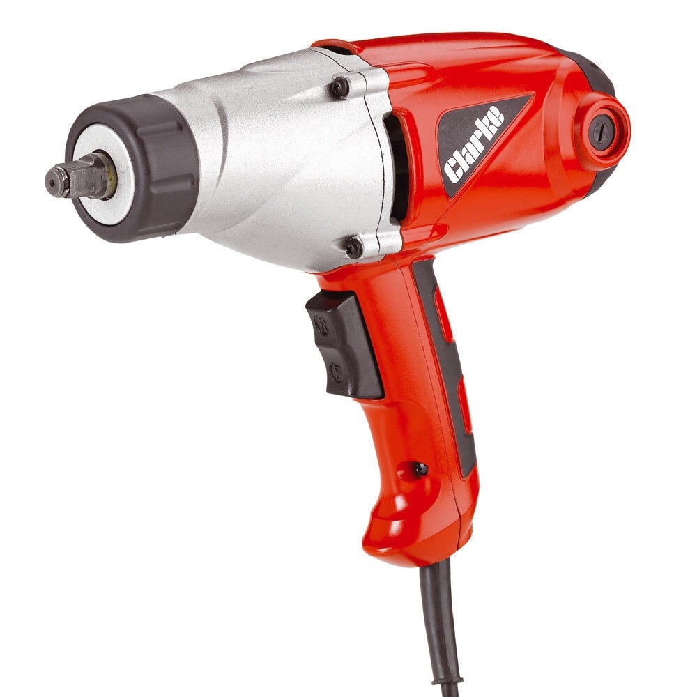

    Air gun mate two second job then

    177 or 22
