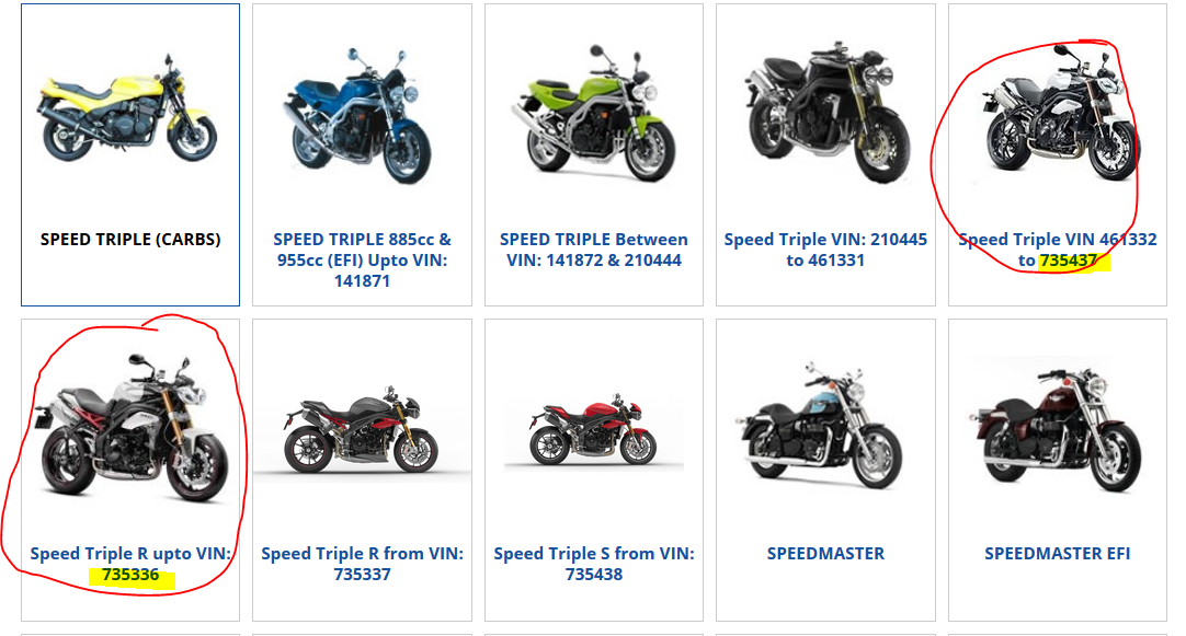

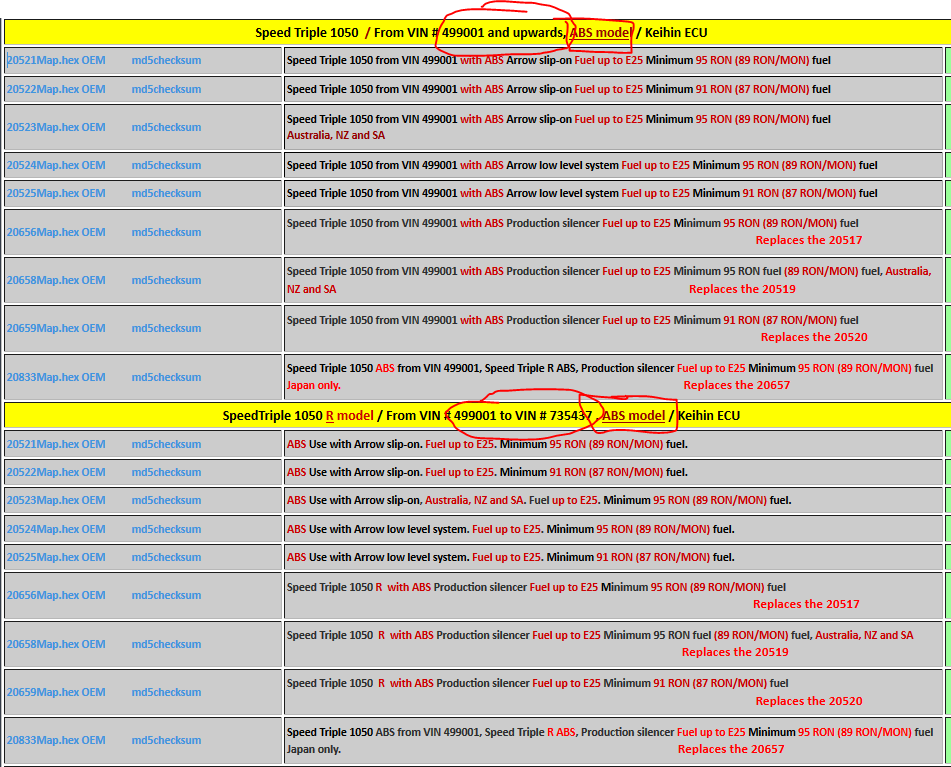

    Tuneecu website says up to VIN 735437. Also says up to MY 2014. check the VIN before you commit.

    Cheers Youngy, I have found it on the Tune ECU website
    Speed Triple models TuneECU is available for as you say up to 735437 which I think is the 2015 model, but if I do go ahead with this, the VIN is the critical thing to check
