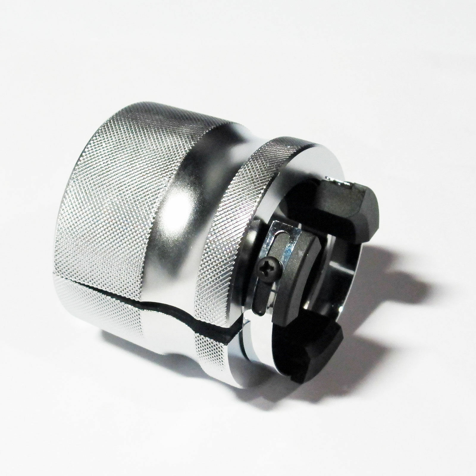

  4. Sprinter
    6,027
    Old seal, bit of waste pipe from under the sink, ( split down the length, filed, and taped, to stop scratching it still claps the fork) and I bought this, last year,
    Seems to work well, although Ive only used it once. It takes some of the worry out of the job.
