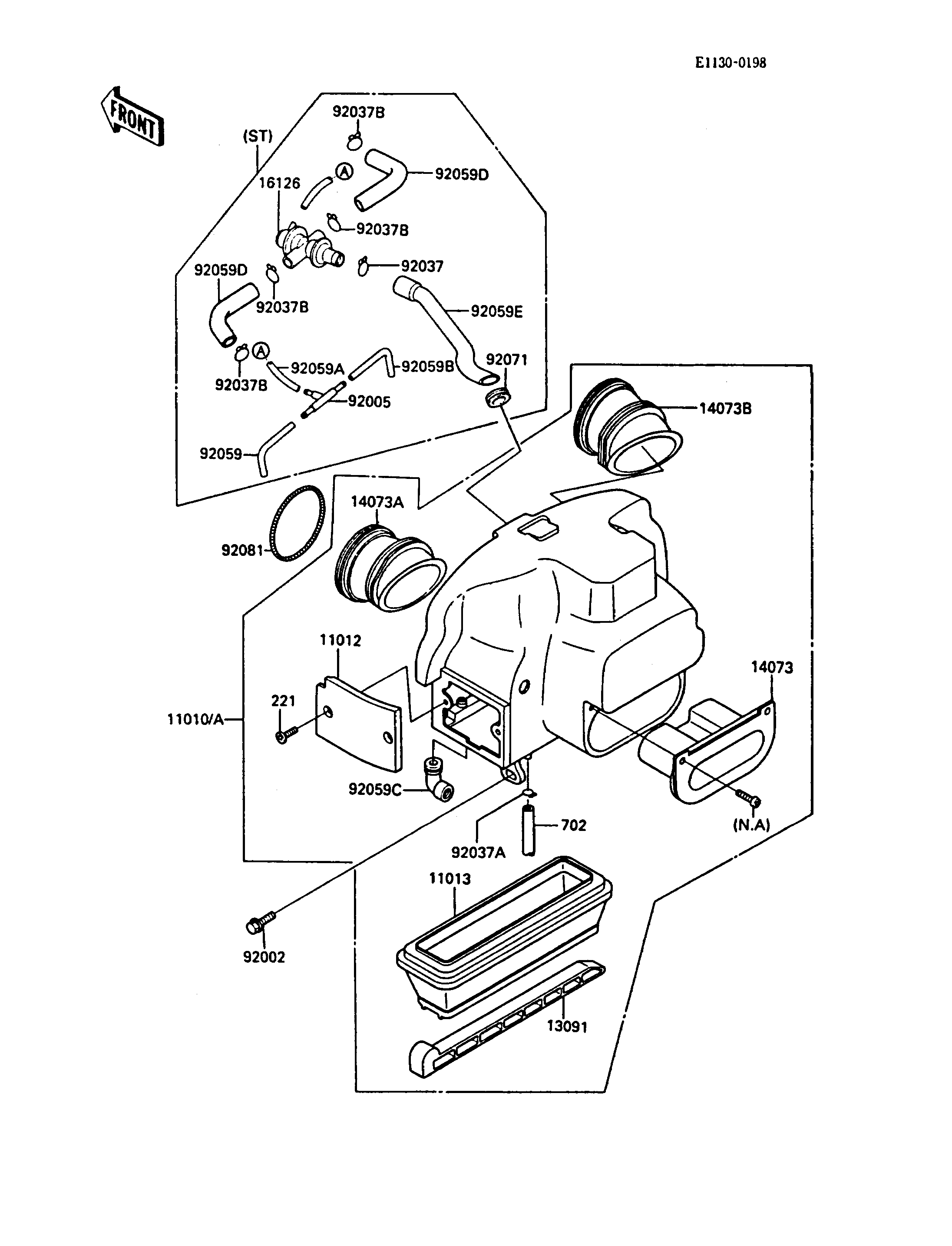

    How on earth do you fit the airbox on a 2003 trophy? I bought mine with those stupid (what I call pancake) filters on and it ran like a bag of s##t so have decided to put the original back on but it looks like I have to remove half the bike first, please I need help!!

    You seriously need to rethink that statement " remove half the bike" if my 94 trident air box removal is anything to go by ! It would be at least 55% , and it's very hard to get it back together without damaging the air filter box and the tubes linking to the carburettors.

    I'm not sure if the 1200 is the same as my 900 but my solution after taking off the side panels, tank,air inlet pipes and boxes the screws that attach the inlet side of the airbox proper come out then this slides back just enough to get the filter out (mine has a K&N replacement one).
    If you loosen the clips that hold the box onto the carbs it is just possible to remove the box and filter as one.
    With the box and filter out you can modify the inlet side that wraps round the frame to make next time easier, cut the inlet piece in half down the line of the frame so the two halves can be removed and refitted from each side.
    Absolute air tightness is not essential as any gaps are before the filter and not all the difficult screws are necessary for the same reason. I only replace the outer 4 on each side.

    There is a special place in hell for the designer of that airbox.
    Not only do you have to dismantle half the bike, they charge you £60 (sixty bloody quid!) for the filter and the airbox, and it's not even a proper paper filter, just a crappy piece of foam.
    It's a pity that they didn't copy the design of the GPZ900R airbox when they copied everything else from Kawasaki. :) Remove the side panel, undo the two screws that secure the side of the airbox, slide out a clip, remove and replace the filter (£17 from Wemoto - crappy foam like the OEM part, though), then put back the bits you took off. If you were really slow, I bet you could make the job last as long as, oh... two minutes?
