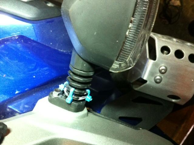

    next problem is replacing an indicator I broke whilst moving the bike in and out the garage. Why oh why make the stems of the indicators out of hard plastic, especially as this bike is designed for off road and is likely to fall over a few times, every time it hits the floor that a new indicator stem and you can't buy them seperately so its a whole indicator at £38... FFS
    I think these need changing for small LED ones. Anyone done this modification and will the flasher unit need changing?

    Get the small Oxford ones think they are straight forward swap... I have the triumph led indicators... Worst case you get the triumph led relay....its approx £10. I think..

    I bought the triumph relay and have now put the Oxford Nano LED's on and they are brilliantly bright, just make sure you get the angle right. I had some for £30 off ebay before and they were useless......

    Looking at the fitment they could well fit so will have to pop into the Triumph dealer at the weekend and seek some advice!
    Cant leave the repair I made as it look shite! :rolleyes:
