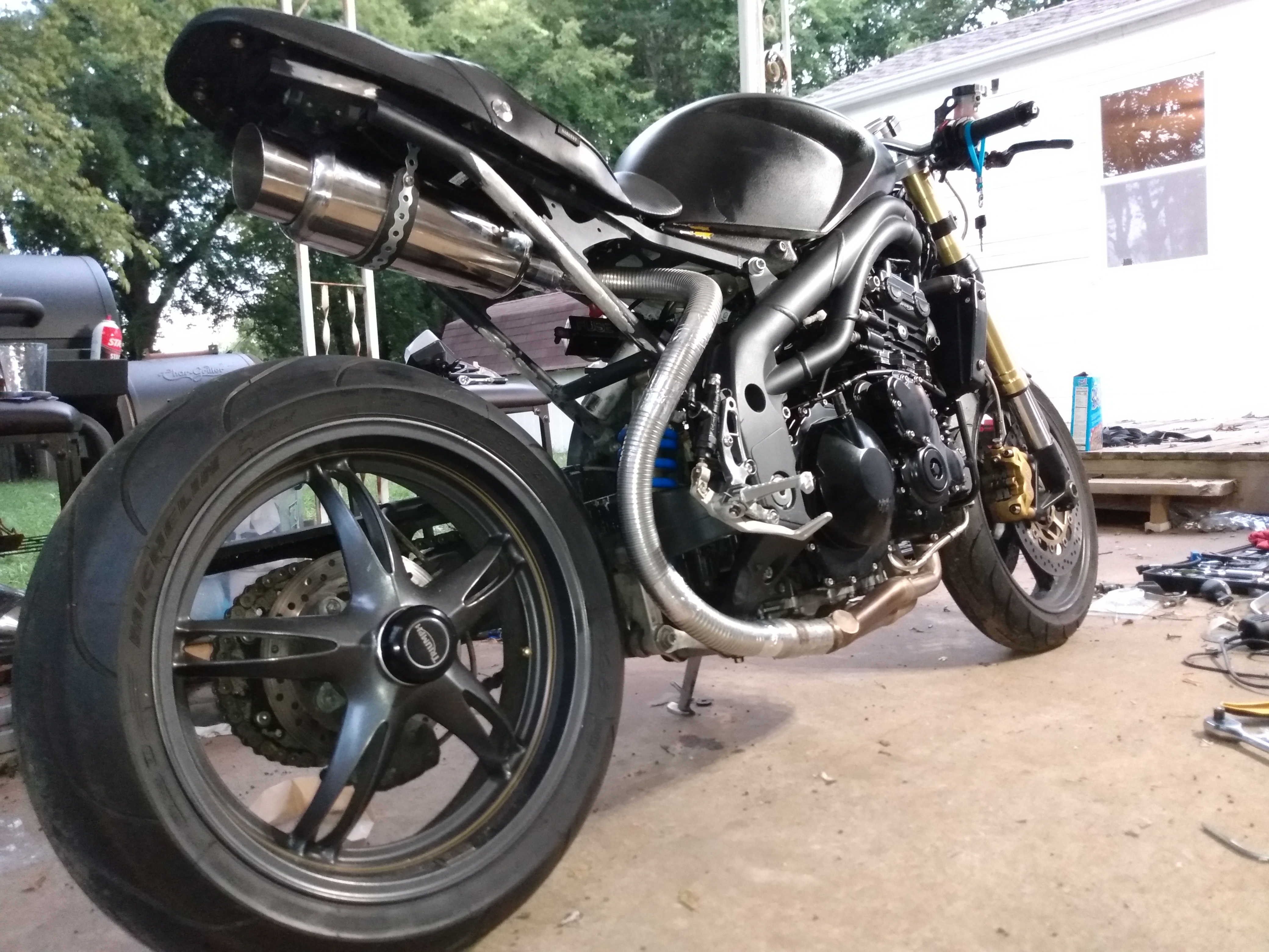

    Using flex pipe to fabricate exhaust routes. The final prototype will be taped to hold shape as a pattern for the exhaust shop.
    Thoughts on the current route?

  2. Arno triple
    Arno triple Senior Member
    Aug 26, 2018
    614
    Looks nice! But won’t you get your leg fried when riding it?
  3. Cody
    Cody New Member
    Aug 2, 2019
    15
    Nashville
    Great point. I plan on sealing then wrapping it in titanium exhaust wrap. Maybe some additional heat wrap around the muffler itself.
  4. Rocker
    Rocker Elite Member
    May 1, 2016
    1,662
    Suffolk
    Sorry mate don’t like it
  5. Rocker
    Rocker Elite Member
    May 1, 2016
    1,662
    Suffolk
    What about adapting the original by cutting off the right pipe welding up the
    hole and rebending the top of the left to get to the centre
  6. Cody
    Cody New Member
    Aug 2, 2019
    15
    Nashville
    Interesting idea. My desire here was to have some creative flexibility, hence the flex pipe. Maybe I will come the stock route with that idea and flex pipe.
