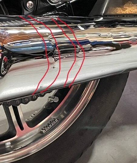

    Greetings!
    There are small rust spots and bulges occurring on my right-side muffler. The left-side muffler appears to be fine. What's even more interesting (or disturbing) is that it's occurring around the circumference.
    The spots are hard to see in the pic, but basically there two areas (identified within the two sets of red markings) where the issue has occurred.
    Anyone out there observed similar degradation?
    Thanks!

    Bulging possibly caused by the internal baffles expanding and contracting when hot. It appears to be rusting from the inside and will only get worse so re-chroming might not be an option if the steel is about to hole?

    I agree with Triple X your problem appears to be coming from the inside out probably the baffles rusting. No point in re-chroming that one and your secondhand one may still show the scratches after chroming if they are deep

    Thank you for your insight! I'm confident you are correct.

    Update: After pulling the right-side muffler yesterday, I noticed there is something loose (and rattles around) within the baffle area.

    Could be worth checking the left one as well. Might be that they both need replacing? Nothing rattling inside your spare right one I take it?
