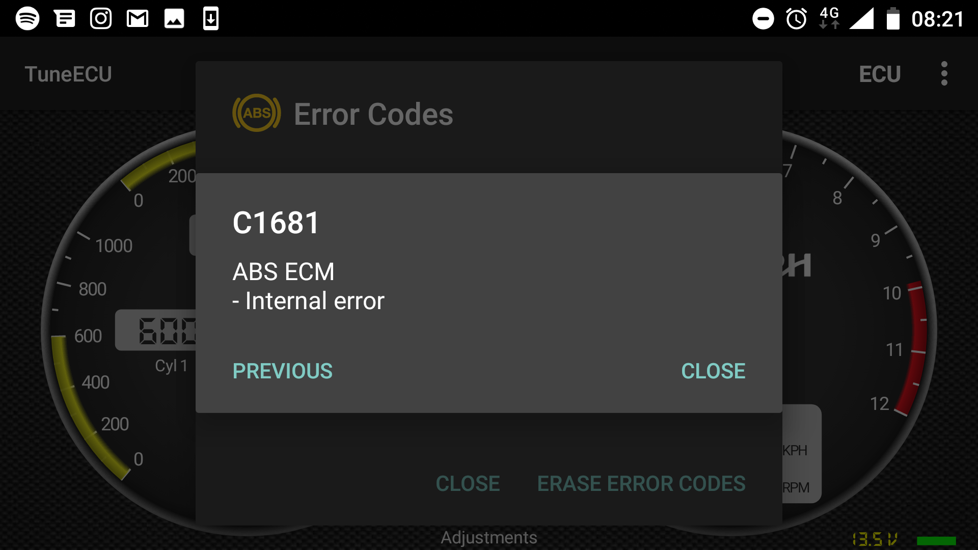

    So cleaned up the sensor and rode to work this morning after clearing the codes.
    Had a new batch of different codes pop through. Ill post below.

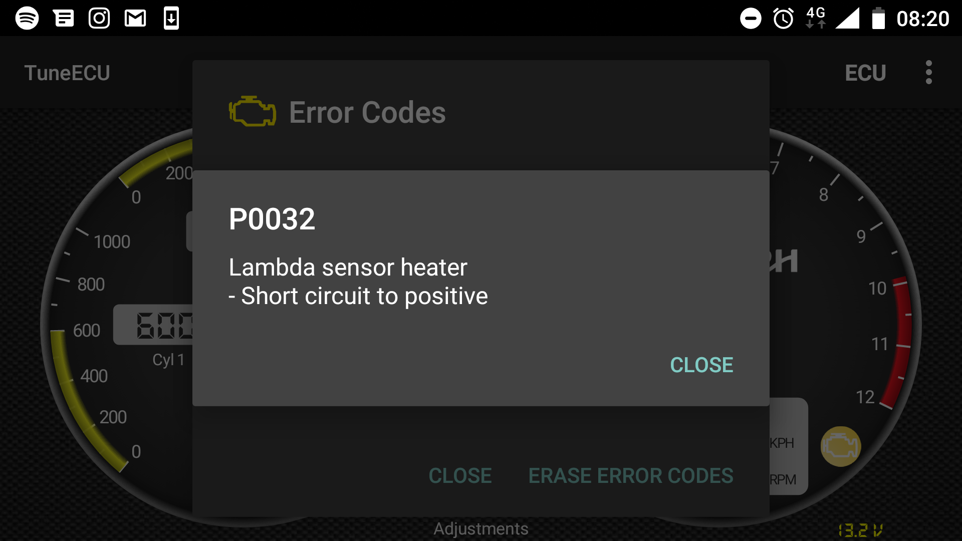

  9. france_54
    france_54 Member
    Apr 17, 2018
    26
    Shropshire
    Error codes from this morning

  13. Callumity
    Callumity Elite Member
    Feb 25, 2017
    3,358
    Nr Biggar
    Are you confusing the lambda sensor with the unrelated abs sensor?
    P0032 appears to relate to your exhaust sensor pre-heater to ensure the ECU gets the correct signal from cold. The lambda may work perfectly well when warm.
    The reluctor and abs sensor supply information about wheel speed to release brake fluid pressure in a skid situation and in some applications compare front and rear wheel speeds for traction control.
  14. france_54
    france_54 Member
    Apr 17, 2018
    26
    Shropshire
    Reading up from the Lambda sensor - if there are supplied with inconsistent or low voltage they can return false error codes so I was wondering if therefore that error could be related to a battery/charging issue.
    As for the ABS - I think your evaluation that either the pulser ring or the sensor is shot. I have popped out to look at the ring and it is clean, dull like the finish has been taken off but it is clean. So I am leaning towards the sensor unless the coating/finish on the ring is relevant

  17. france_54
    france_54 Member
    Apr 17, 2018
    26
    Shropshire
    So update - I detached the sensor and put the volt meter on it to measure the resistance and surely enough the ohms is ever rising rather than that constant...
    just ordered a replacement and will post back here with the results.
