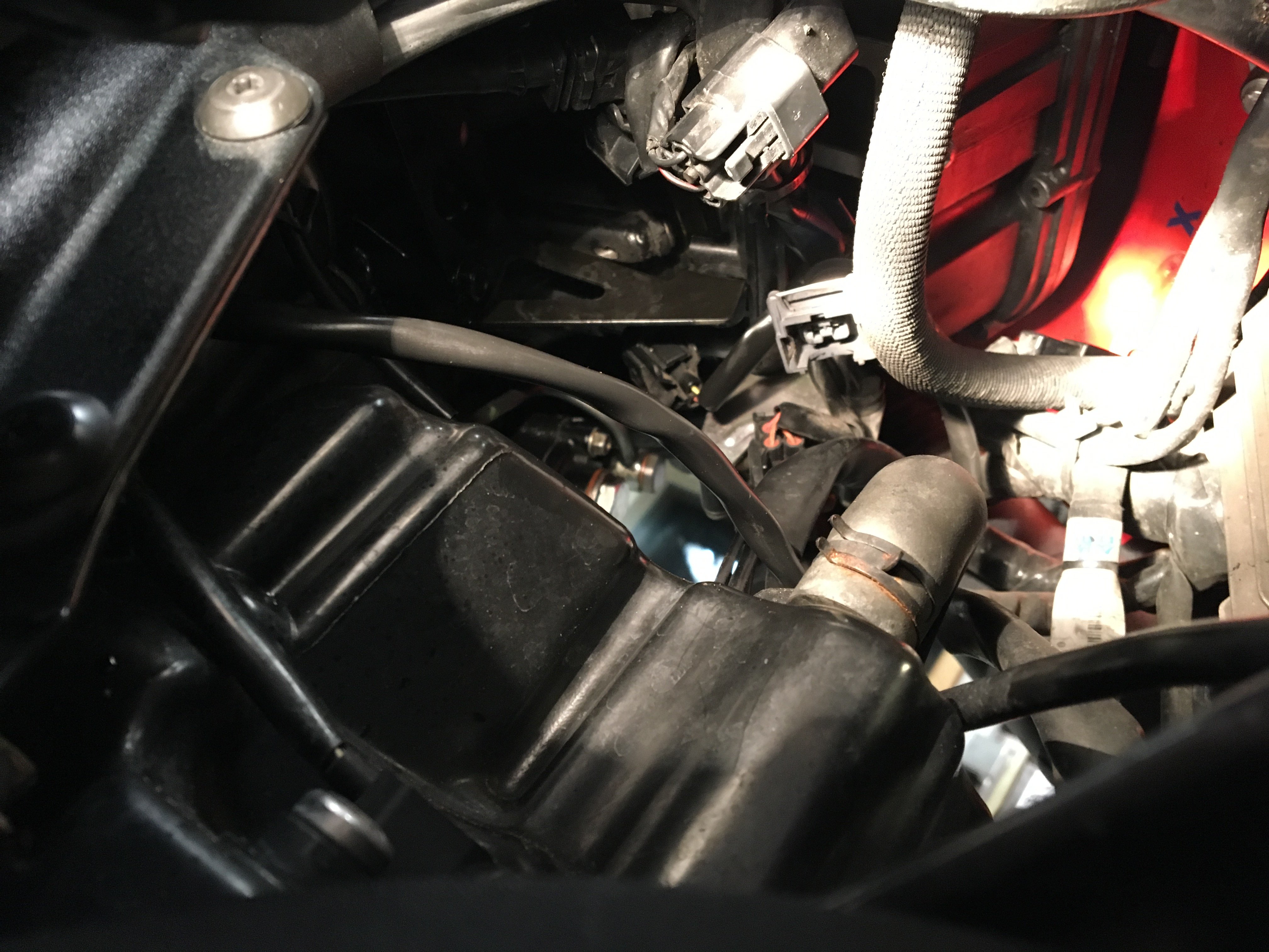

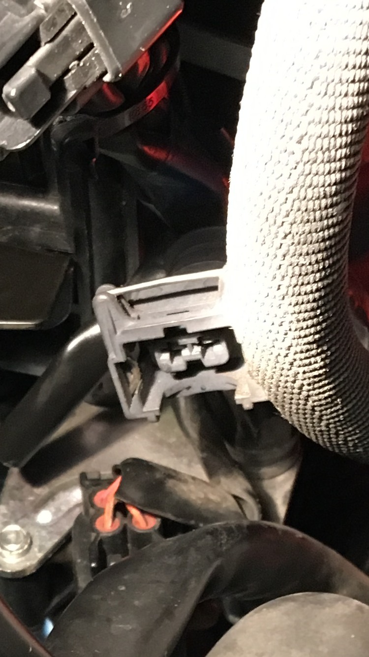

    I replaced the dead gasket and checked the valves (all were good). And just starter the engine again tonight. Haven't driven on her yet.
    Ticking is gone!
    Very happy with the results. But i have one plug over, i can't find the other end. Any thoughs on what it can be?
    The check engine light is also on.

    Good work mate, hope the motor behaves for you now. The plug, if it is hanging from under the injector rail, is on all bikes and on our models is unused. It's probably got something to do with emissions for the US market.
    #15
