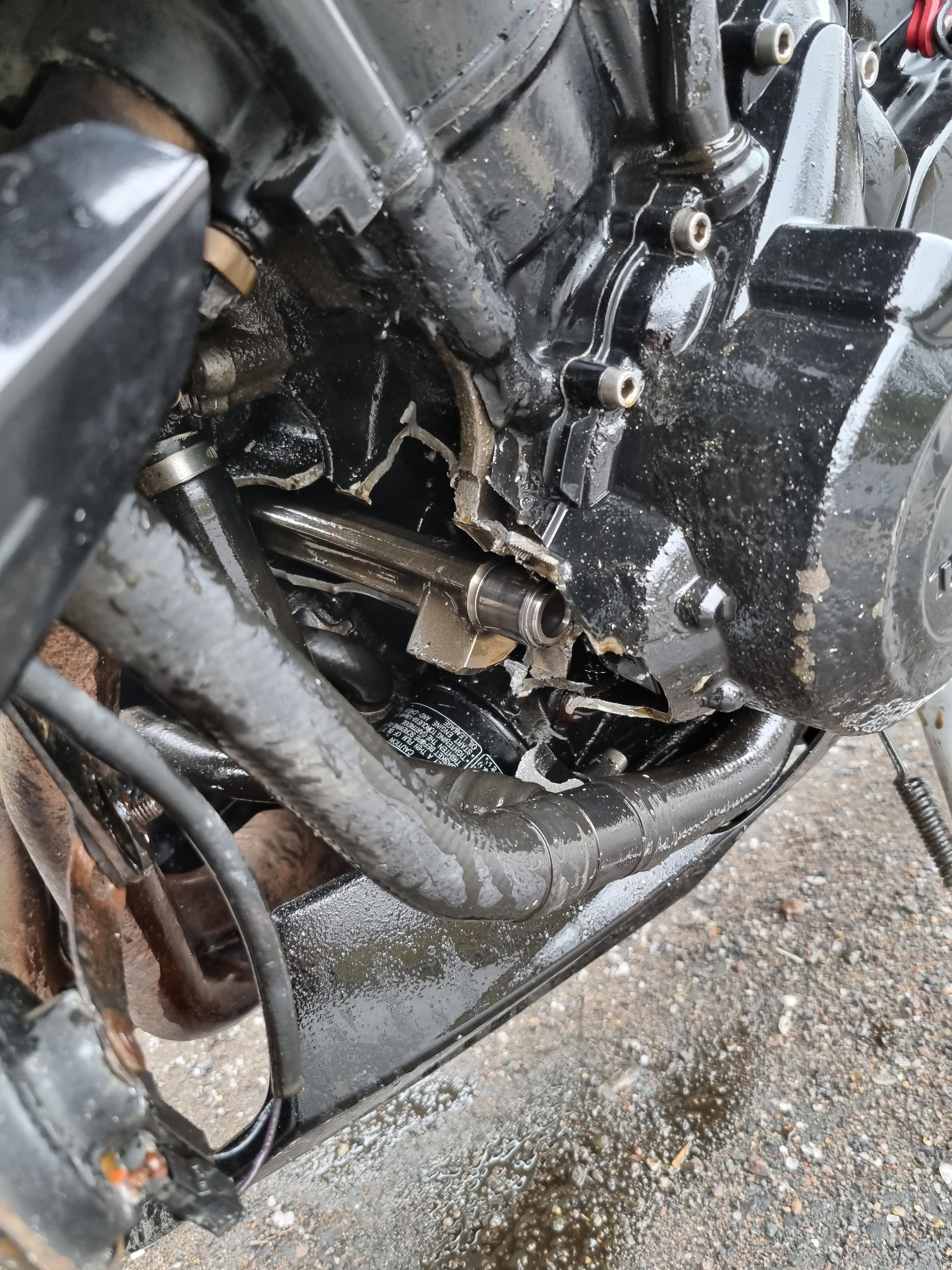

    Unfortunately yesterday going down the M1 my engine decide it was time to blowup. Very sad day becouse I did buy the bike a month ago. I've got a massive hole on the cranckshaft case. I'm going to take the engine out, and see why it did fail and what I can save for at least have some money back . But that is a story for later.

    These engines are normally very tough and take a llot of abuse, failures like that are fairly rare. Hard to tell from the photo what has gone wrong, that's the balancer shaft poking out, the chain driven oil pump is also around that area. My guess is an oil related issue down to poor maintenance or unsuitable oil, I only used high quality fully synthetic on mine with a new OEM filter every change.
