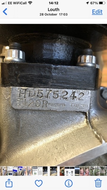

    Hello out there.. wonder if anyone could offer some help in identifying an engine number.. My brother has bought an American imported T120r which has six (not five as seems normal) numbers after the initial ‘HD’ stamp then 120r underneath the numbers…
    Any advice or information would be appreciated..

    Hello Iron , not sure if the image is enclosed..
    Stewart

    HD is a July 1970 frame or engine number and it would only have had five numbers so possibly a miss stamp or re stamp with six numbers ? a 70 engine is the first of the engines fitted with the untimed breather in the chain case, more pictures of engine and frame with frame numbers would help. A 70 bike frame is the last of the pre oil in frame bikes as well.

    Hi there.. thanks for your input, interesting info…. Have spoken with Tant (brother) … the frame and engine numbers are not matched (frame numbers denote a 1968 model).. he is using the engine as a base for a custom build.. when l can l will post further pics …

    That last 2 doesn't look right, could it have been added to hide its original engine number?

    The stamps all look good and match those of the period.
    T120R is slightly lighter stamp as they mostly seem to be as this was done at an earlier time in the build process at the factory. It also has a slightly different shaped 2 - which is correct.
    I agree with @almegro that the last 2 looks to be a 'mis' stamp.

    The last number 2 looks to be different in font or depth to the other numbers.
    If you excluded the last number 2 would the numbers make sense i.e. in a parts book?

    to me it looks like the right "2" but not smacked as hard.
    but i suspect also it was an addition.
    if it was a factory screw up i wonder what the story was?

    Four. The 2 definitely looks a little suspect, along with an engine number in the half million plus range. ;)

    That last 2 looks as though it's been done by a different STAMP. compare the first number 2 with the second one.
