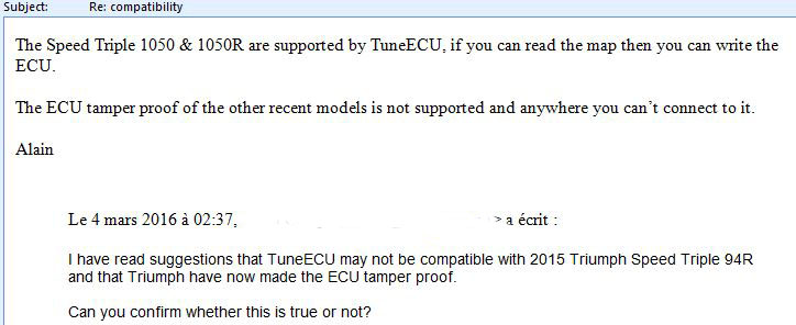

    Just for the record, anyone with an interest,
    received this reply from TuneECU....
    Also a few more recent posts on TriumphRat.
    So from the horses mouth, if you can connect you can write.
