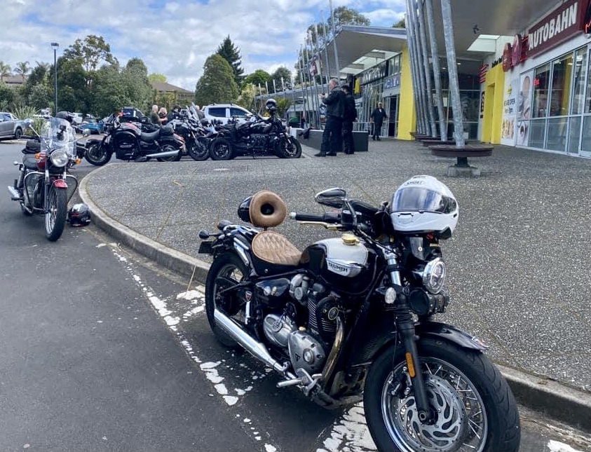

  6. Fork Lock
    Fork Lock Crème de la Crème
    Easy big fella! Sounds like you are getting a bit frustrated there.
    "Case Protectors", "Highway Bars" or "Engine Guards" as you called them are just that. The idea being that they protect the most expensive parts, not necessarily the smaller bolt on bits, like a shifter.
    Also, it depends on how big an "OOPS" we're talking about. In a simple tip over or low speed lay-down it's not likely the shifter would be damaged, but if it was, it's a replaceable part. It's on a pretty stout hunk of an aluminum mount and would bend without hurting the mount.
    I have a Bonnie Speedmaster. Basically, the same profile as your T100.

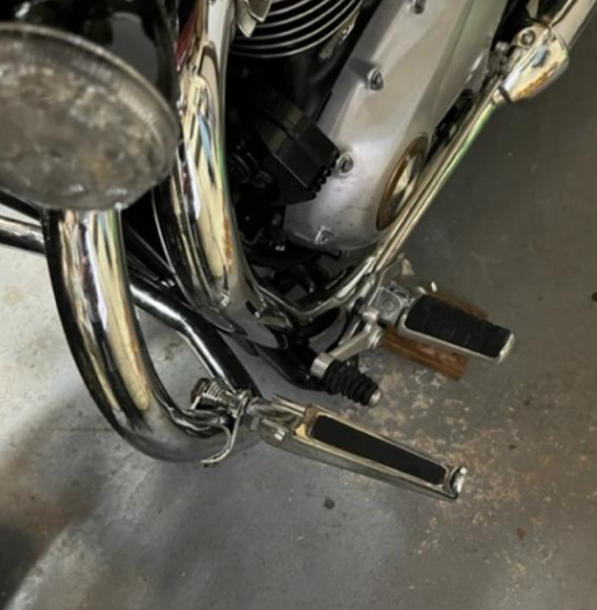

    I got the Triumph highway bars, but not for their protective qualities. I'm 6'2" and felt a bit cramped on the Speedy as I was coming off an 800 lb. Victory Touring Cruiser. I got them so I could attach pegs to give my legs a bit more extension. The pegs would just not stay put, so I drilled through the peg attachments into the highway bars and secured them with self-tapping screws. This gave the added benefit that the pegs protrude out past the shifter. The pegs are foldable, but their mounting lug extends the protection out another two inches or so.
    I did an interweb search (I Googled "T100 with highway bars") and came up with several options that might fill the bill.
    Here's a pic of my setup and a couple from the web. It looks like the Hepco bars would work, but the others seem a viable option, as well.
    Hope this helps.
    My Speedy
    Hepco Bars
    A couple other options

    I dunno...the Hepco bars appear to come out pretty far.
