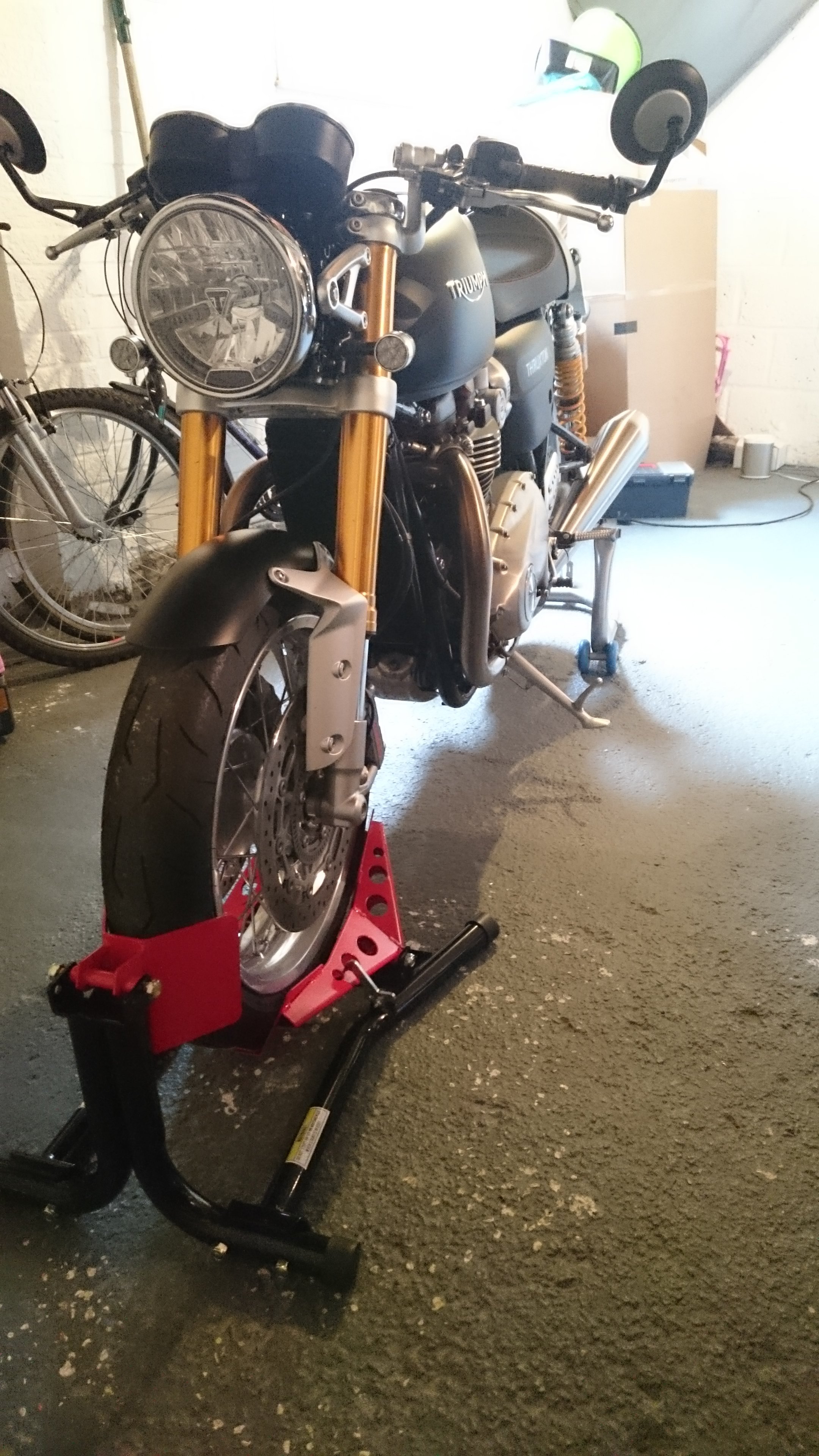

  13. Wassers
    Wassers Active Member
    May 27, 2016
    159
    136
    Berkshire
    Here's a photo of my bike using the front wheel chock. thruxton on stand.JPG
    #13
  14. Bonzo
    Bonzo Well-Known Member
    Apr 29, 2016
    301
    172
    IoM
    That wouldn't work for me Wassers - mine is silver :)
    Seriously though, with a chock I wouldn't be able to rise the front on my head stand :(
    Ill just have to take a deep breath & clench me bumcheeks.
