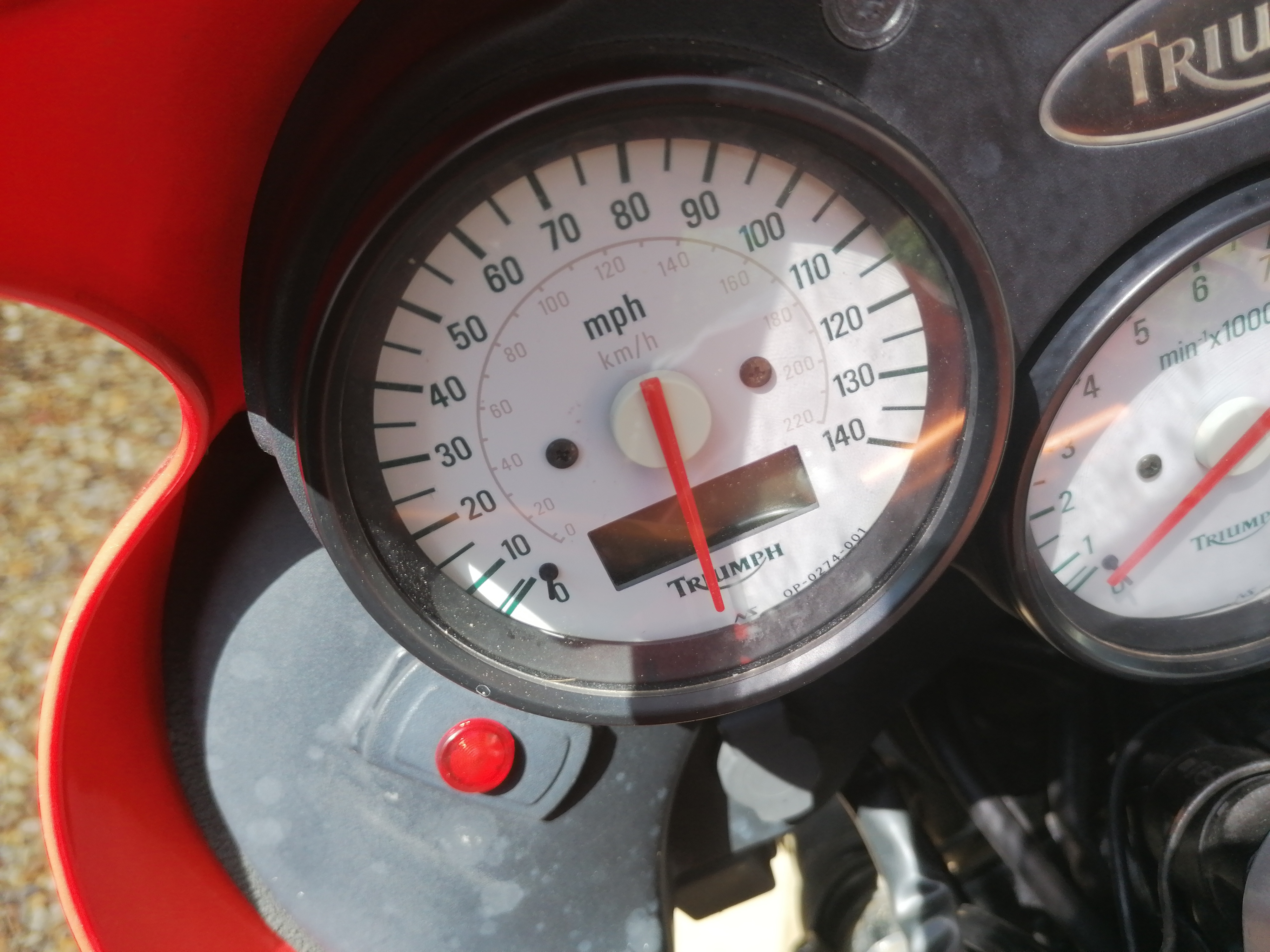

    Hi all, I bought a 2005 tiger 955i last summer and had a new stator fitted, no problems until now, 2000 miles later.
    On a ride out earlier this month my tacho and speedo started flicking on and off then went off.
    When I came to start my bike the next day it was dead, flat battery.
    I swapped the battery and all was good for 100 miles then the same thing happened.
    Do I need another new stator?
    Also my speedo needle is stuck 95% of the way around the dial and moves the other 5% when travelling and stops at the little pin at 0mph.
    Turning the bike off has no effect on this, any ideas please?

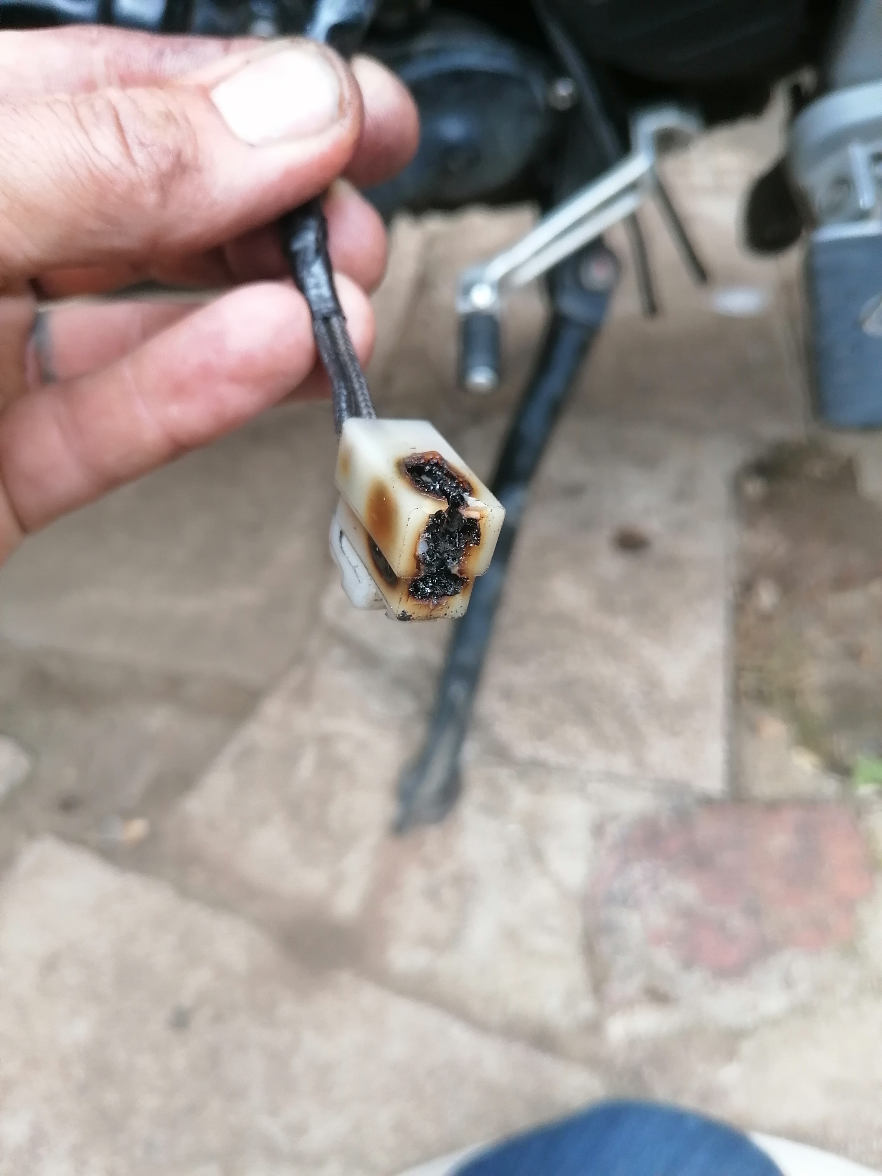

    Just got my multimeter, took off the plug, I think it's f**ked without testing!!
  13. Scott Clues
    Scott Clues New Member
    May 26, 2022
    2
    Multimeter says "That's right, f**ked".
  14. Scott Clues
    May 26, 2022
    2
    I've ordered a new one, should be here Tuesday.
    Any idea how to reset this speedo, or is it in the same club as the rectifier??
    Thank you ..
  15. Linx
    Linx Well-Known Member
    Mar 14, 2020
    197
    Stratford Upon Avon, UK
    :confounded:
    I expect your high voltage has blown it up
  16. Scott Clues
    May 26, 2022
    2
    Oooooouch!

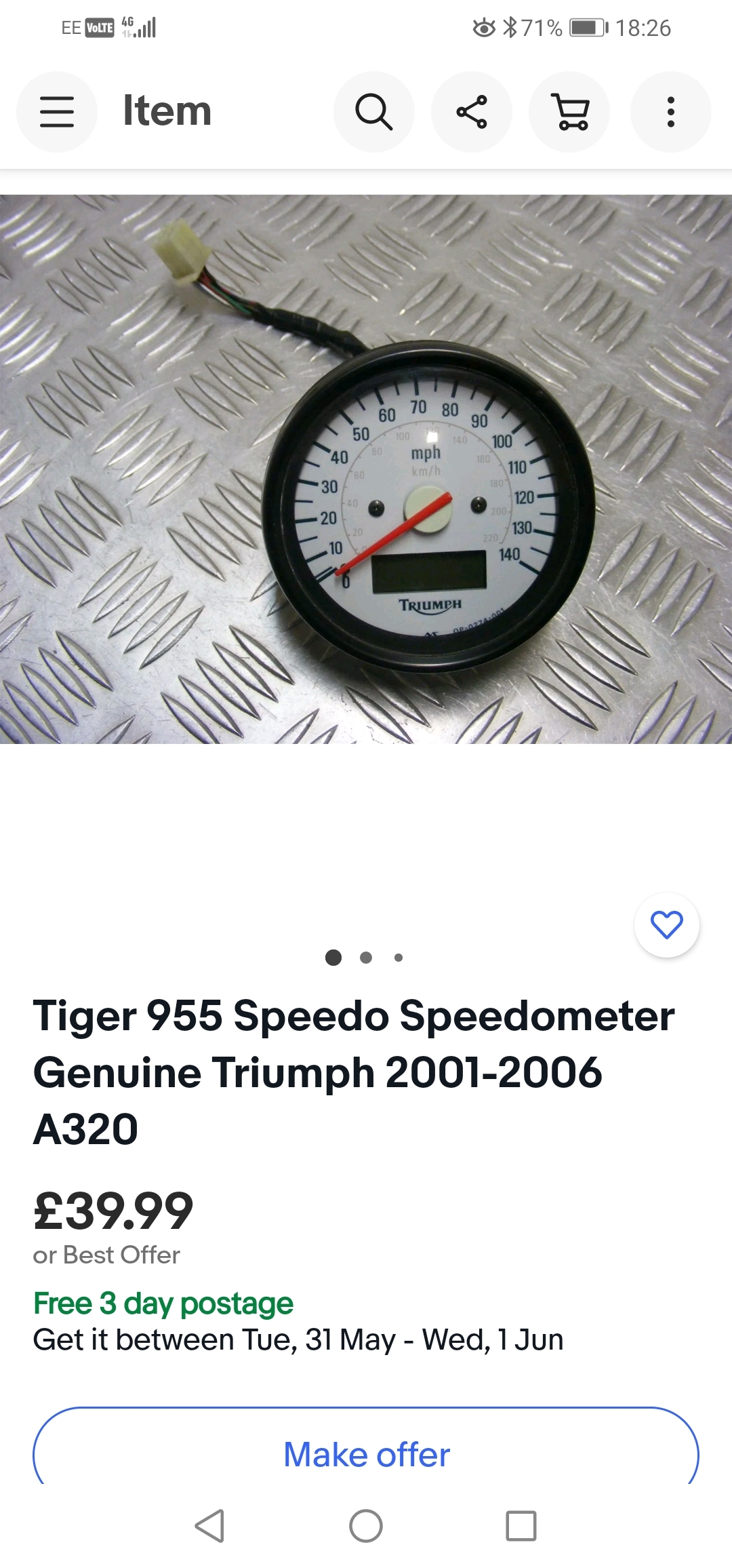

  17. Iron
    Iron Elite Member
    Dec 29, 2021
    2,571
    943
    Bob Ross Studios
    Doesn't look good. There's one on fleasbye
