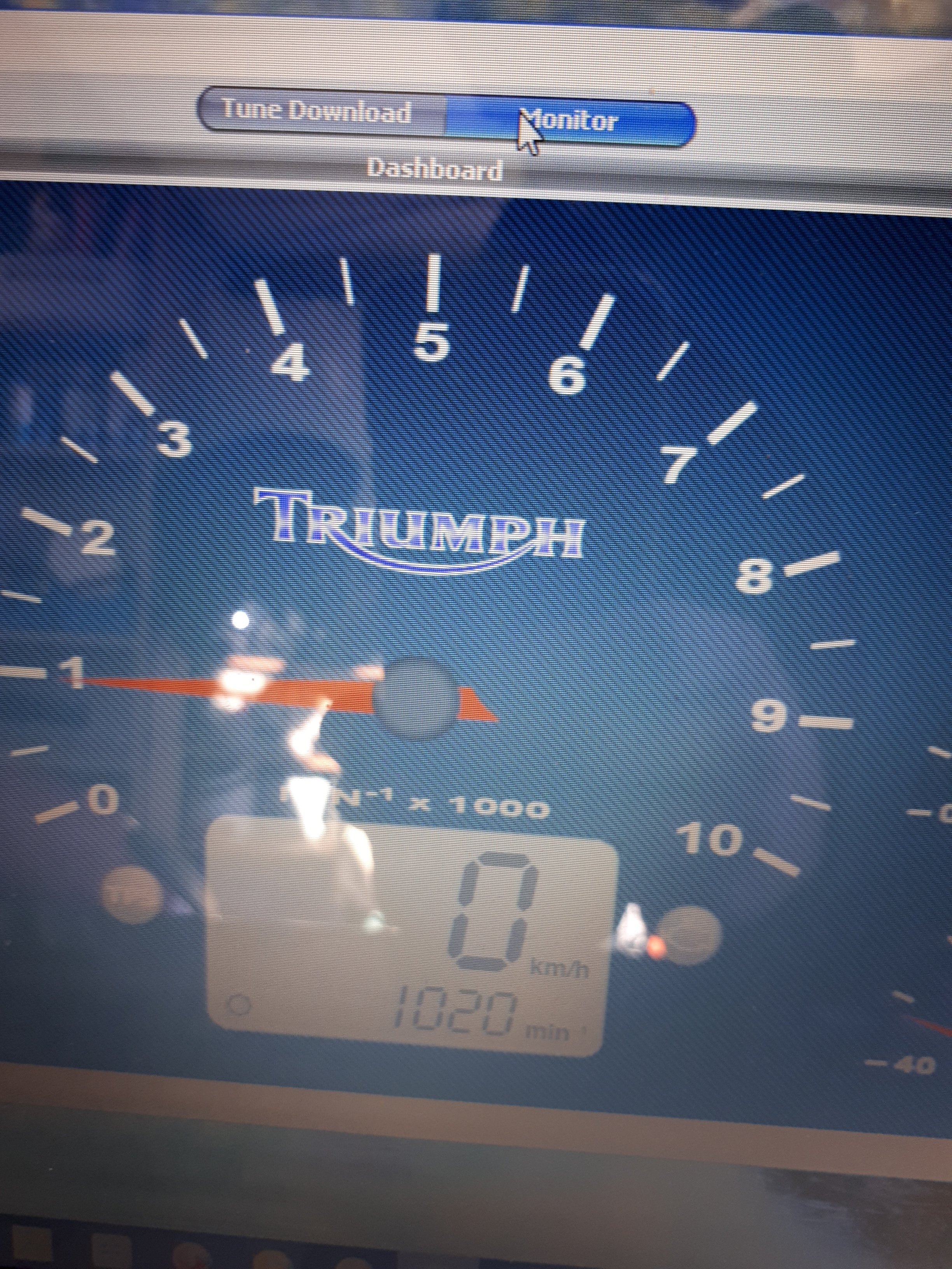

  4. steve lovatt
    9,211
    A laptop, Tune ECU, a cable and away you go! :cool:
    You can see them balanced in the second picture.

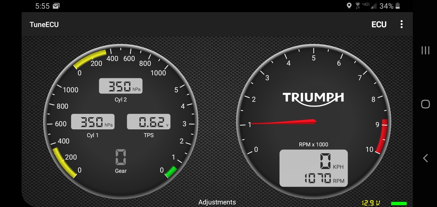

  8. Guillermo salinas
    Guillermo salinas Well-Known Member
    Aug 17, 2019
    161
    Azusa
    I have my throttle bodies synced at 350 and not 360, is that okay? Also all the other testing features that tune ECU fail everytime. What else can I do with these OBD2 controllers?
  9. thebiglad
    5,064
    Yes it'll be OK, the most important thing is that both cylinders are, as near as possible, identical.

  14. Kinjane
    Kinjane Active Member
    Oct 15, 2017
    233
    Bristol, Land of Enger
    Your screen shot shows the ADJUSTMENT screen.
    Can you not access the DASHBOARD screen by swiping right (and then right again for the fuel and ignition tables) ?
    An other option might be Dealer Tool - but that's also windows PC based or as suggested seek expert advice on the TuneECU forum.
