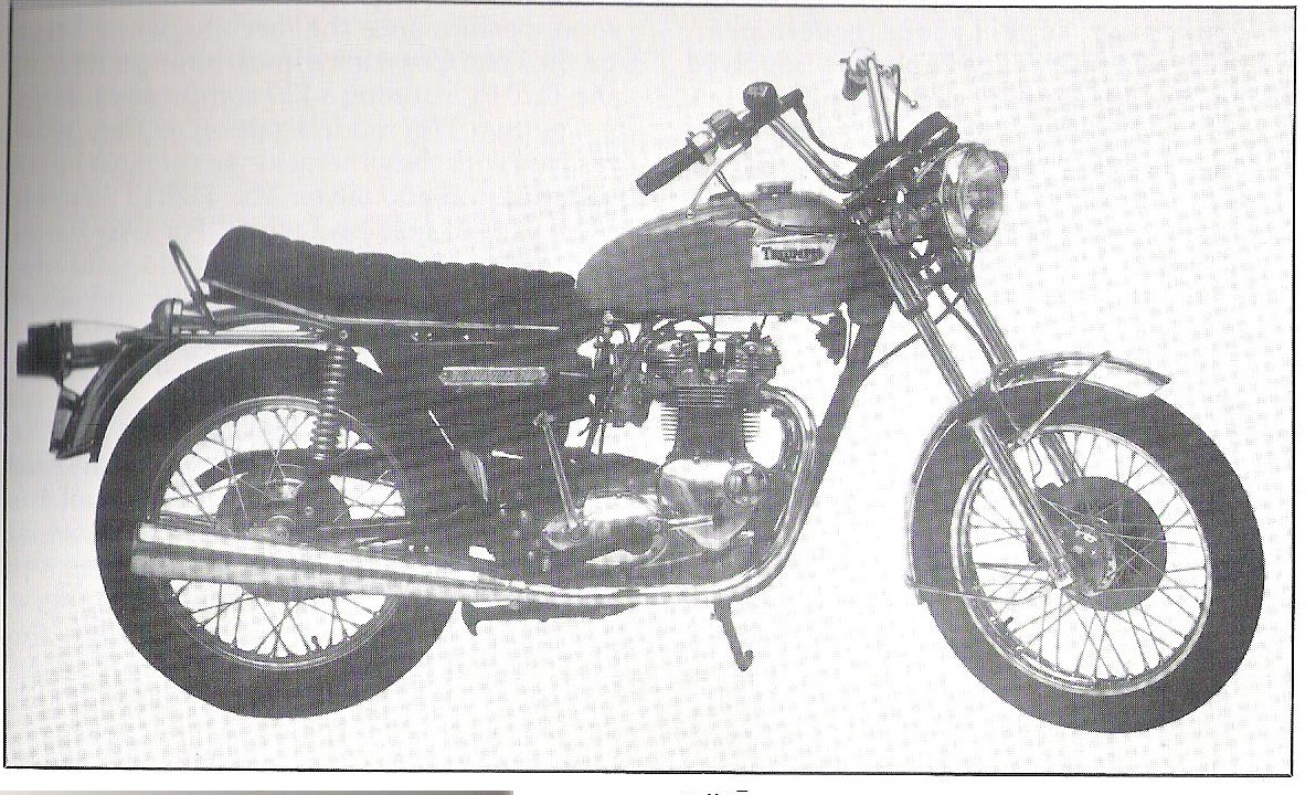

    This is a (not so good) picture of a standard 1973 T140 with US specs.
    The most obvious déviations of your project bike are the drum front brake, the lack of indicators and grab bar and the mufflers.
    I also think that the exhaust pipes and the raised bars are not the correct items.
    The gear charge lever on the right is correct. It went to the left in 1976.
    Good luck
    Bruno
