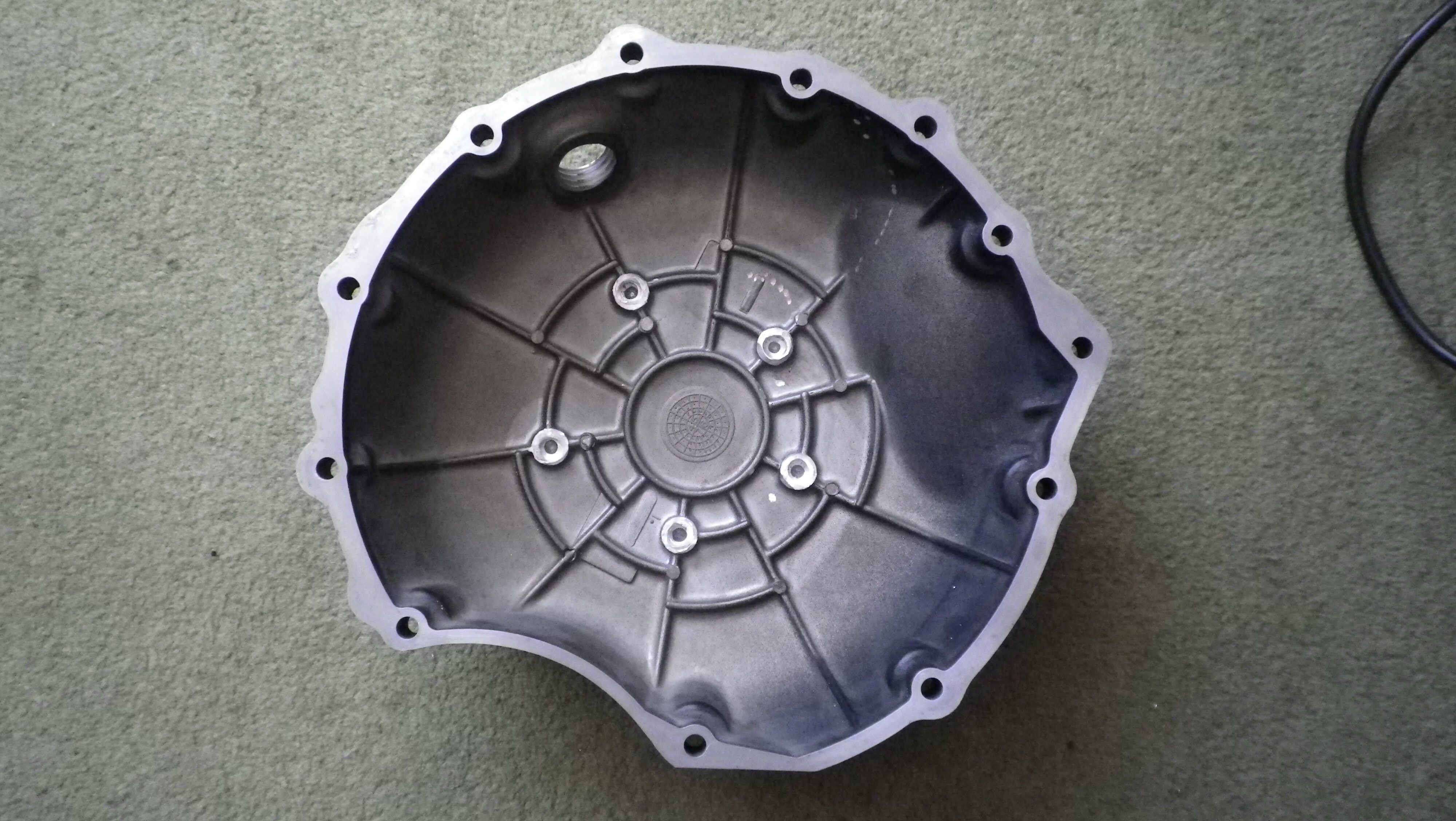

    Took clutch cover of to look check plate thickness etc while bike is being worked on. Decided to see what was behind metal plate, just sound deadening foam. Tried to bolt it back on and torqueing to right setting it chewed thread. So decided to see what difference it makes without plate and foam. My idea is to shorten mounts for plate and then button weld them with Durafix welding rods and propane gas. never done this before so should be interesting to see what happens. managed to buy another clutch housing off e-bay just in case. be a few days before get bits and pieces but looking forward to seeing if it works. Note to self ` Stop being nosey and it will cause less damage :) and yes I am aware I have too much time on my hands.

    Same here but thought would give a try. I`ve got to make undertray, oil catch tank and radiator overflow so fingers crossed it works and can make these myself. This whole project is about learning to do new things. Will upload pics once have given it ago. should have all parts to do it with in next week or so

    These are not welding rods:confused:
    They act more like a strong glue :)
    Bit like aluminium solder if you like :)
    Have used them at work on cracked engine cases to good effect :cool:
    But don’t be tempted to use it on heavily stressed parts like frames or ladders etc :(

    Very true they say they solder not weld. Should be Ok to button fill the mounts inside clutch cover and make undertray. Love to be able to afford AC/DC tig welder, did a course years ago at college, but very expensive. Be nice though one day to get a set, I enjoyed the process, found it quite calming :)
