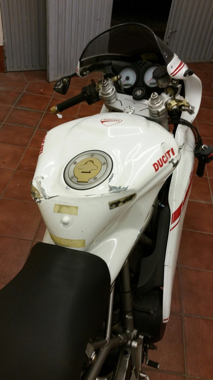

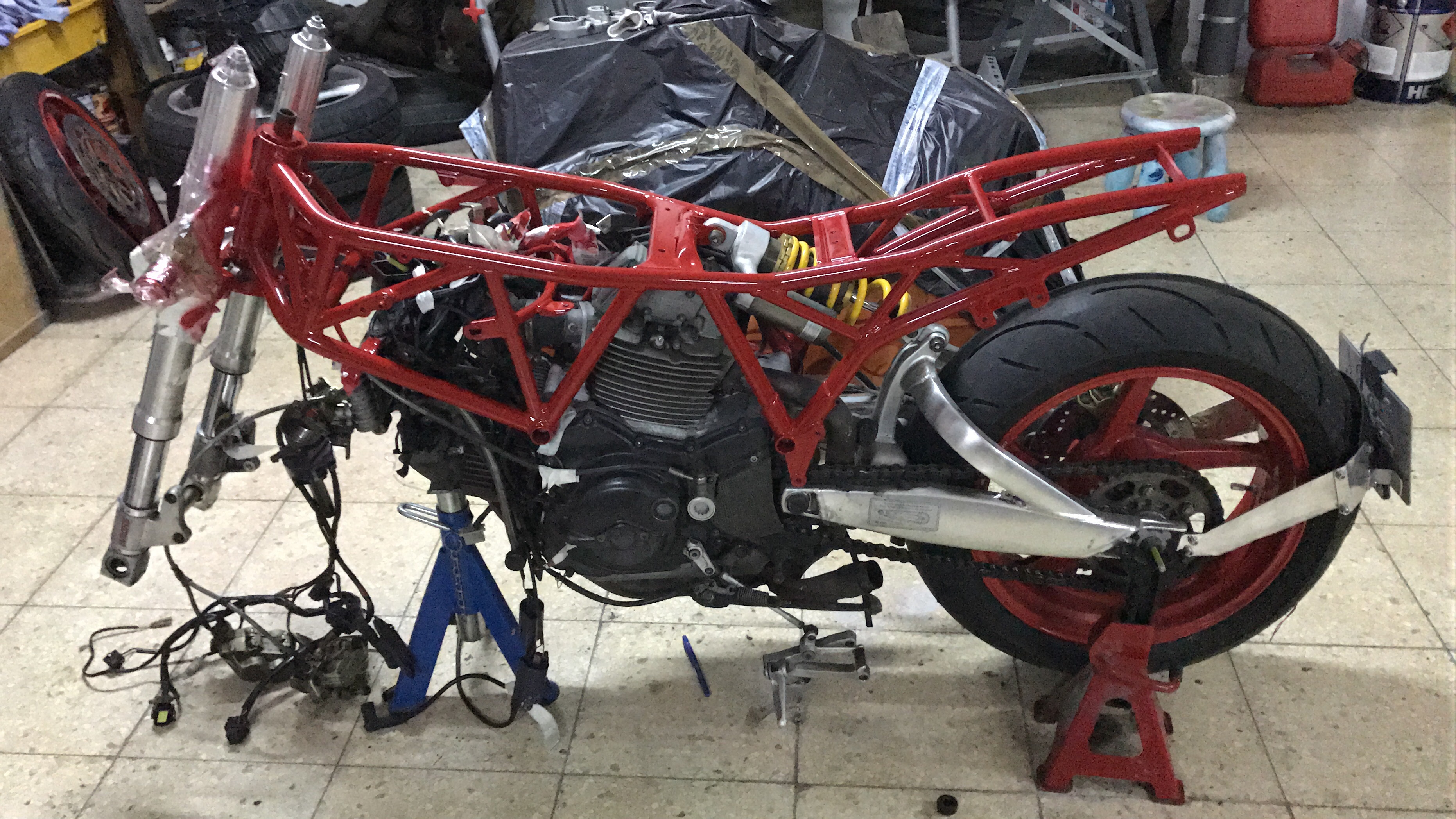

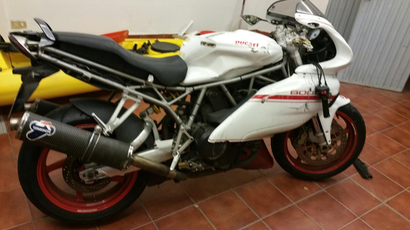

    17D129A9-EECE-4530-ADA3-2E6964ABC6C1.jpeg CAABF0E0-18BE-4986-915E-52C7FAC1F769.jpeg E50D49E2-8207-4C20-8C22-DED0E92BF887.jpeg E4A77900-FC03-465A-A571-38D8BB651B3B.jpeg D959EB16-1FA8-4702-A1B5-0624D4169629.jpeg A0DBA6CA-7757-4AF2-BD38-4D712DDB118D.jpeg 116223FC-27DC-4519-943D-AD0C03CFE36E.jpeg This bike was from a young lad who fall of after just a week after he brought it.
    He smashed the fuel tank,damaged plastic all around and broke some minor parts.
    He ask me if I could fix it cheap as he didn’t have much cash at the moment, I felt sorry for him and how his bikers experience had begun so I accepted asking him if it was ok if I built a cafe racer with his bike, After looking at Google what this was he gave me a ok to do what I had in my mind!

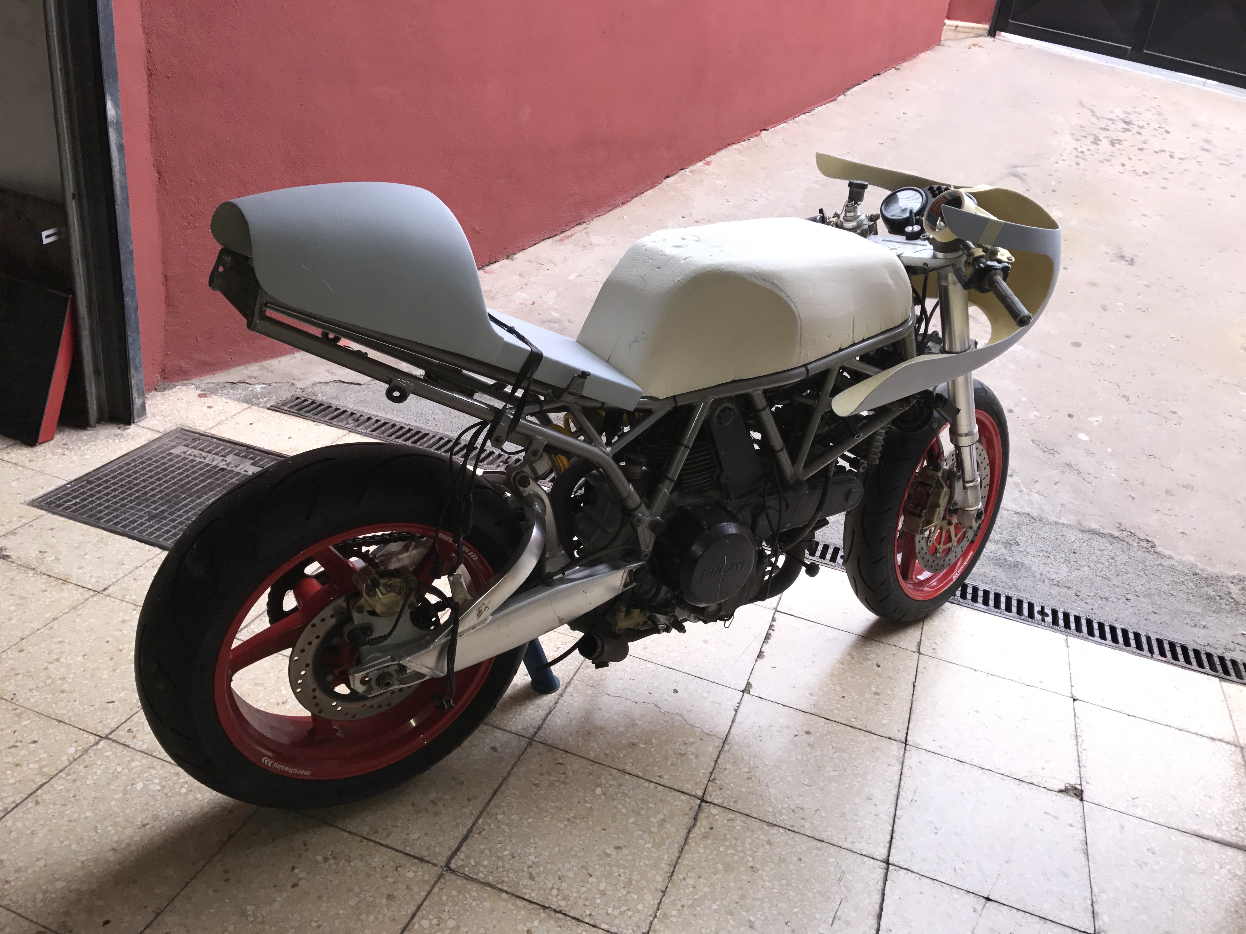

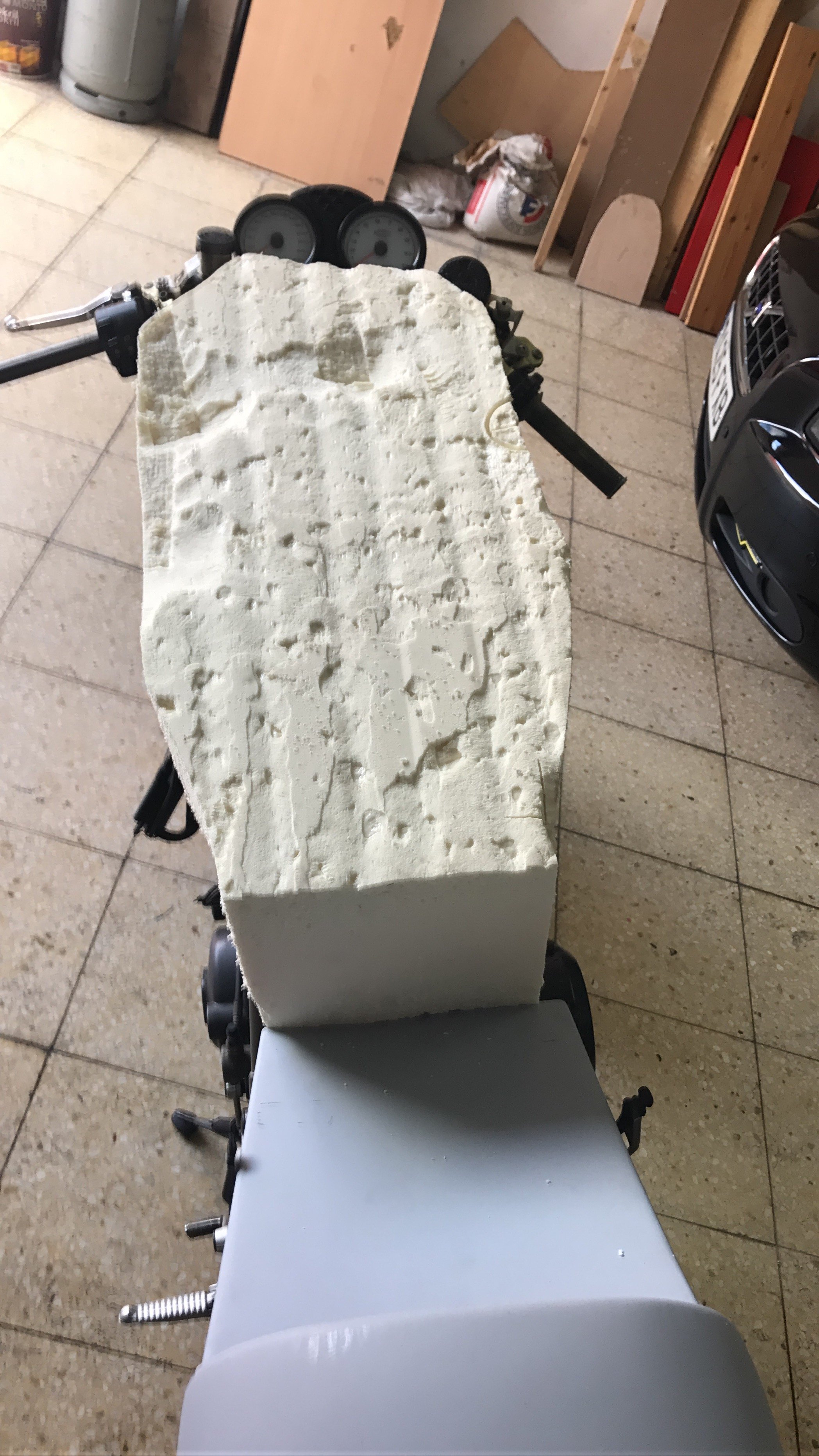

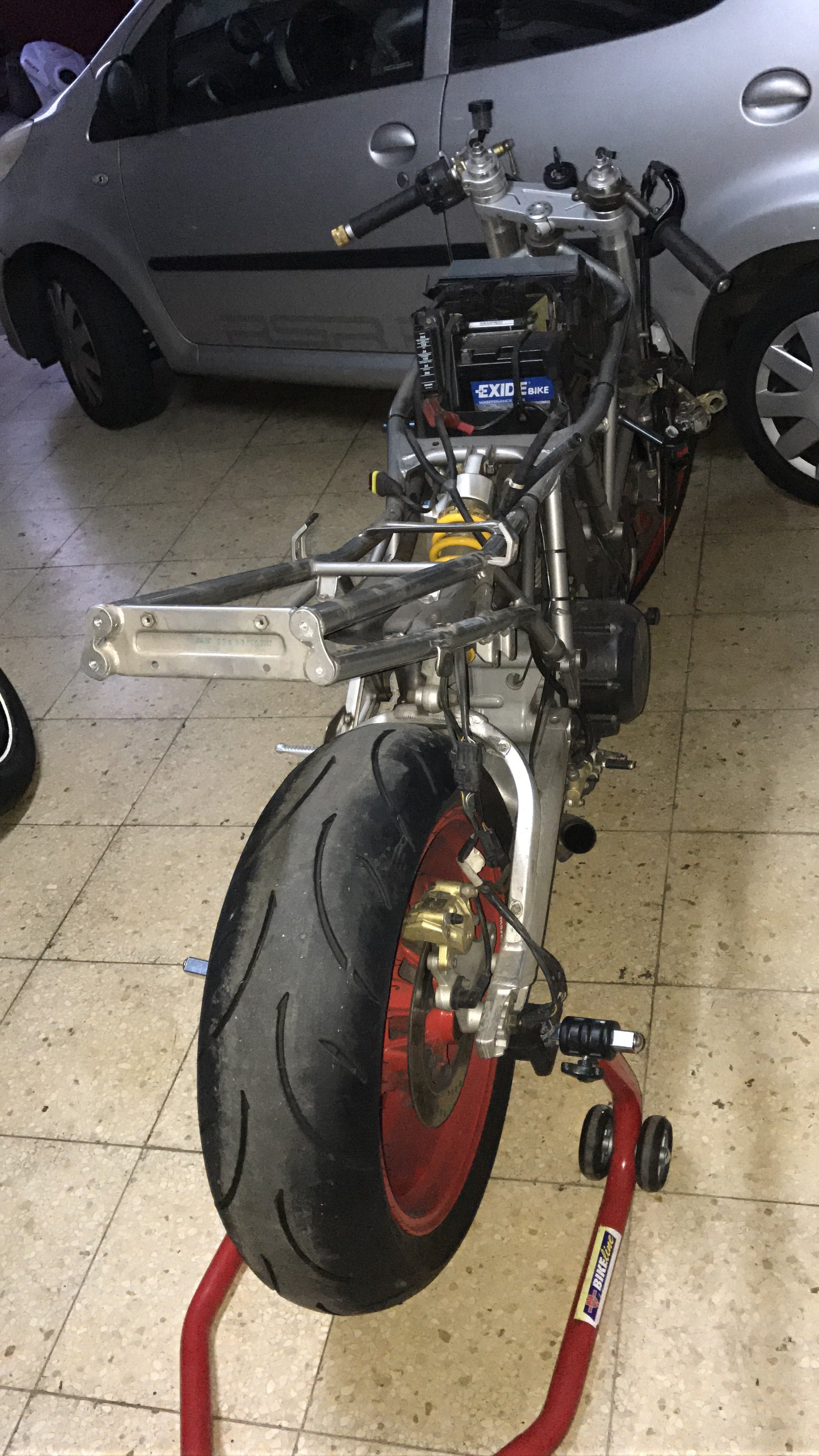

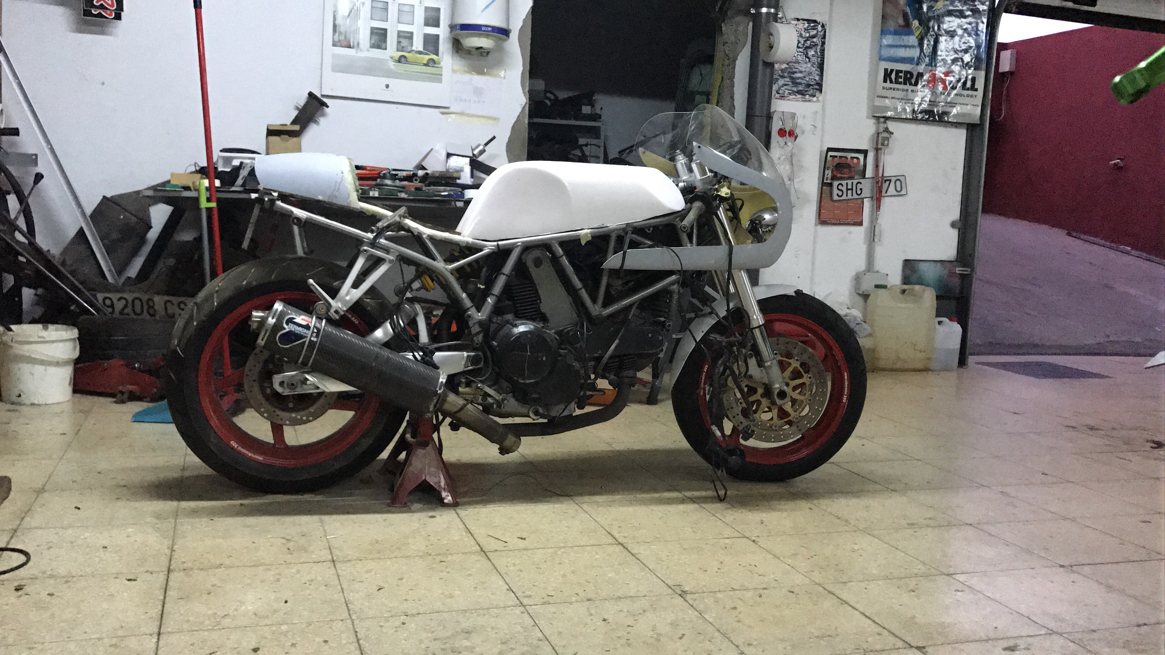

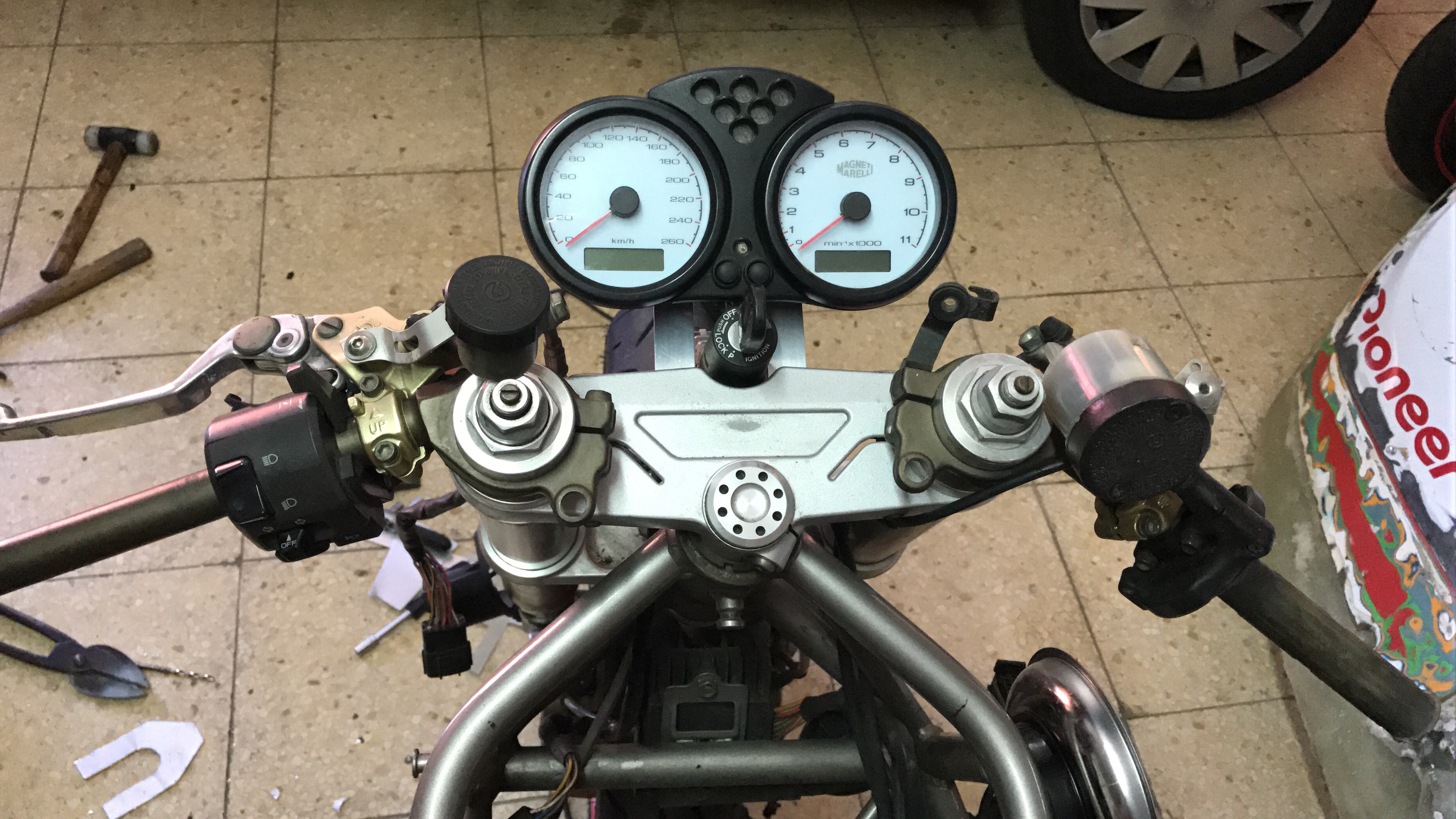

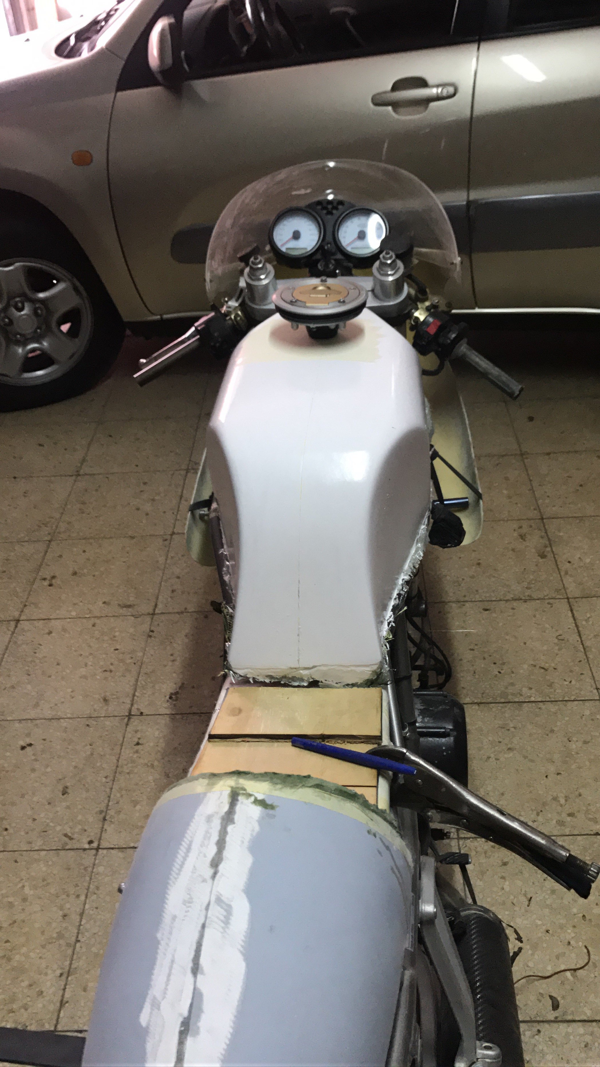

    next step was taking away not needed parts.
    I made some new instrument support and begun playing with the new fuel tank design
    8097CEB5-3B86-46BA-8C0A-CD16693297CB.jpeg 7179ACE7-F974-4ED4-928C-512FA87B29DD.jpeg 41CFFFB4-4326-4588-B36A-78AF110AE213.jpeg F7923A5F-7FA3-4E69-A0D5-C04B5F30CC19.jpeg DB5F61D5-A5F5-48FC-8036-739DB20A0271.jpeg
  3. Hubaxe
    Mar 25, 2020
    1,718
    Aix Les bains - French Alps

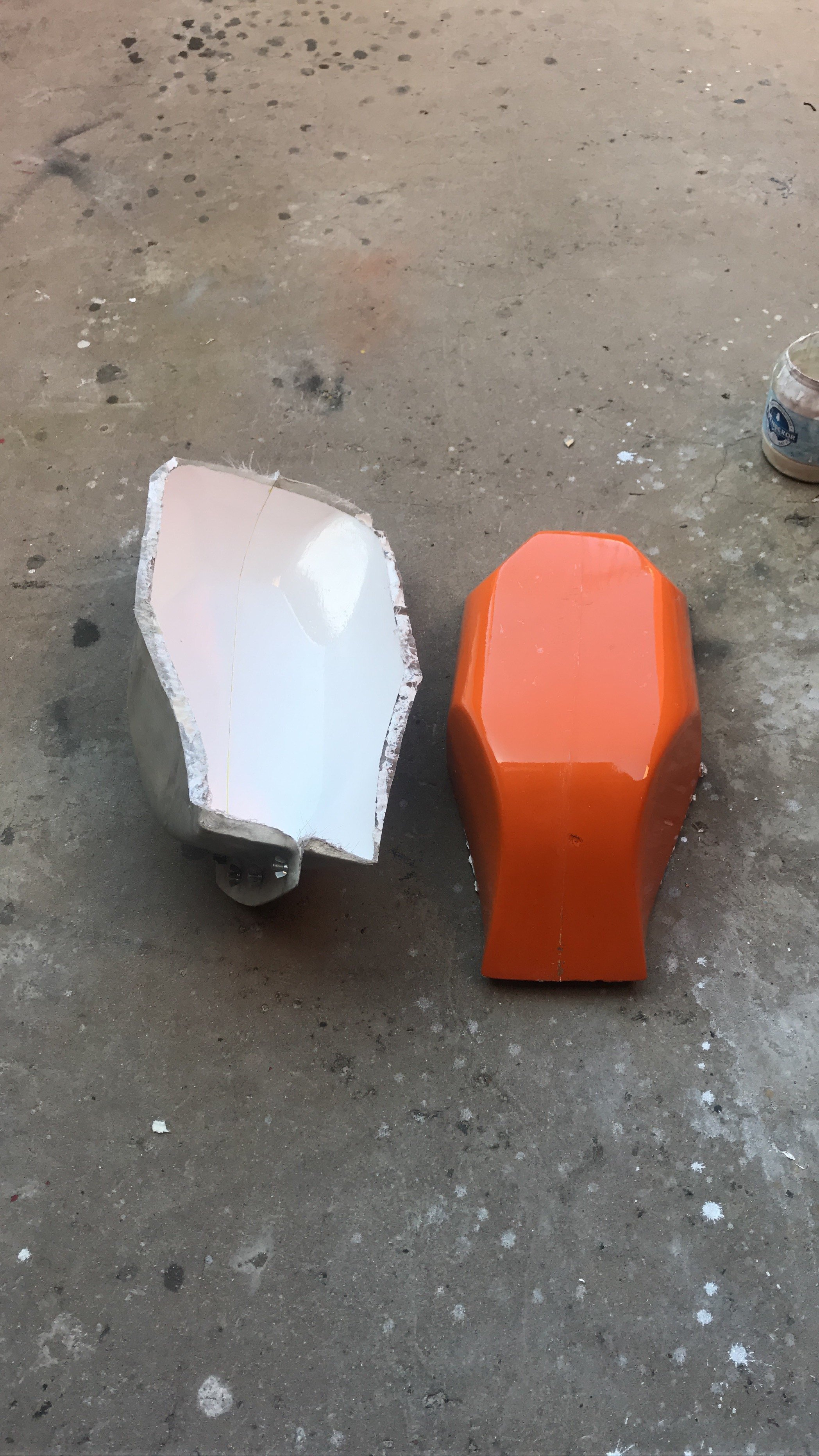

    Fiber glass molding?
  4. El Vikingo Tropical
    El Vikingo Tropical Noble Member
    Jan 17, 2021
    884
    343
    Gran Canaria, Spain

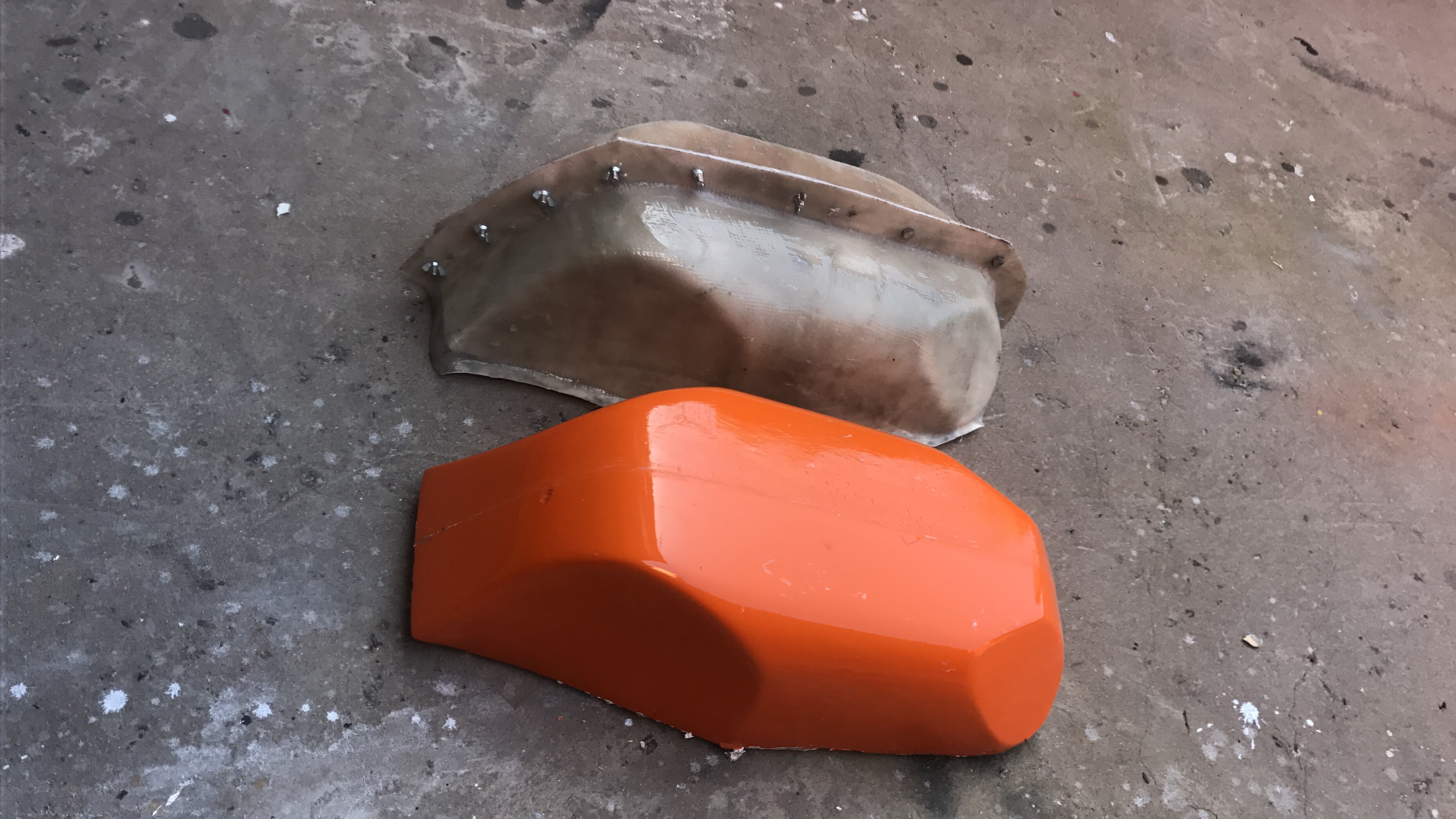

    Yes Sr
    In the following pics you see the positive mould (plugg) taking shape , finally I gave it a smooth surface and painted it orange.
    And ready it was to make the negative final mould

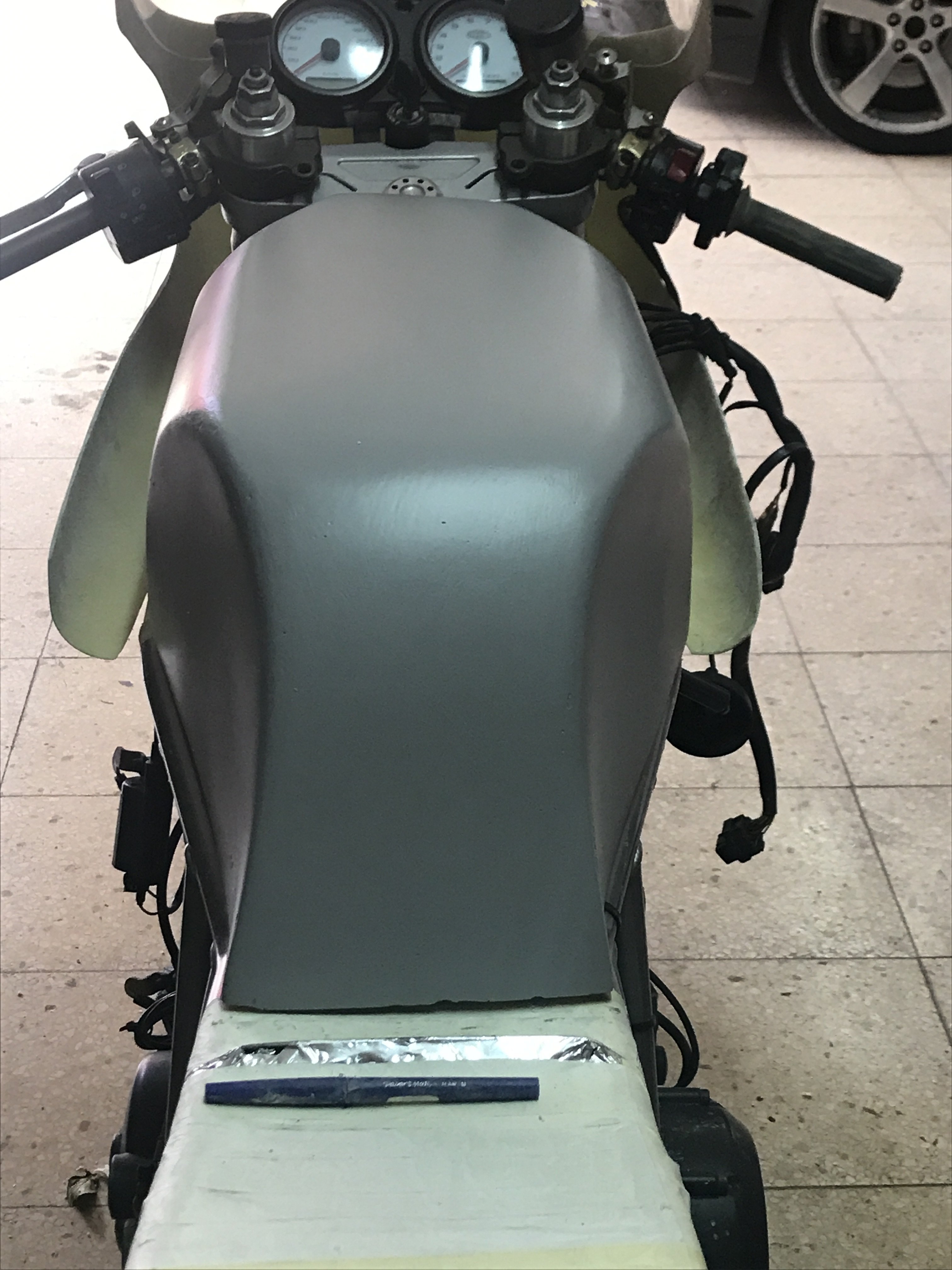

  16. El Vikingo Tropical
    Jan 17, 2021
    884
    343
    Gran Canaria, Spain
    B6F16900-47B3-4829-9F77-3B506FC242EC.jpeg 7CED3EB0-1FE4-4969-BA70-4F970FDD8786.jpeg 32723285-0274-457F-AD6B-CEBE87AFC23D.jpeg ECD9BCEB-32BA-46D3-A6DC-B78832F4071E.jpeg 2C2148DC-1E7C-4A49-BAD7-A84BA4F89F62.jpeg 8399FB68-AE39-4FA9-B460-2B4796FAA12C.jpeg E60FA70F-80EF-4E07-9737-F0CAAEA8294F.jpeg 6A4035DF-331E-4B31-9F55-E259CCC63486.jpeg 92773A24-E3B7-4831-AE43-81B831A02E93.jpeg A628E354-2391-48CE-9545-4EEFBA876839.jpeg
  17. Hubaxe
    Mar 25, 2020
    1,718
    That new tank you did is awesome.

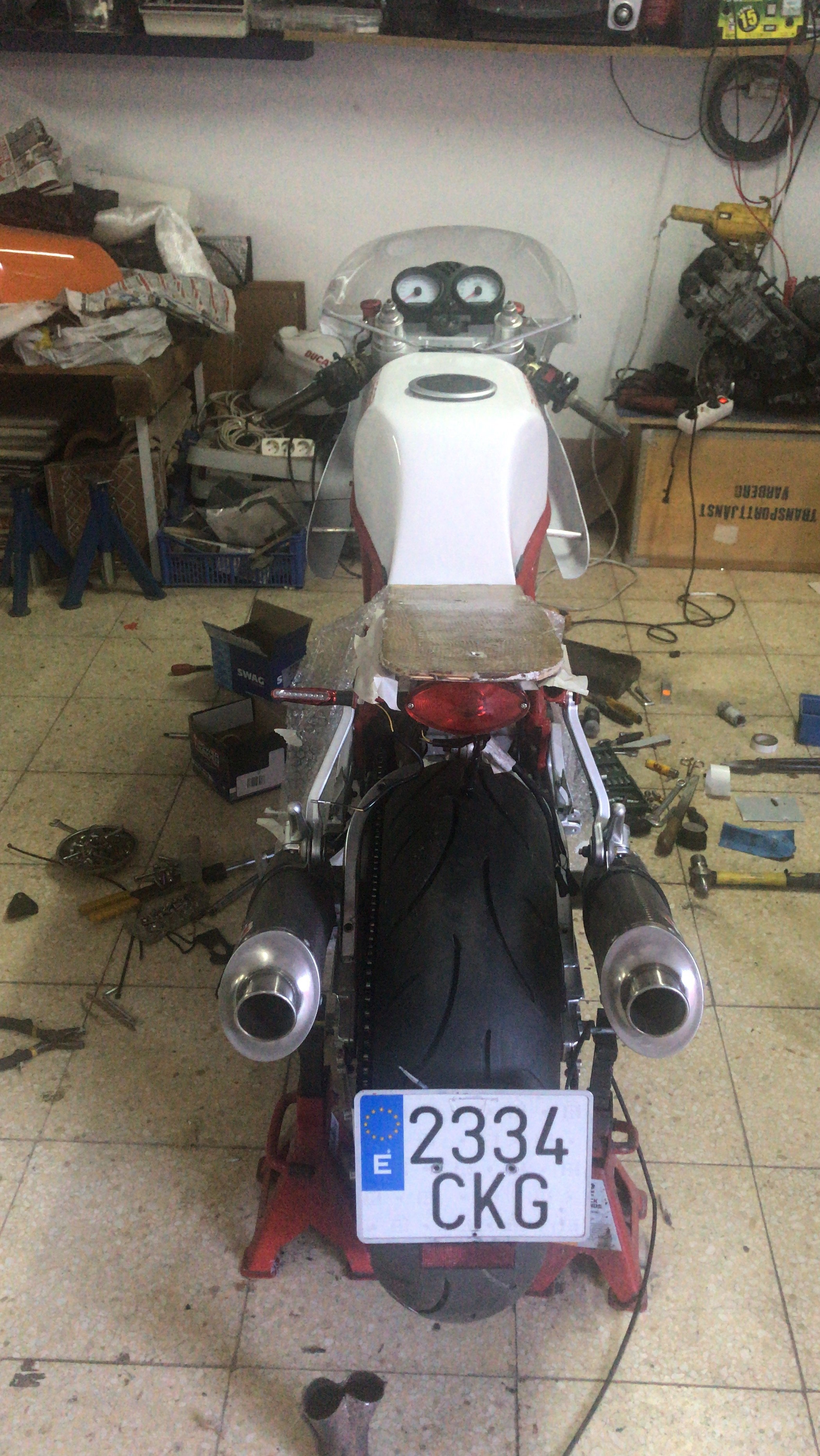

  19. El Vikingo Tropical
    Jan 17, 2021
    884
    343
    Gran Canaria, Spain
    No streaming here...

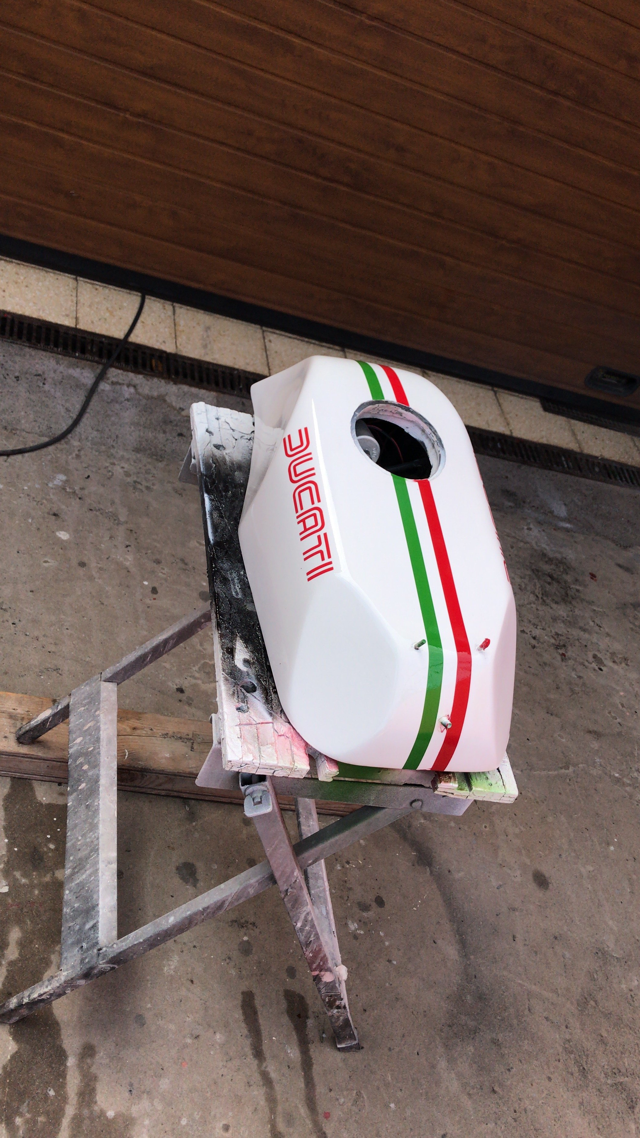

    Bike is done and the young fellow is enjoying it
