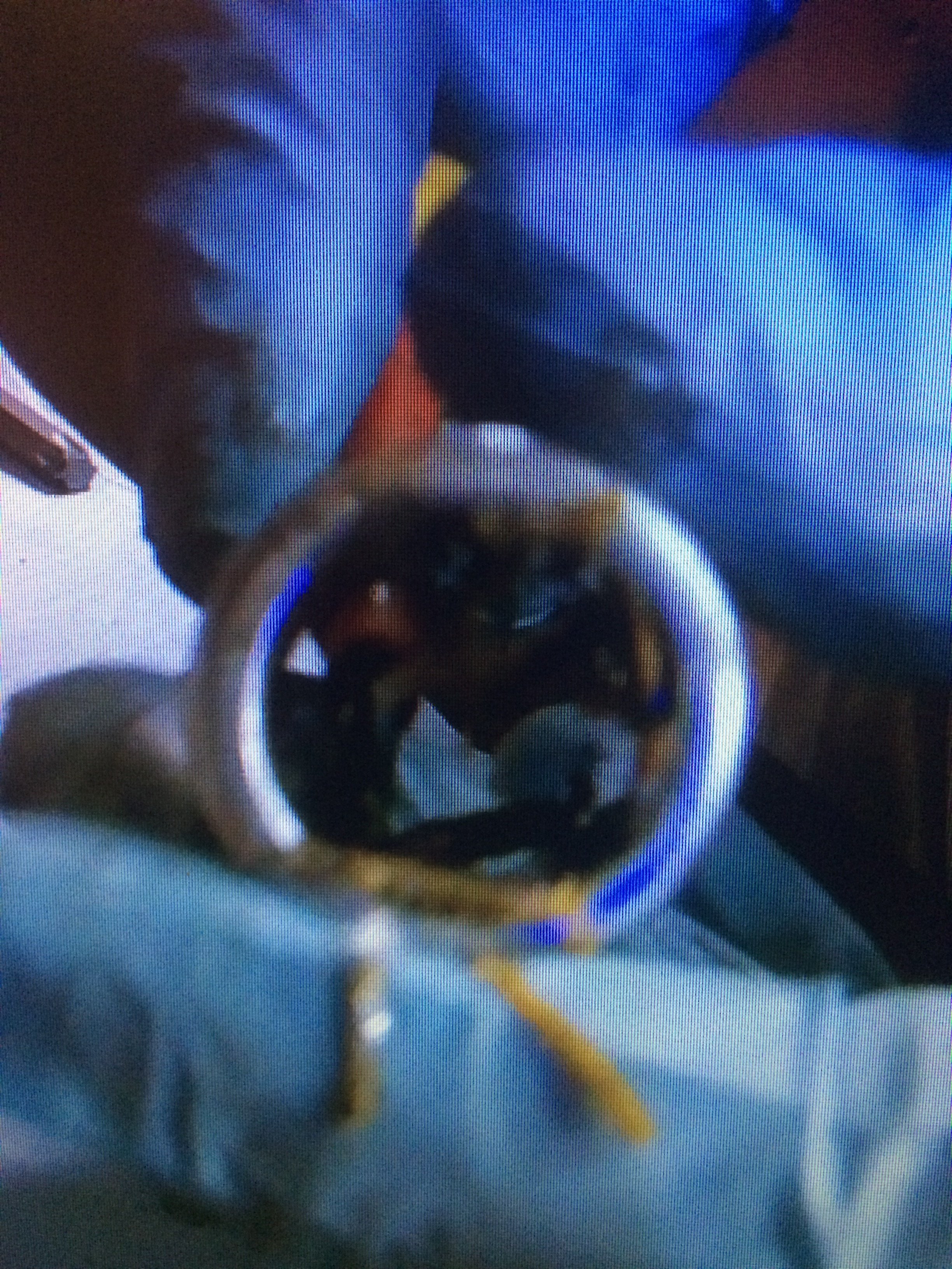

    Hi, I recently inspected my 2016 speed triple's rear suspension bearings.
    I found them to be quite dry, containing a dry wax like substance? Nothing like I expected them to be.
    Movement didn't seam as free as I would have thought it should be, that said its only a pivot.
    So only has a small movement.
    The bearing cage, which I would have thought would be metal/plastic, was kind of similar to the wax... a wax cord/fibre material.
    Anyone see this kinda thing before.

    Did you take any pics while it was apart? That sounds a bit strange. I did mine last year (2015 bike) and although the bearings and seals were ok there was bugger all grease in there. Yes the linkage only has a small amount of movement but it’s under a fair bit of strain and needs grease to prevent wear and early failure.

    I'll see if I can find a picture

    Pics aren’t really clear but I get the idea. What have you done with it? Looks like your best bet would be to change them, could you trust them to be ok even cleaned up and greased?

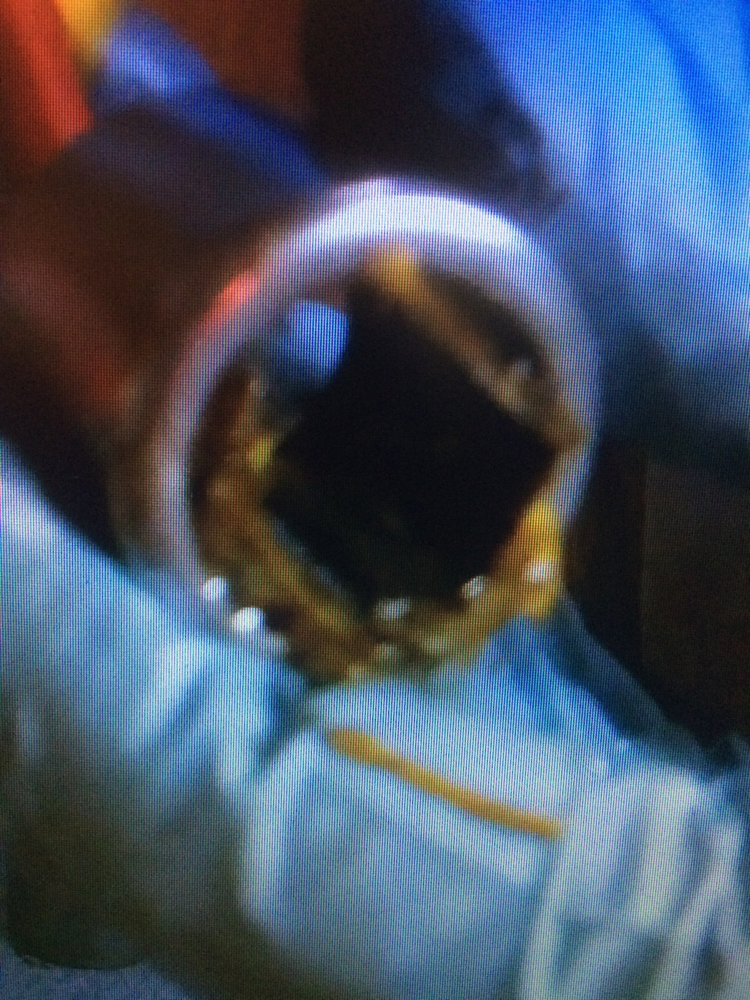

    What you can see in the picture is flakes of what appear to be wax, the bearing race is made of similar.
    It almost looks like the race is the lubricant?
    Curiosity got the better of me, so I heated the bearing.
    Which released the needles, and revealed the race, which the needles were imbedded in.
    I took this material out, and replaced it with normal grease.
    This was about six months ago, and the bike hasn't ridden any differently.
    Just wondering what this material is, think I'll strip it down again. Just to see if all is good.

    This is more typical
