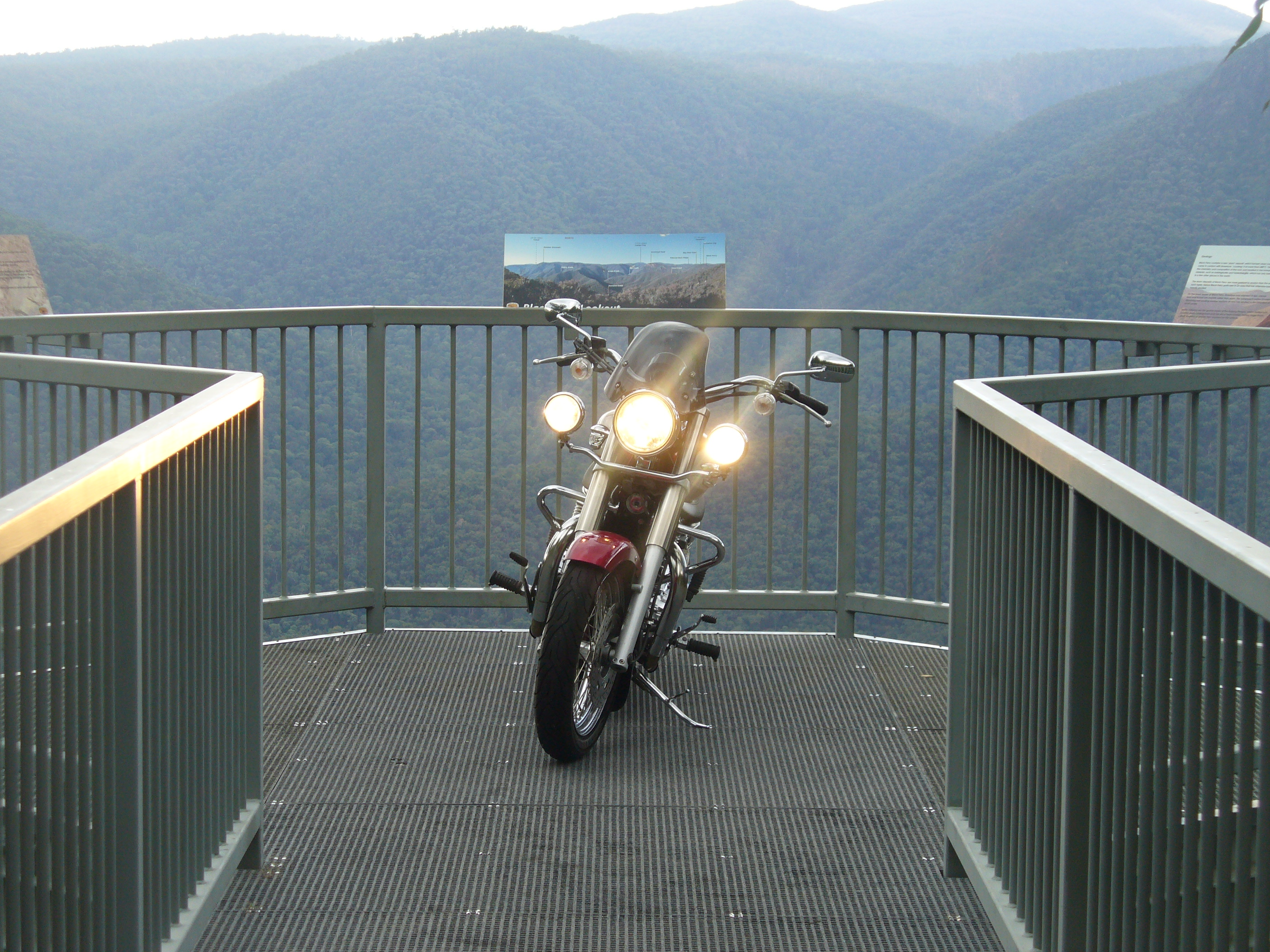

  3. Aussieamerica
    Aussieamerica Well-Known Member
    May 12, 2016
    45
    East coast Australia
    I just recently picked up a second hand light bar and spotlights, long story short the plug in Triumph loom let me down so I rewired a separate wiring circuit through a new relay and still had an intermittent problem. Thankfully I got the heads up from a Speedie rider who had similar problem, it was a faulty toggle switch on the left hand spotlight. All sorted now and they make a huge difference at night and in daytime wet weather they make me a lot more visible on the highway. 002.JPG P1140512.JPG
