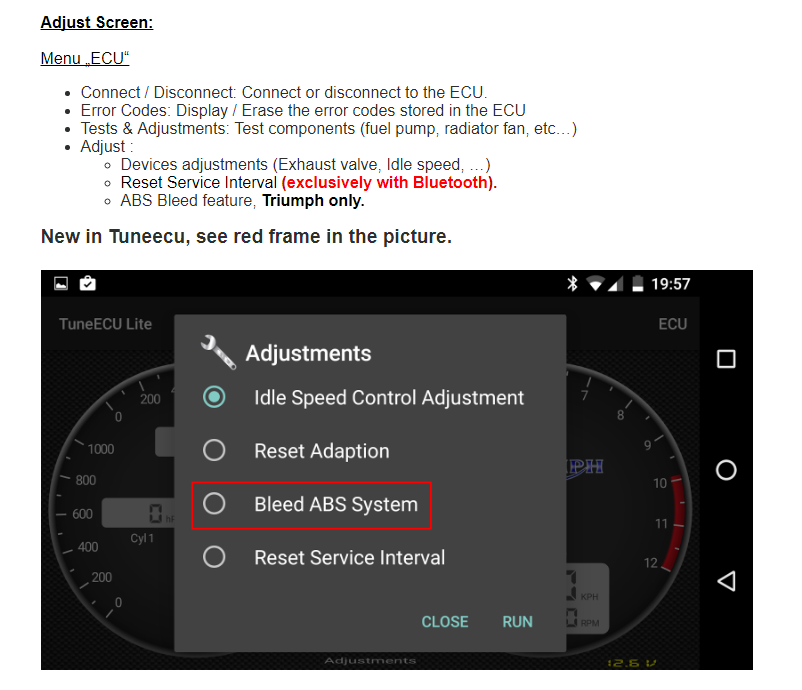

    Can you switch off/reset service light with this?Speed Triple 94 2015
  8. capt
    capt Elite Member
    May 8, 2016
    3,051
    western Australia
    Ye you should be able to. Unless there is a fault which needs a part changing or adjusting.

    @Sventhrusta
    Haven't checked latest updates but unless things have changed you can't switch off the service nag with the pc version connected via cable. But you can with the Android version loaded to a smart phone and connected via bluetooth.
