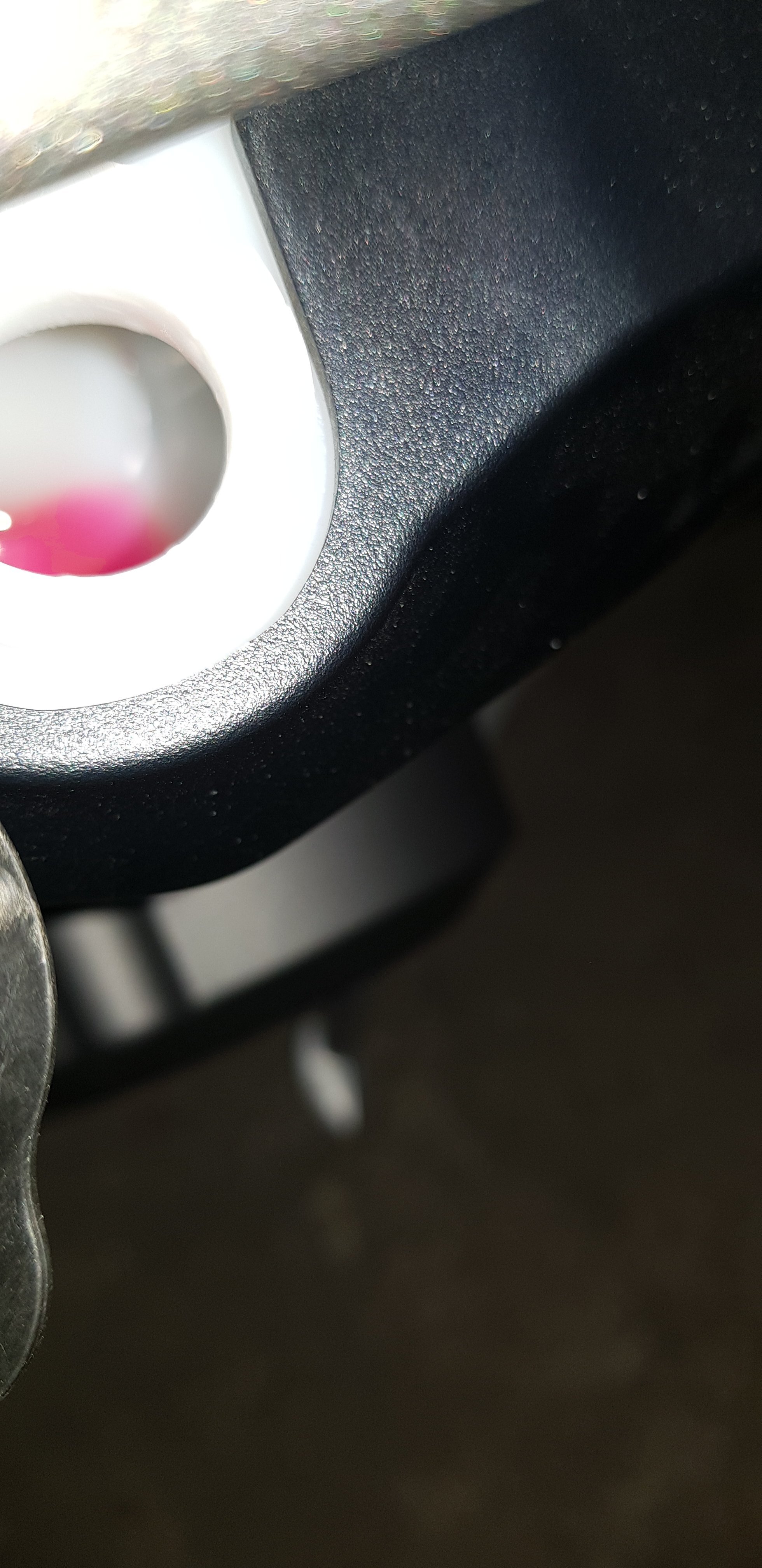

  1. Good afternoon mates! I have a question, the expansion bottle of my new Triumph street triple rs is almost empty (rare) and I would like to refill the bottle but I see that it is almost impossible to buy Triumph antifreeze liquid ... so I remembered that I have another one in my garage Liquid that I used in my previous motorcycles, which is Petronas paraflu up for direct use https://www.ebay.co.uk/itm/124663089721?epid=9047192896&hash=item1d067fca39:g:y~UAAOSw3ZFf1iOM , but I'm not sure if it is good to mix it with that of the motorcycle. In my previous motorcycles this antifreeze has worked great for me, to the point of lowering the engine temperature by 4 degrees compared to other antifreezes.
    Do you think there will be no problem to replace the motorcycle with this antifreeze?

  3. Sorry for not putting the right link but I looked for one in English and they all come out in Spanish.
    The coolant is oat and the color of the coolant is the same as the one on the bike (pink)
    What color is the original Triumph coolant? I can easily believe that they have put me another non-original in the dealership ‍♂️
