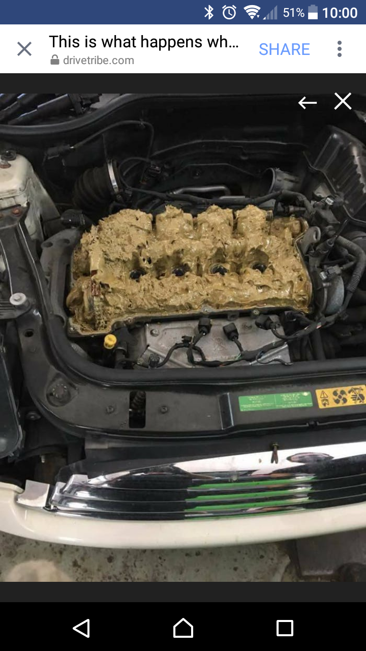

    5 litre of screen wash poured into oil-filler, then driven for 10 minutes. Not good for your engine!!! :dizzy::p:laughing:

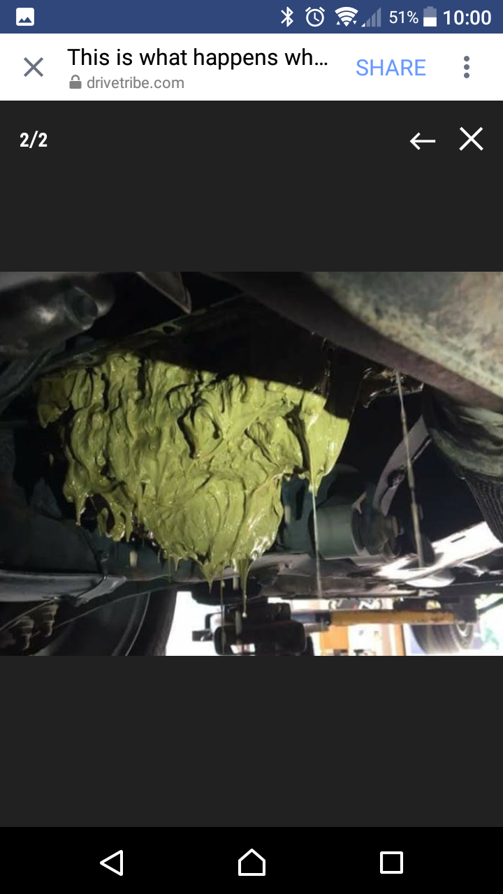

    The second picture is the view of the sump removed.

    Oil and water form an emulation, because they can't properly mix. Just like when cylinder head gasket goes, and oil and water mix to get that buttery sludge in the filler cap, but 5l of detergent is going to do a lot more!!!
  3. MrOrange
    As long as it wasn't run long enough to feck the bearings. Plus getting all the oil ways clean of sludge would not be easy.

    You wouldn't believe screen wash no matter how undiluted could do that.
    Have they scrapped the engine or do they intend cleaning it ?
    It is certainly a job that I wouldn't fancy.
    Oilways, waterways, bearings, valves, chains, piping, what a mess!
    Unless it was some special engine I would scrap it.
