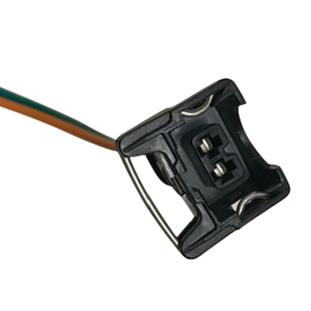

    This is the connector that goes onto the evap valve, I am looking for a way to buy an identical connector, but then the male side of it, to make my own valve eliminator.
    If I find the right connector, I will also post how to make the valve eliminator, but first things first: find the connector I need.
    So anyone of you tech people: can you tell me what type of connector this is??

    Usually these connectors have a small brand name on them somewhere, would at least give you somewhere to start your search. Molex sounds familiar but I could be mixed up with something else (happens quite a lot) :rolleyes:

    After a google, it looks like a bosch EV1 injector connector

    Its a Tyco connector, part no 106462-1.
    I've ordered it.
    I measured the resistance of the coil of the valve, it's 26.5 ohm. I don't know how the ECU checks to see if there is something connected to the end of the connector, but I hope it's not too fuzzy and it will stop complaining about a missing valve at much higher values than 26.5 ohm.

    The connector came in and I experimented with a bunch of 1Watt 300 Ohm resistors I had.
    It turns out, the ECU seems already satisfied with 3 resistors in series ( making a 900 Ohm load) on the solenoid connecter, so I settled for two of them in series, so they fit inside the connector where the wires were intended.
    A bit of black silicone sealed it all off.
    No fault codes so far. With the Evap canister removed I can now balance throttle bodies without removing anything at all!
