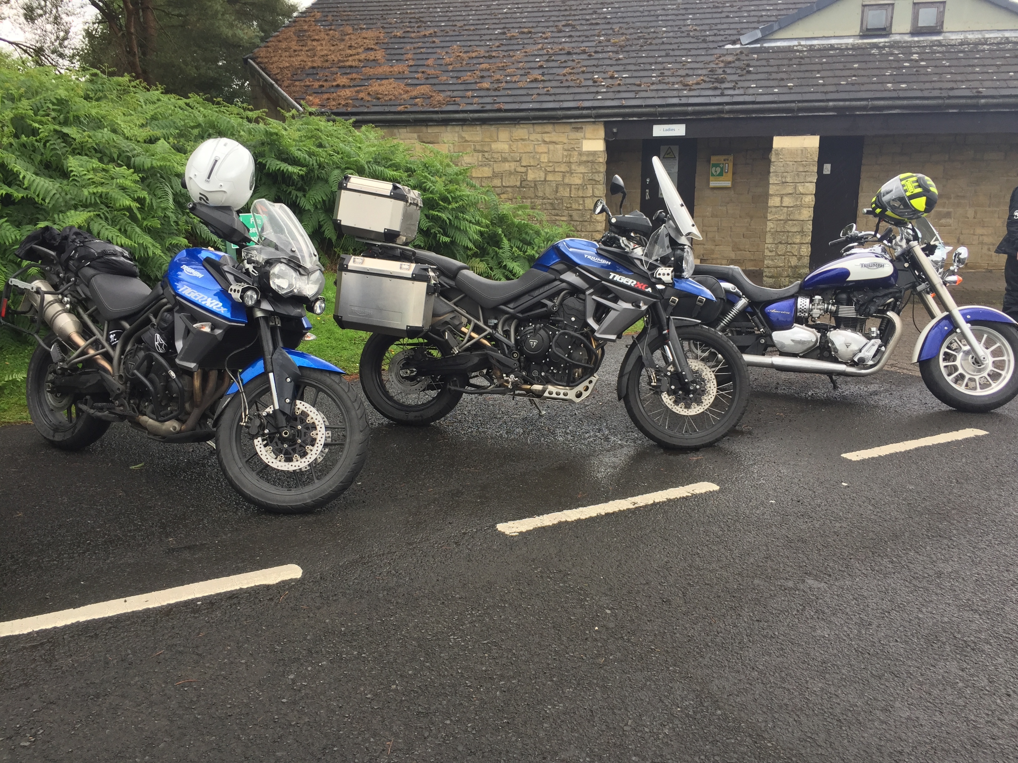

    Pic of Madstad if useful..

  18. figwold
    figwold First Class Member
    Dec 12, 2016
    634
    England
    Madstad in the middle
  19. Cyborgbot
    Thank you cliverdee and figwold for the photos.
    Out of interest do you look through or over the screen when riding? I’m wondering as being short, I might be able to hide entirely behind those screens - I assume they are adjustable so could be on a lower setting?
  20. figwold
    Dec 12, 2016
    634
    England
    I look over the screen. It’s a 20” screen and I’m 5ft 11
