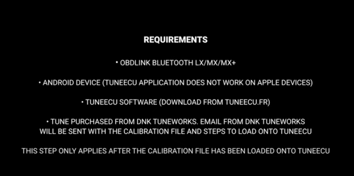

    During this whole process, I contacted DNK Tuneworks to enquirer about a tune file. I purchased one and was sent information about how to make use of it. The very first item on the list was a video on YouTube titled Triumph Liquid Cooled Tuning Guide. Here is a link to the video at the point where DNK Tuneworks specifically states that you need a LX/MX/MX+ OBDii dongle to use their product.
    Here is a screenshot.
    DNK LX:MX:MX+.png

    I really do not understand the company. The file they sent me is locked to my bike’s ViN so there is no way I can make any use of it. I’m surely not going to try to write it even with the “right” dongle given I have zero faith in the vendor. They say it is my fault for using the wrong dongle yet their own video says the dongle I used was acceptable. They tell me the use only this dongle is in their FAQs but, like I suspect with most people, I read FAQs when I have a question. I did not have a question about the dongle as their video already said I could use the one recommended on the TuneECU web site.
