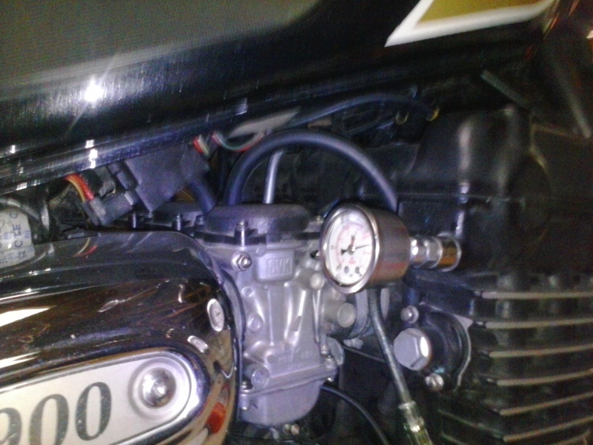

I just monitor pressure on my bikes. Most people do not even do that. I feel it is important to keep.an eye on it. Here is one oil pressure gauge setup. This one is on my Legend 900. ...J.D.
