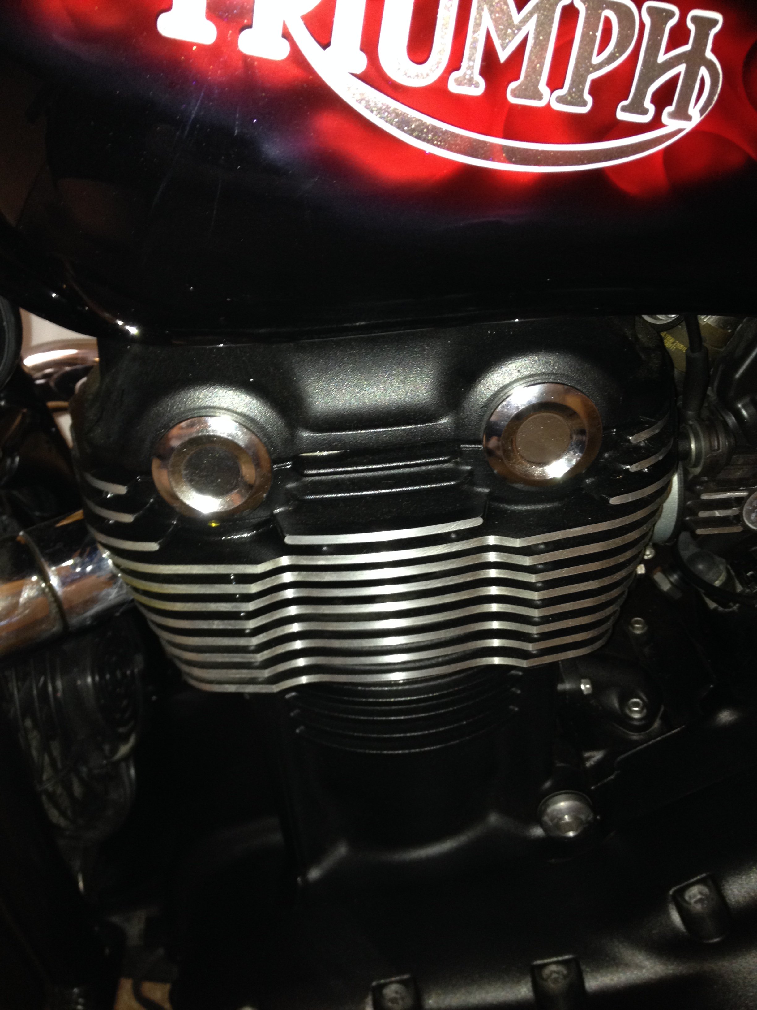

    I have a quick second question. Can replacements be bought of the round metal disc things (not the technical term!) that are on either side of the engine block near the rocker cover. The finish on one of mine is a bit peeled away (it's not on this picture). It's a minor cosmetic matter that I'd like to try and sort out in the near future if possible.
    Got to go now. Apparently cups of tea don't make themselves!
    Chris
