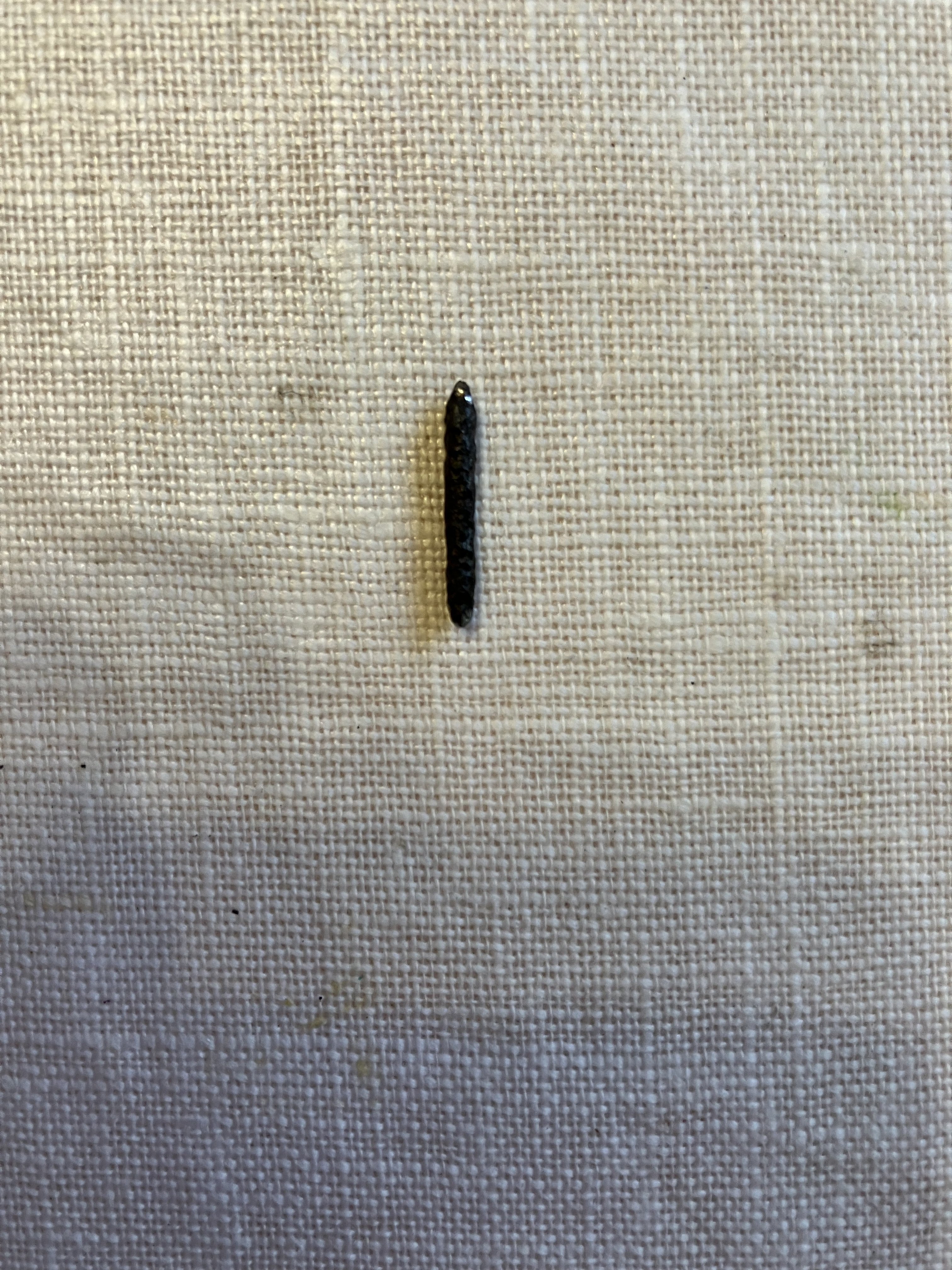

    Those of you who read my post on page 1013 of "What have you been doing with your triumph today?" will recall I found a tiny nail in the middle of my fairly new Avon Road Rider 2 rear tyre after a charity ride, which was the cause of a slow puncture.
    I have to intersperse two wheeled tasks with a busy work life. First was to clean the bike last week (boring) and then remove the wheel and take it to F and B Motorcycle Tyres in Wheelock to repair the puncture (about a 45 minute drive away which turned into 1hr because of road closures). Steve is an absolute gent, the nail see below was an absolute pain to get out.
    Only 2mm wide, it had gone in at an angle just deep enough to create a small leak, but not deep enough to come through the carcass. He couldn't push it in because of the angle and so had to grind just enough of the inside of the carcass away to get the tips of his pliers on the nail and push it back just enough to tug the nail out the way it went in. ~30 mins start to finish.
