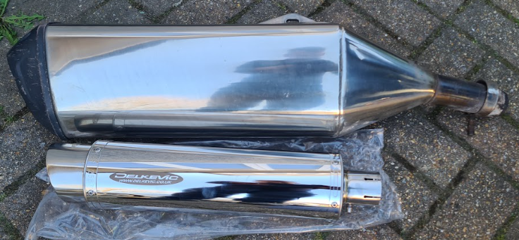

    Exhaust is on.
    Not a big job to fit.
    The Delkelvic kit comes with crush tube, decent clamps etc.
    The new muffler does not sound too loud at idle on the drive (baffle in).
    It is a lot smaller and lighter.

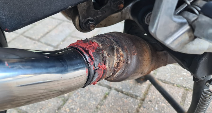

    I have struggled to get a good airtight seal, even though the kit came with a crush sealing tube that slid over the pipe. And a small tube of gasket sealer. I played around with the angles but I can still feel it blowing slightly.
    Im not sure how to sort this..?

    @Stu9000 Forget the sealer they send it is rubbish and ends up like the one you took of. Get some silicon sealant does not have to be a heat resistant one and rub it in around the can and on the downpipe and it works a treat and if for any reason you want to take the can of its made easier.
