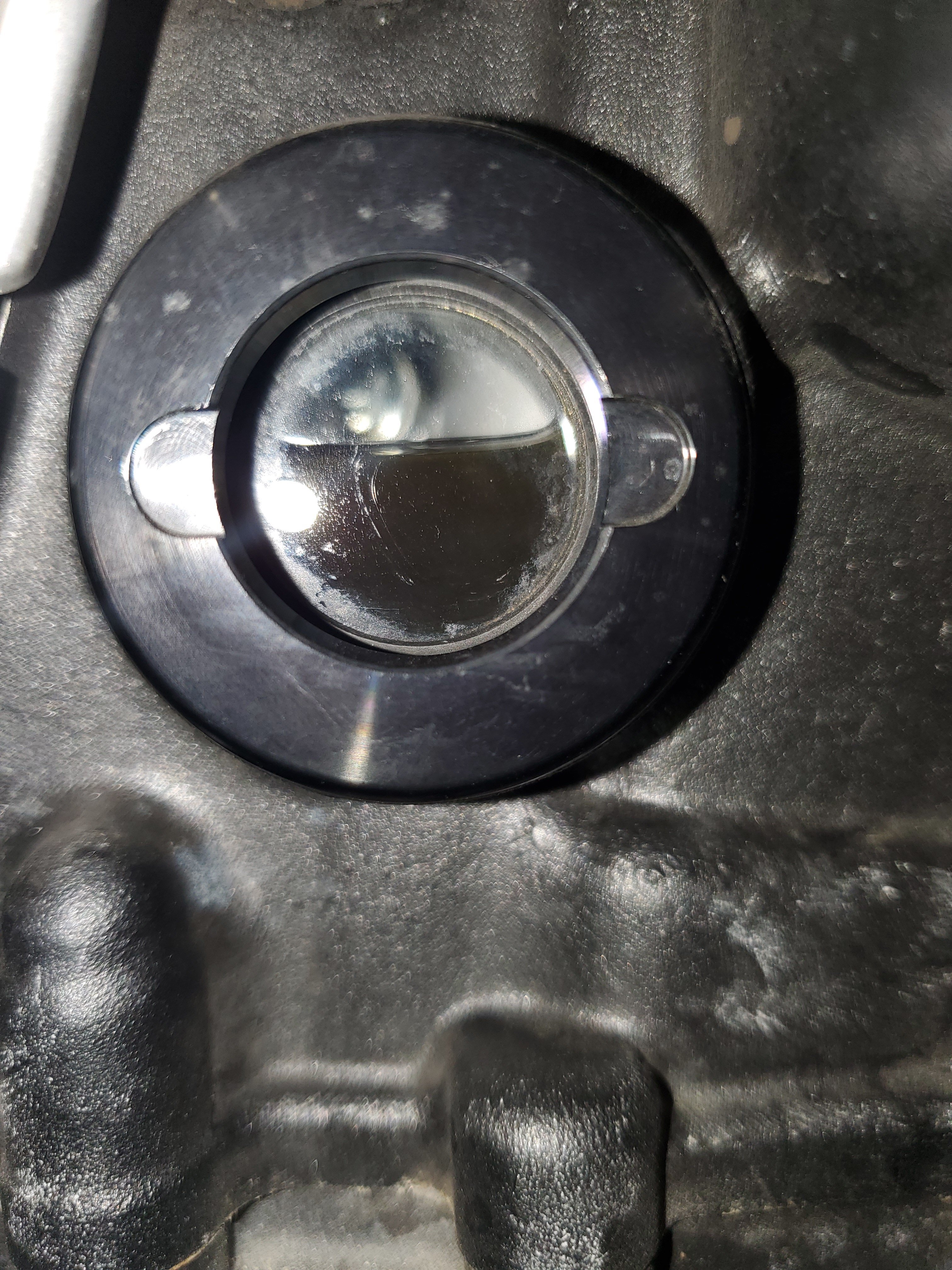

    Hello All,
    Recently got the oil changed at the dealer and they seemed to have filled it past the owners manual recommended spot. Picture included. Is this cause for concern? I assume there is a reason they have min and max mark ?
  2. Yorkshireman
    3,401
    It’s only marginally over the top line, maybe 100 ml too much? Take it back and ask them to drop a bit out if you want but as long as you have a gap in the window I’d say it’s ok?

    I change my own oil and filter on my Street Twin. I don't really use the oil level window when filling. My owners manual says to add 3.5 guarts when refilling. That's what I do. Then I run the engine, shut her down and check the level. Mine is also 'slightly' above the upper mark. My bike runs fine. So I would not worry about it. But if you are still concerned, have the dealer remove a bit of oil.
  4. dilligaf
    I wouldn’t worry about that level mate :)

    Just get a syringe off Amazon and drag out 100ml or so
    That level seems absolutely fine to me, very marginal overfill, but if it concerns you the quickest way is a syringe off Amazon with next day delivery

    Thanks all. I will let it be. Seems to not be as big an issue as I thought.

    Hey all, so I ended up getting a syringe to pull some oil out and removed about 300 ml which brought it to the middle of the min/max line. I ran it per the manual for 5 minutes at idle and then checked 3 minutes after which brought it right under min line. I'll check it after sitting a while and imagine itll be close to middle of min/max. There seems to be differing opinions on checking this. The dealer put in 4 quarts which equates to 3.8 litres while the manual states oil and filter is 3.4 litres which is about what I took out ml wise.
    So would the consensus be to check while cold which would give a more accurate level as it shows the total amount of oil vs hot where it would show oil, but not total as it would still be draining?

    Yes...check it cold. That way you know you aren't missing all the oil spread around the engine and not yet drained to the sump.

    So after riding and then parking and checking the next day before removing oil the level cold was almost to the top of the sight glass. I have it to where cold now it is right above the max line. After running it for 5 minutes at idle and then shut down and check after 3 minutes the level is right at the minimum line. I would still think the cold level check is best, correct?
    Picture below showing current level, cold and on center stand for 24 hours +

    What does your manual say, check it when cold or after a ride?
    I’ve had cars and bikes that have different instructions for checking the oil but I always follow the procedure stated in the owners manual.
    My car, for example, feels noticeably better to drive when the oil is topped up iaw the manual but if checked when cold it looks like there’s too much oil in. :grinning:
