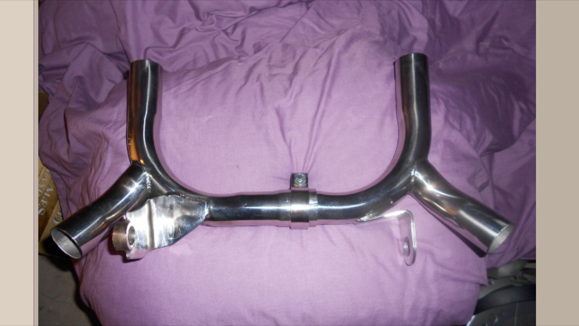

    Hi Tom,you haven't got any more info on this have you, as I've never come across it before? Pics or links?

    I've not got any photos myself but here's one I've borrowed from someone else's post on another site. Theres also a bloke on YouTube fitting one if you want to look more in depth, and in fact I used that video to help me fit mine properly. Unfortunately I can't copy the link.

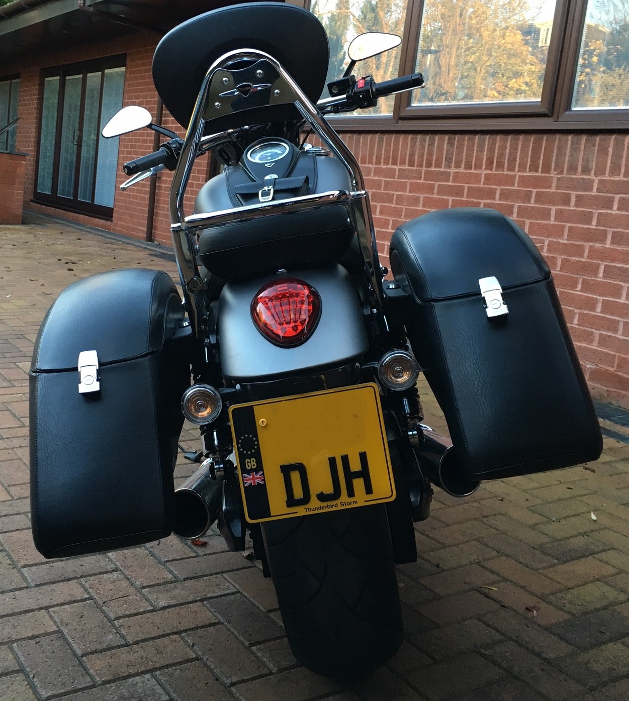

    I have attached a picture but since the photo was taken, I have added the black swing arm covers and a number plate relocation to clean the back end up a bit.
    Since getting the bike a year ago, I have had no end of compliments for its looks (even from bikers that wouldn't be seen dead on a cruiser - weirdo's!), the only thing that let it down was the sound of the OEM exhaust. Especially when people find out its a 1700cc engine, they expect it to roar! Now, this is not a problem at all. Roll on Spring time!

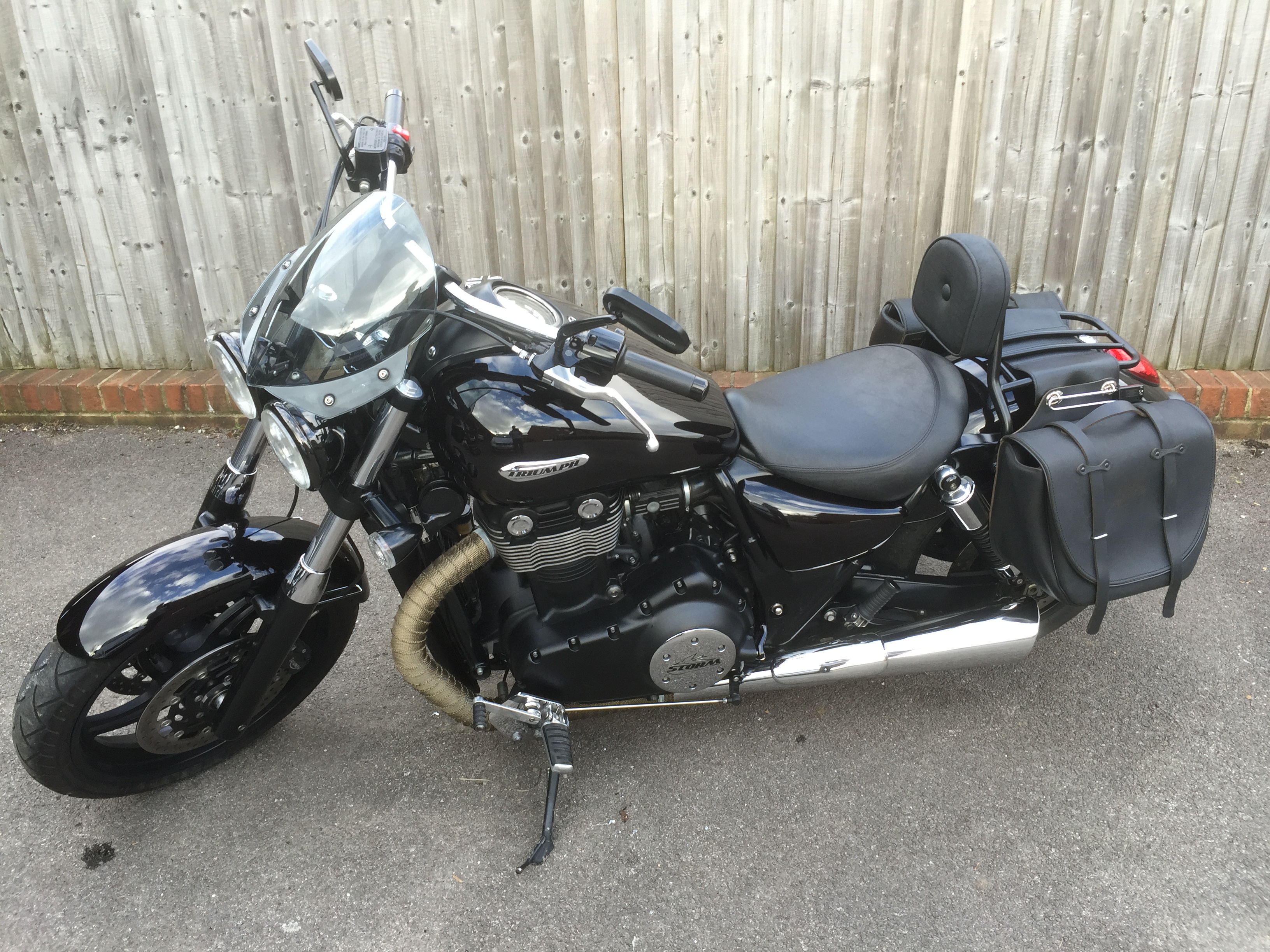

    I've added a photo of my bike. Why not! :)

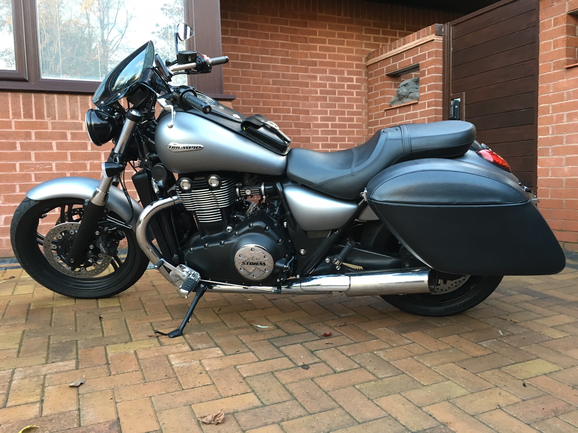

    As we're showing off, I have attached a couple more pics of the Storm in full "Fat Ass" mode with the bags on (I know it should probably be in a different thread but hey.....).

    The wrap is just vanity. I'm not a big lover of chrome or shiny metal. Liked the look on a cafe racer with wrapped pipes I saw and thought I'd do it to the Storm.
