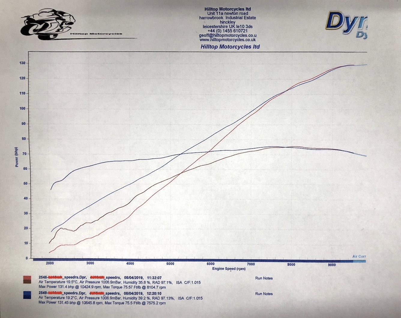

    a 90% dyno run won’t affect the low rev range readings, which i where the big gains seem to come with the Hilltop software.
    Will correct the Euro emissions requirements and rich furling at rpm where noise tests are done, same thing a PC5 and custom map will do but it’s seems about £200 cheaper going the Hilltop route. Only downside is you can’t remove and sell it when you sell the bike, unless buyer wants to swap ECUs.
    The power on Mr Ts RS was about the same above 7,000rpm but gained loads below.
    I’ll upload dyno sheet in a few min.

  12. Bryan3R
    Bryan3R Senior Member
    Jun 22, 2018
    229
    293
    Southend, Essex, England

    I only have good things to say about Geoff at Hilltop...and yes, it all does seem to be too good to be true, but it honestly feels fantastic. Very responsive, smooth and torquey. Remember that the bad 'before' curve was caused by my stubby AR exhaust - which is what I went to get fixed. And fixed it was :p
