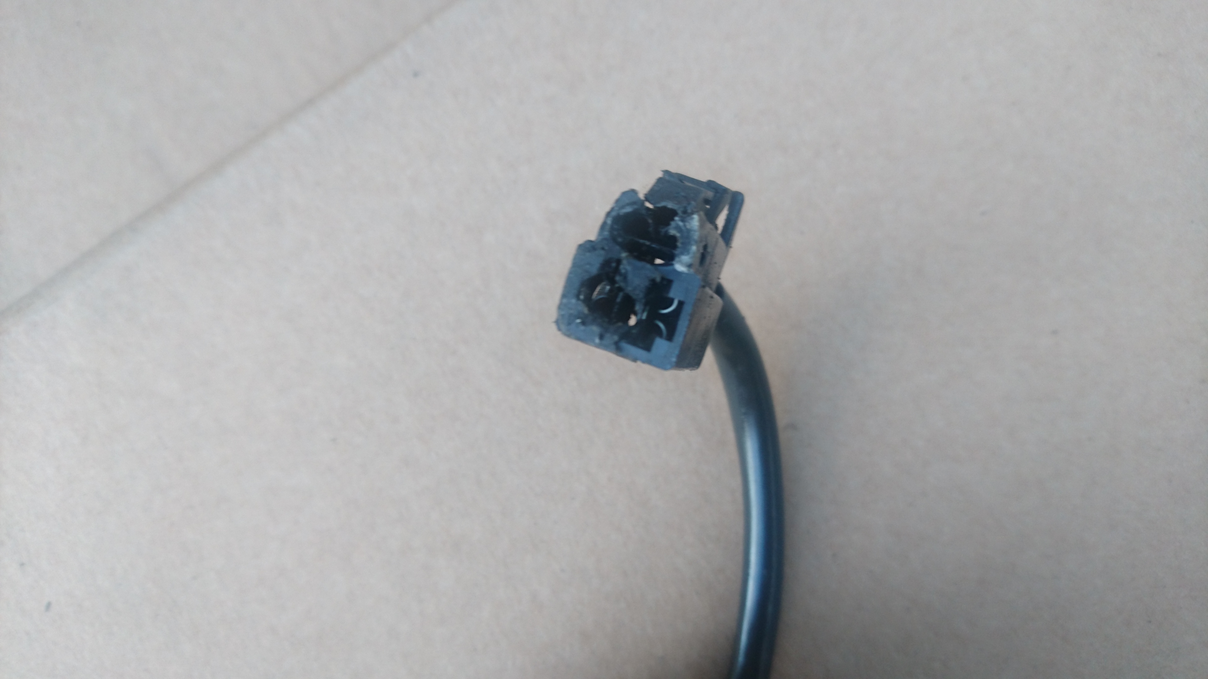

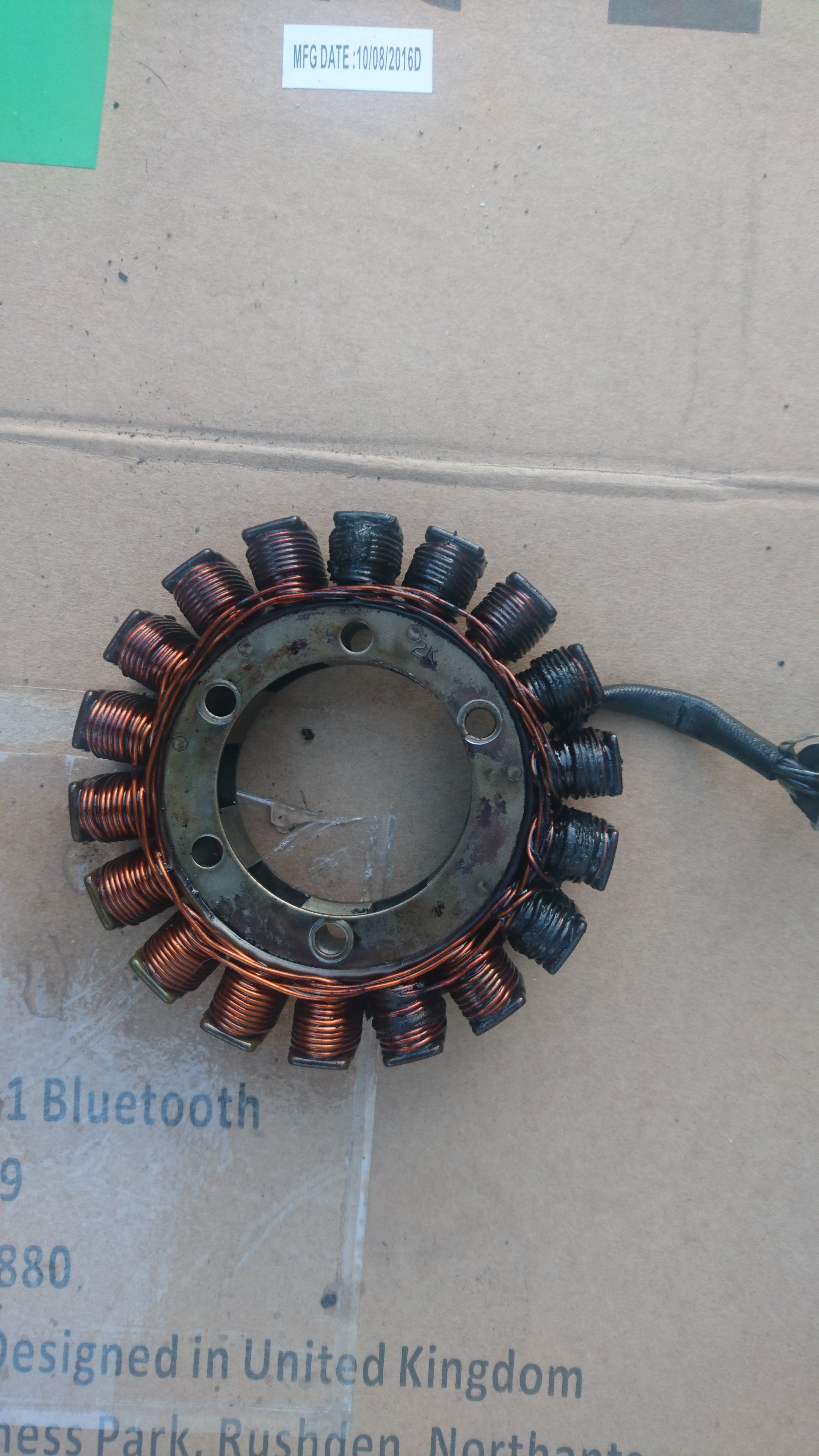

    Think I know what's happened here......
  7. capt
    capt Elite Member
    May 8, 2016
    3,051
    western Australia
    Yup looks like one side of your stator is deep fried ! I would replace the regulator too whilst you are on the job, as by the looks of that plug there has been a major event taking place over a few runs !!!
    Cheers Mick.
  8. Vladthetodge
    Vladthetodge Member
    80
    Sheffield
    Yeah. The plug is a little melted. Other end much better. Haven't ordered rectifier yet. Will do tho amd change soon as. Tbh it's ran many times whilst failing and it took till new battery was flat to investigate properly. My bad, but just done 90 days straight, no day off. More pissed off you gotta drop coolant to just to get to one feckin bolt!
    Fingers crossed........
    Cheers.
