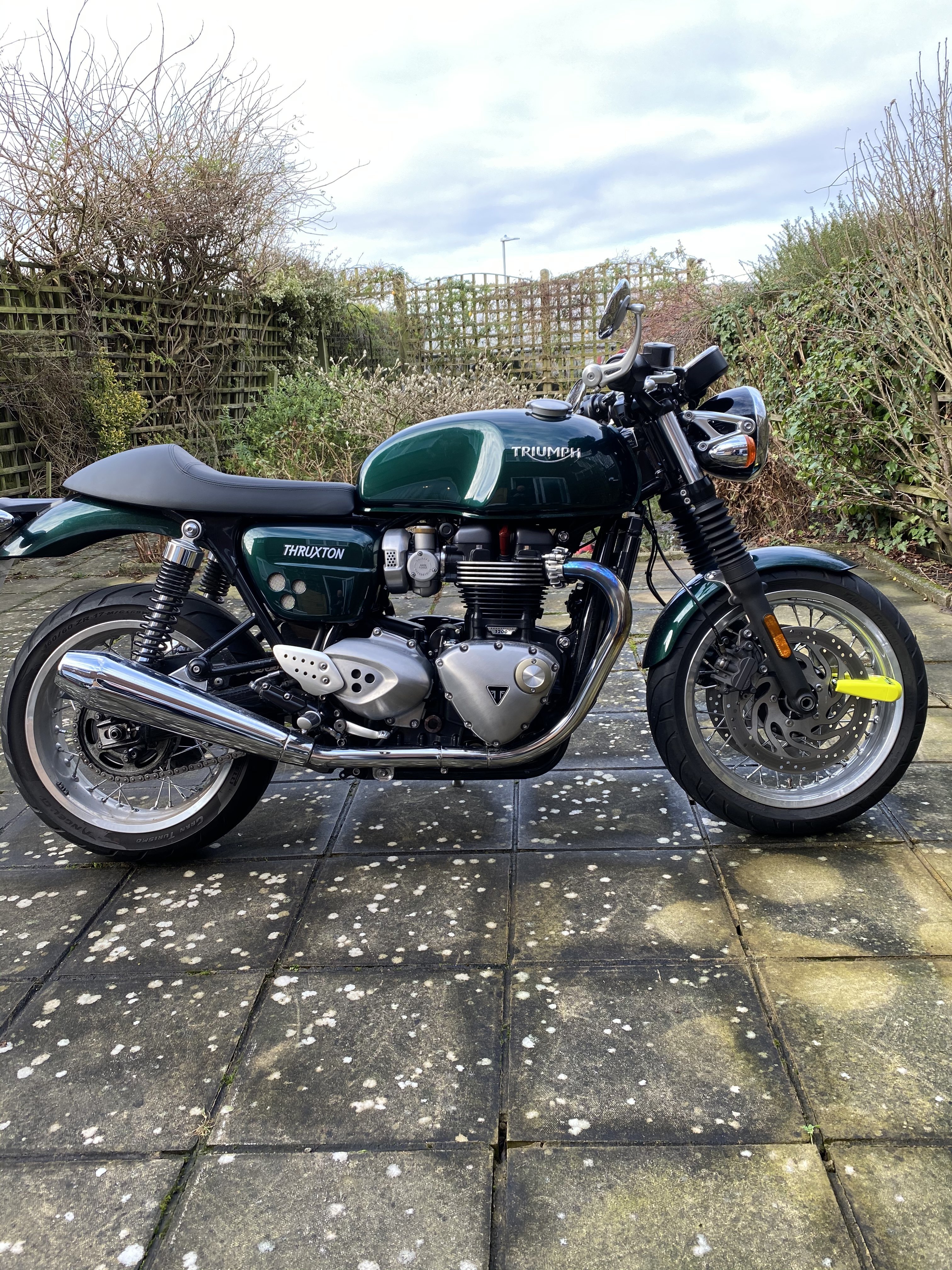

  17. OldNick
    OldNick Elite Member
    Aug 11, 2019
    1,259
    743
    South Coast UK
    Just cranked the pre load up to 5 max, and what a faff that was! Had to drop both silencers to access the adjustment hole
    Seat height previously
    5D13E4FC-1A29-41ED-86A0-29F391CA052E.jpeg image.jpg And seat height now
    Which is about 2.5cm higher, now to take her out for a spin before storm Dennis starts lashing down, again......
  18. OldNick
    Aug 11, 2019
    1,259
    743
    South Coast UK
    Just given her a good blast on the back roads to Pevensey and it’s like a different bike, more ‘solid’ ride, feels firmer in corners without the front end twitch or feeling like a hard tail
    So I am clearly the same size as Triumphs idea of rider with pillion plus luggage;)
    Are Triumph designers all anorexic dwarfs?
  19. TonyG
    TonyG Noble Member
    Dec 1, 2016
    756
    Bucks
    I think most bikes assume something like a 10 stone rider!
    Glad you sorted it out, just need some short Weslake silencers and you might not need to remove them if you adjust the shocks again.
    Great colour by the way.
