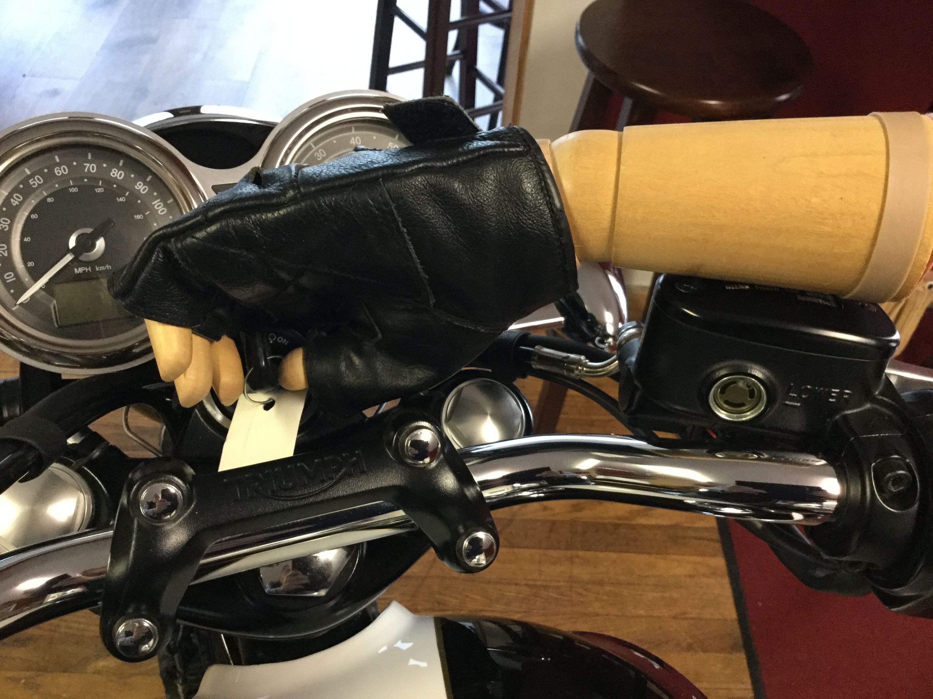

    5F2141AC-7DDA-4E0C-94E0-F3E0364CEBA4.jpeg Hey from Ohio
    How do I proceed, the cruise control appears to be a button to nowhere. What do I check next. Don’t know if it ever worked. The whirring in the front braking, hmmm hate taking these calipers off to check the bearings.

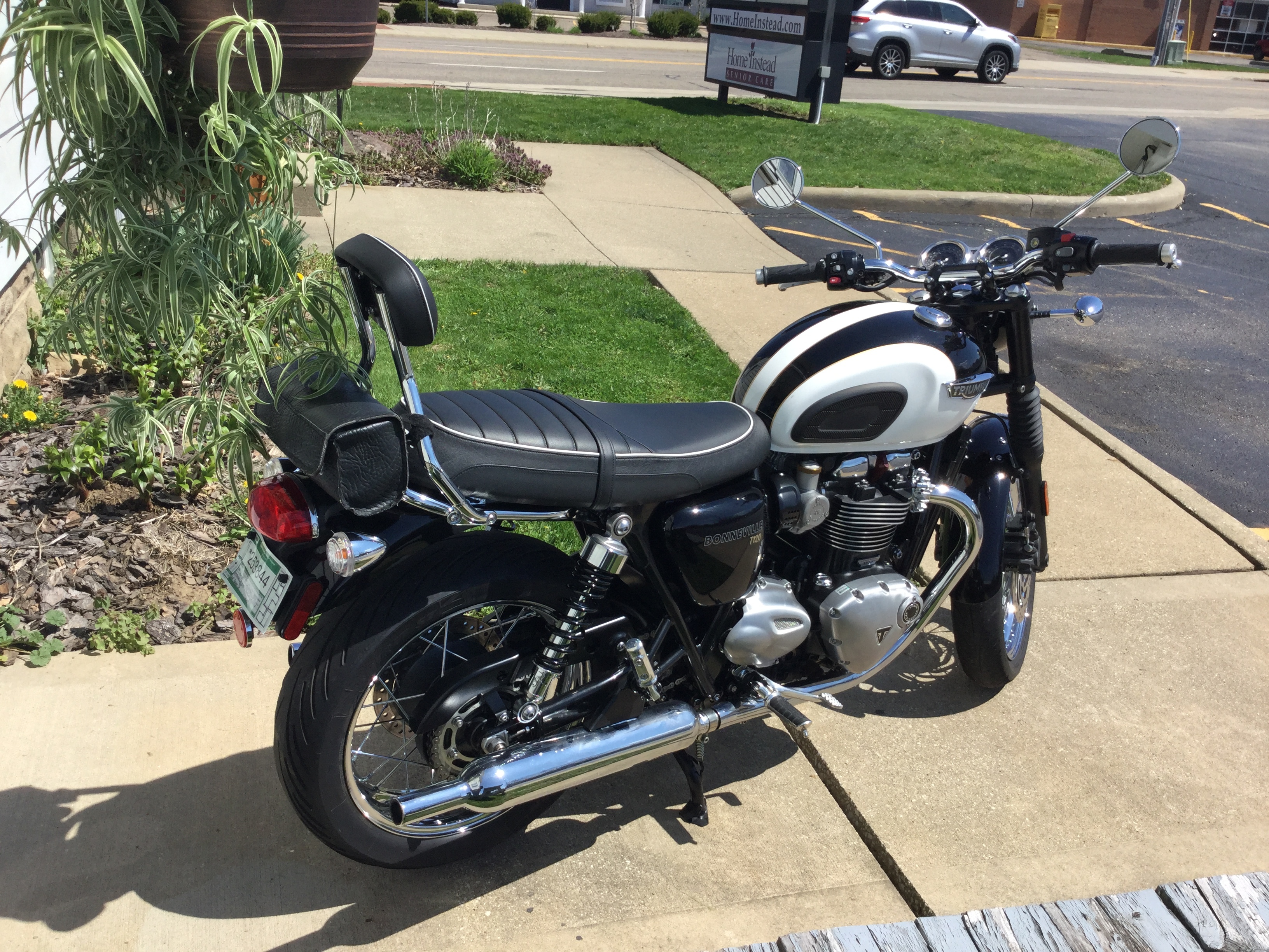

    D0222783-07A0-483D-A6BD-892453A620DB.jpeg Nothing at all...50 mph in 5th gear..long push multiple pushes...no indicators on the gauges to indicate a cruise control. I’m thinking someone added the left control to fit cruise to the bike and failed. Other than that, this is the smoothest, easiest and almost fastest bike I have ever owned.
  6. London_Day_600
    Jul 7, 2019
    41
    LONDON
    Does the bike manual mention cruise control operation? :no_mouth:
