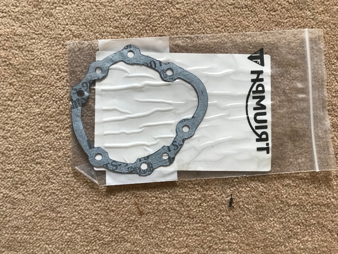

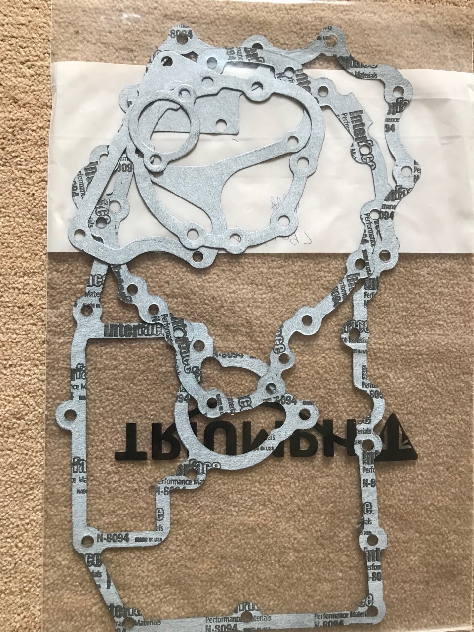

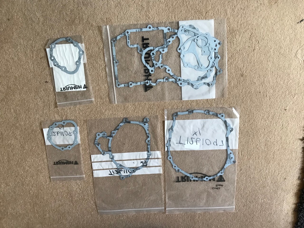

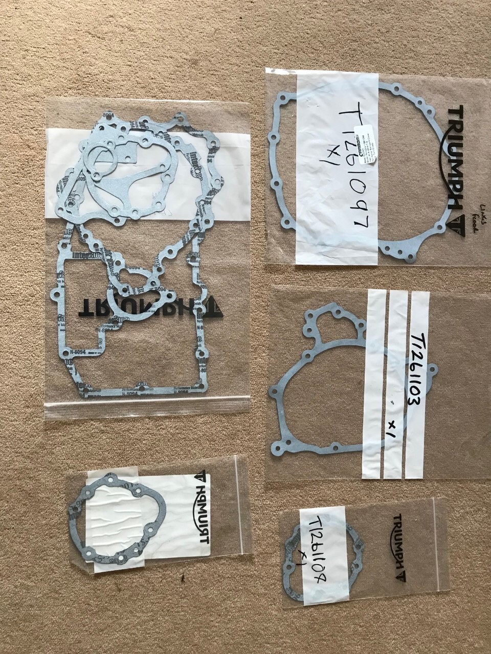

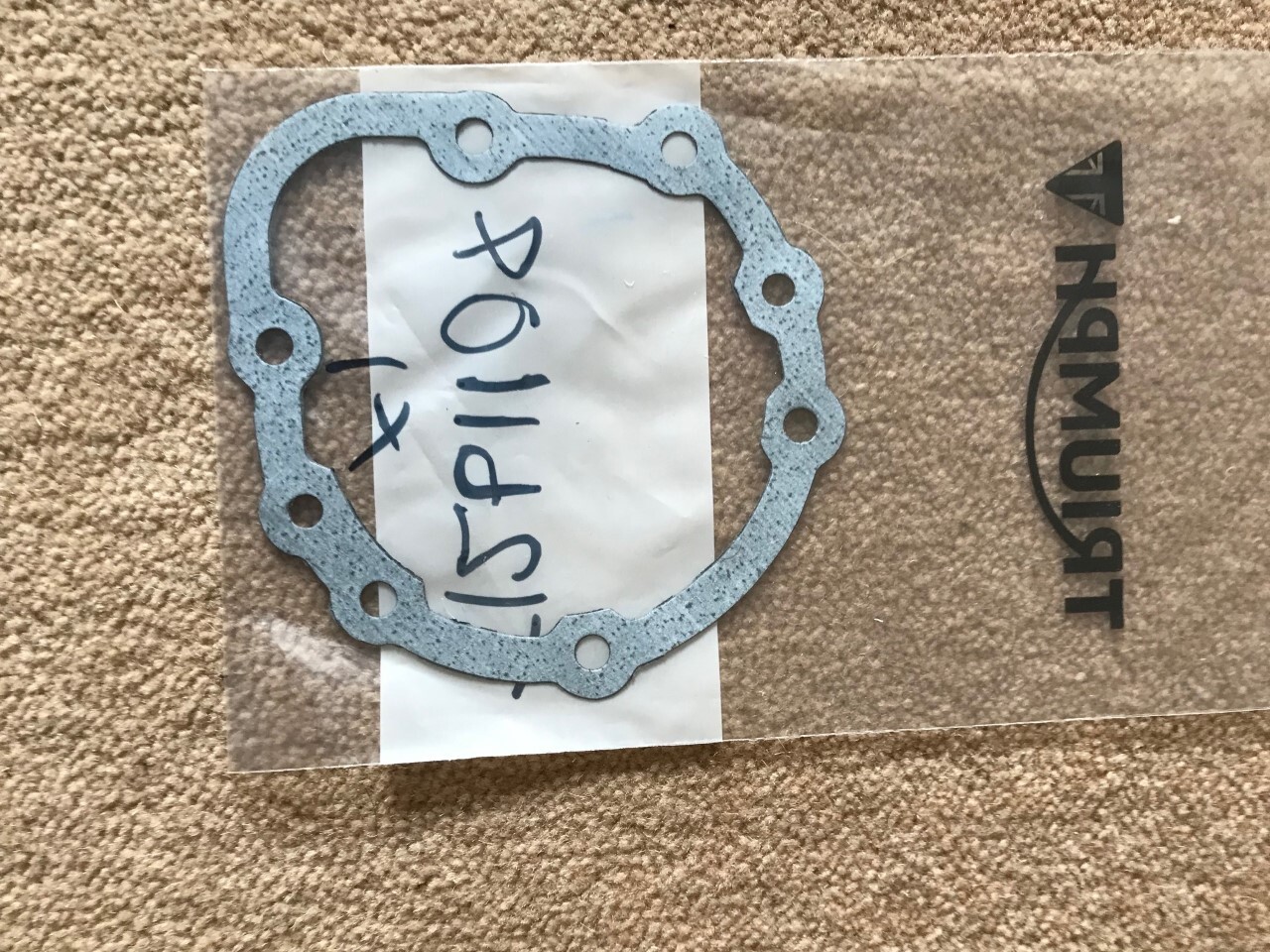

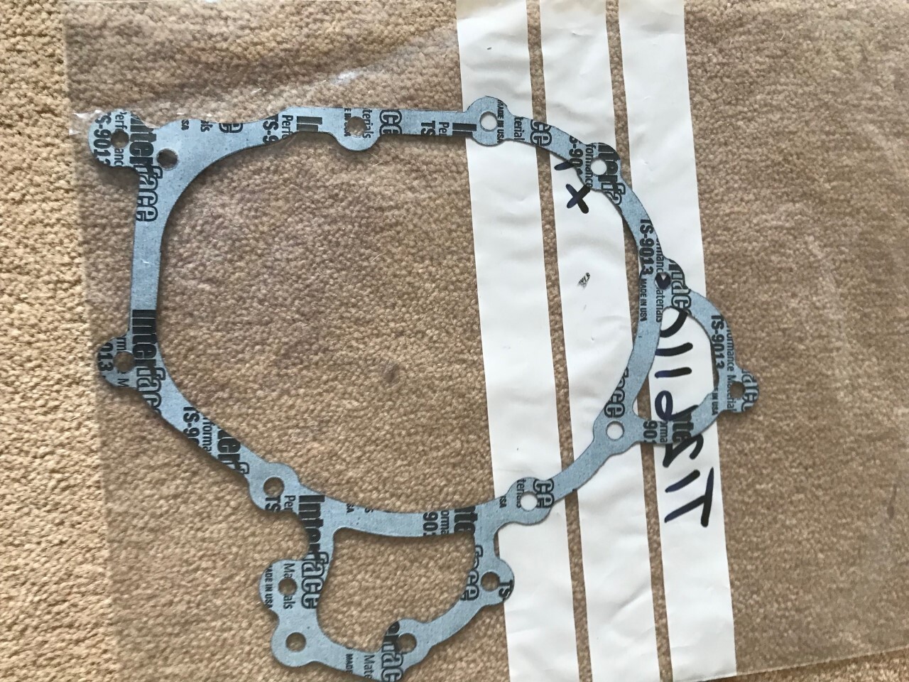

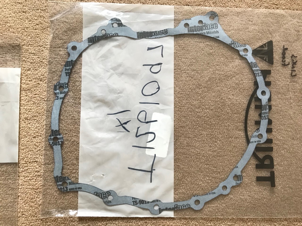

    Hi Daniel I have uploaded pictures of the gaskets, just PM me if you would like them.

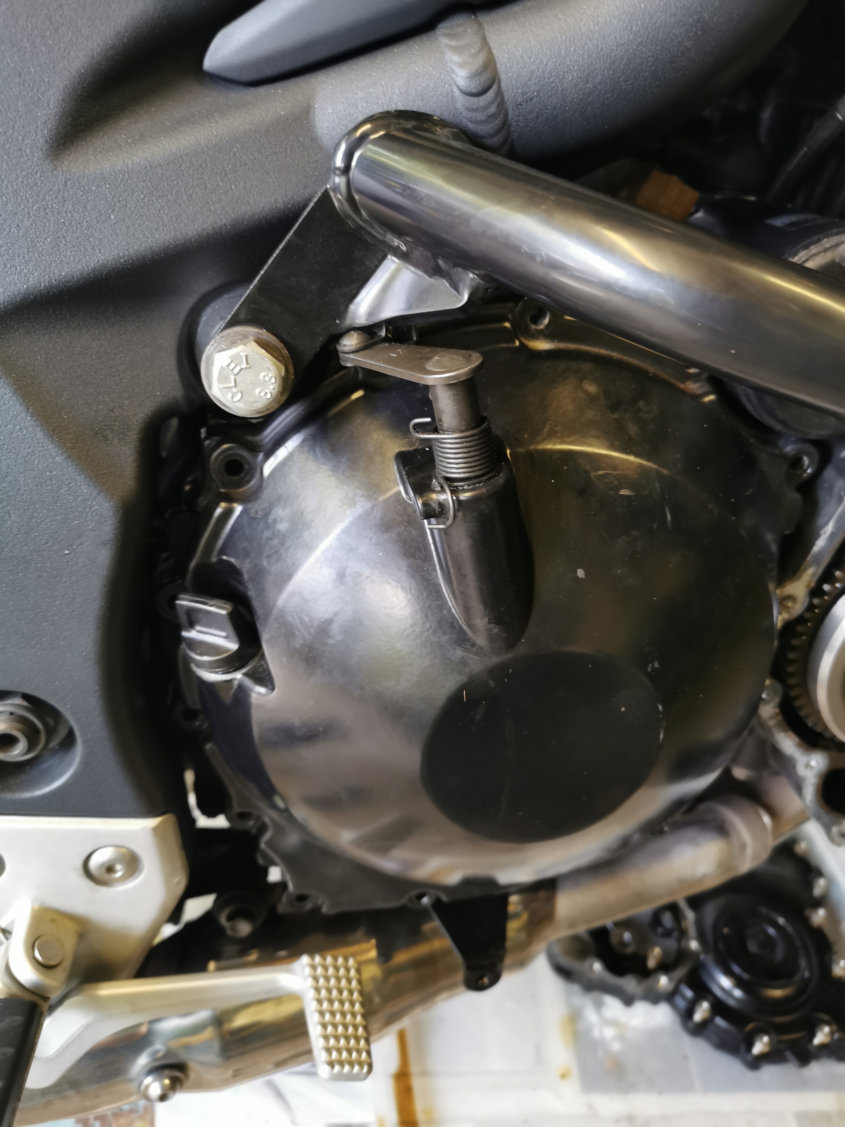

    So, I am elbow deep in having a go at this clutch investigation.
    Surprisingly all is going ok, except...
    The clutch cover has popped off and is loose, but will not actually come off it is caught some where, some how ..
    Is it the clutch actuator arm? Is it hooked over the pin I side somehow or something? I can't work it out...
    If I push the actuator arm round (clockwise) it "pulls " the cover on, so I'm thinking it needs moving somehow...
    Am I also having issue because the crashbar is in the way? It's a PITA to remove that....so, I'm hoping it isnt : unamused:
    I hoped the cover would just pull off now...but it won't...
    Any thoughts?

  11. Eldon
    Eldon Elite Member
    4,166
    I haven't done one of these but on a zzr600 the following works as the arm has an internal claw which maybe your issue here - Fully remove the cable from the casing end.
    Try turning the actuator arm anticlockwise to disconnect as you pull the case off ;)
    Hard to tell from your picture but not sure the crashbar will let you do that :sob:

    Thanks @Eldon , it won't...but I fear that that is the action needed!
    Having a look,.it seems that the crashbar is bolted on via the engine mounting bolts! How the bejesus am I supposed to get that off with out the engine falling out!? Let alone get to the nut on the other side!
