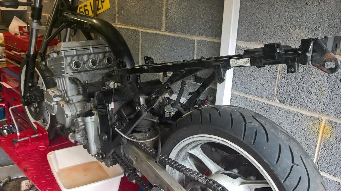

    WP_20160911_12_59_59_Pro.jpg unnamed (1).jpg Hi.
    Thought would start a thread to keep a record of my Cafe Racer Build.
    Have looked with Interest at others building these.
    Started of with a Trophy 900 1991 spec which had been stored for 9 years i think with broken Sprag Clutch. Anyway i bought as a runner.
    So far have completely stripped down, cut the frame, got 3 spoke 17" Rims, carefully bagged and marked all bits and pieces up.
    Frame and all metal bits being powder coated, got some brand new front forks and various other bits piling up.
    Checked engine over valve clearances spot on, sump pretty clean, main bearing shells looked perfect.
    Will post more pictures as the build goes on.

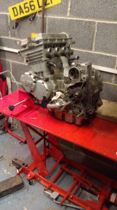

    The one i bought was off Ebay, £270.00 delivered and is excellent

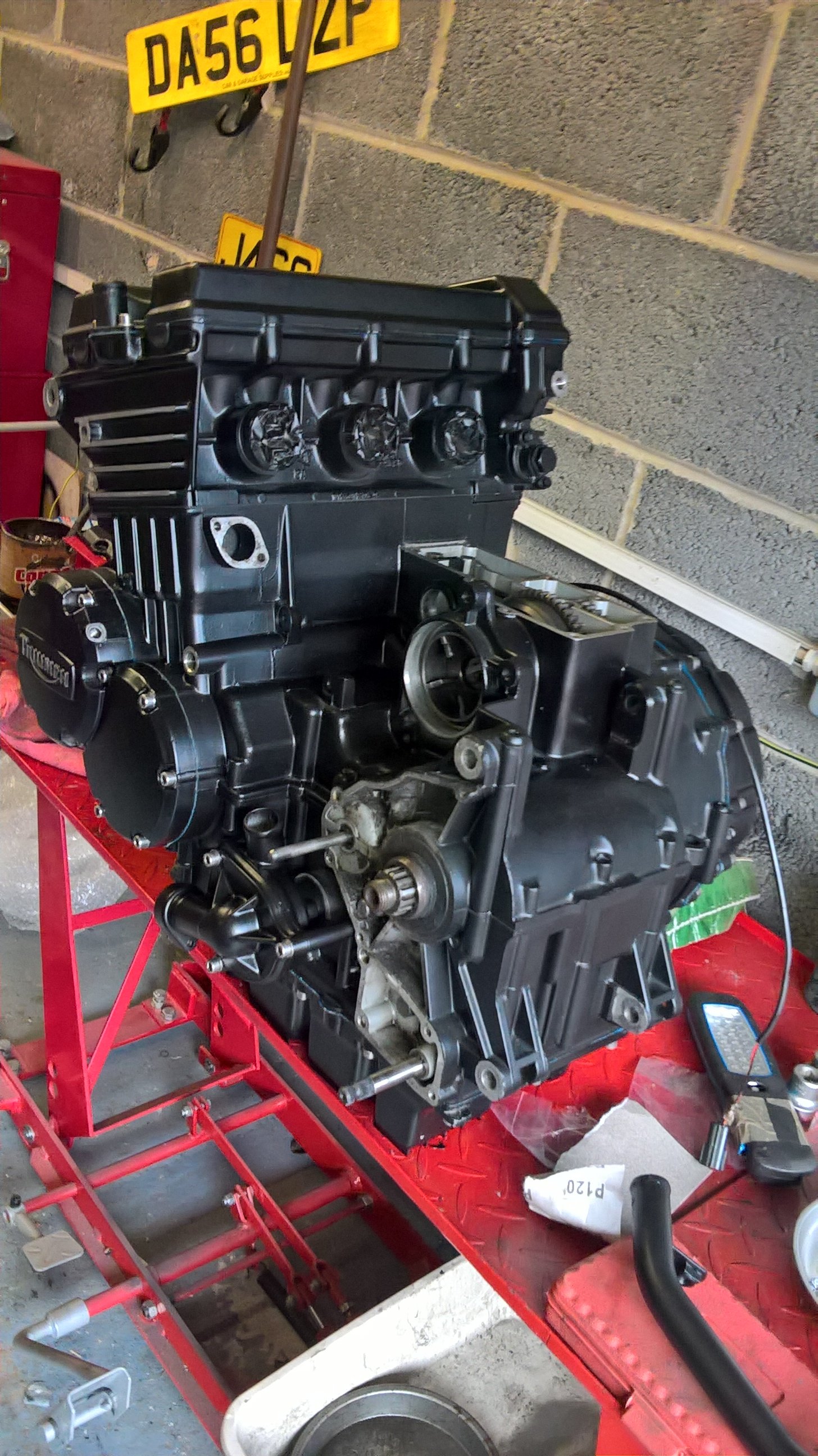

    Here is the engine originally silver finish, changed to Black now !! Sprayed the engine with covers loosened but in place, then removed all of the covers to spray individually. Turned out well pleased with result, cant recommend Simoniz "Tough Paint" enough covers well oil and petrol resistant to, dries to good tough finish.

    WP_20161112_14_33_14_Pro.jpg Hi Bit of an update, engine virtually complete and checked/re-built back up colour changed to black from the original silver.
    Fitting new bearings and building up the wheels and suspension at the moment, so not to much to show until engine back in the frame with the wheels on.

    Hi i did the basic checks on the engine as been stood for 8 years with broken spragg clutch. Compression checks fine, took bearing caps off, checked ok replaced oil pump, cam chain tensioner and checked valves. just gradually painted up and put back together with all new seals and gaskets.

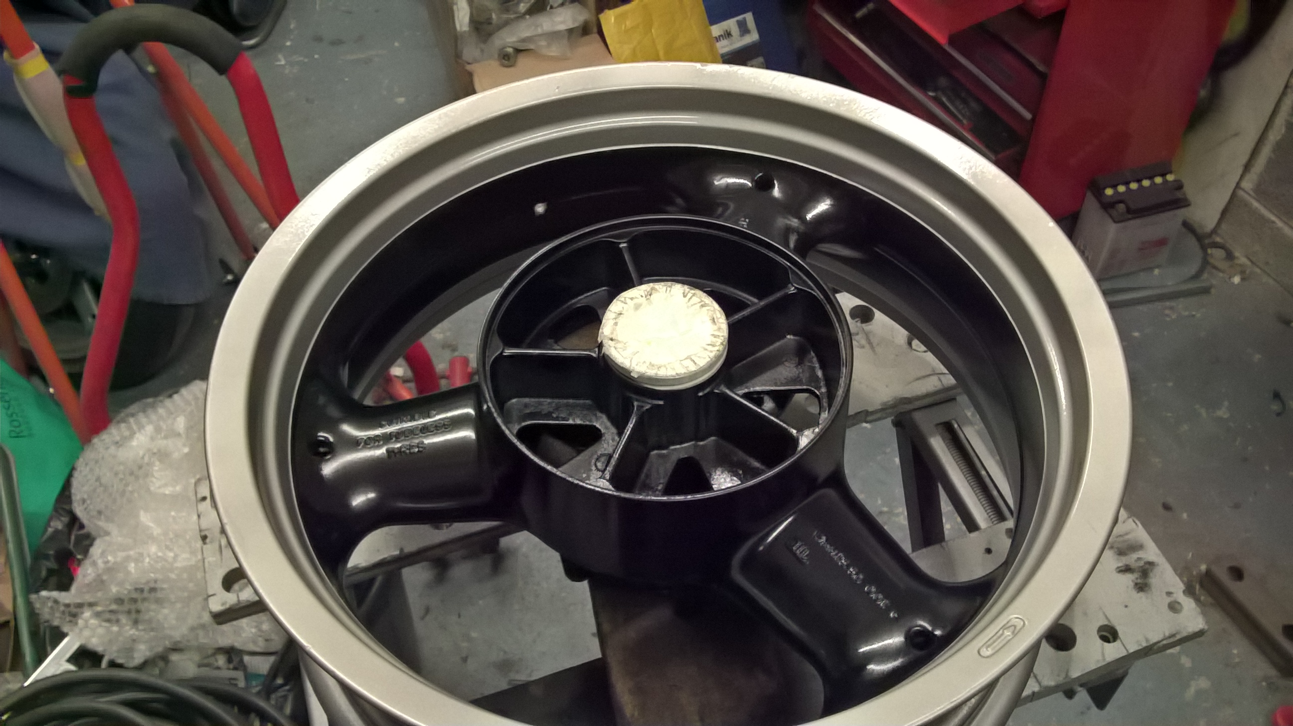

    I replaced the 6 spoke wheels that came with my Trophy Base Bike with the 3 spoke Brembo items same as your Daytona, had them powder coated black then masked and sprayed the silver rim. Have to now get tyres fitted and put new bearings and seals in thats this weeks job !!
