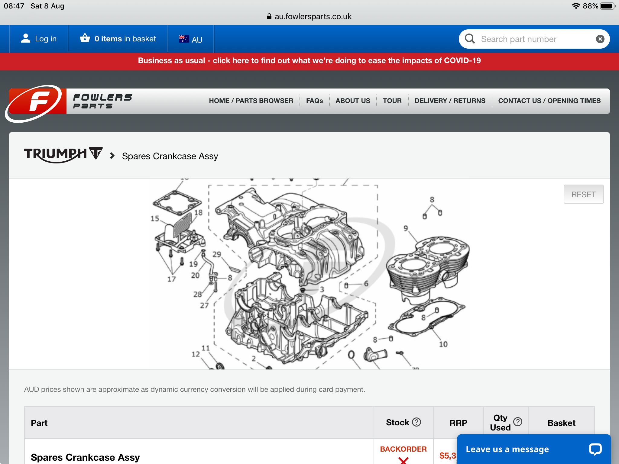

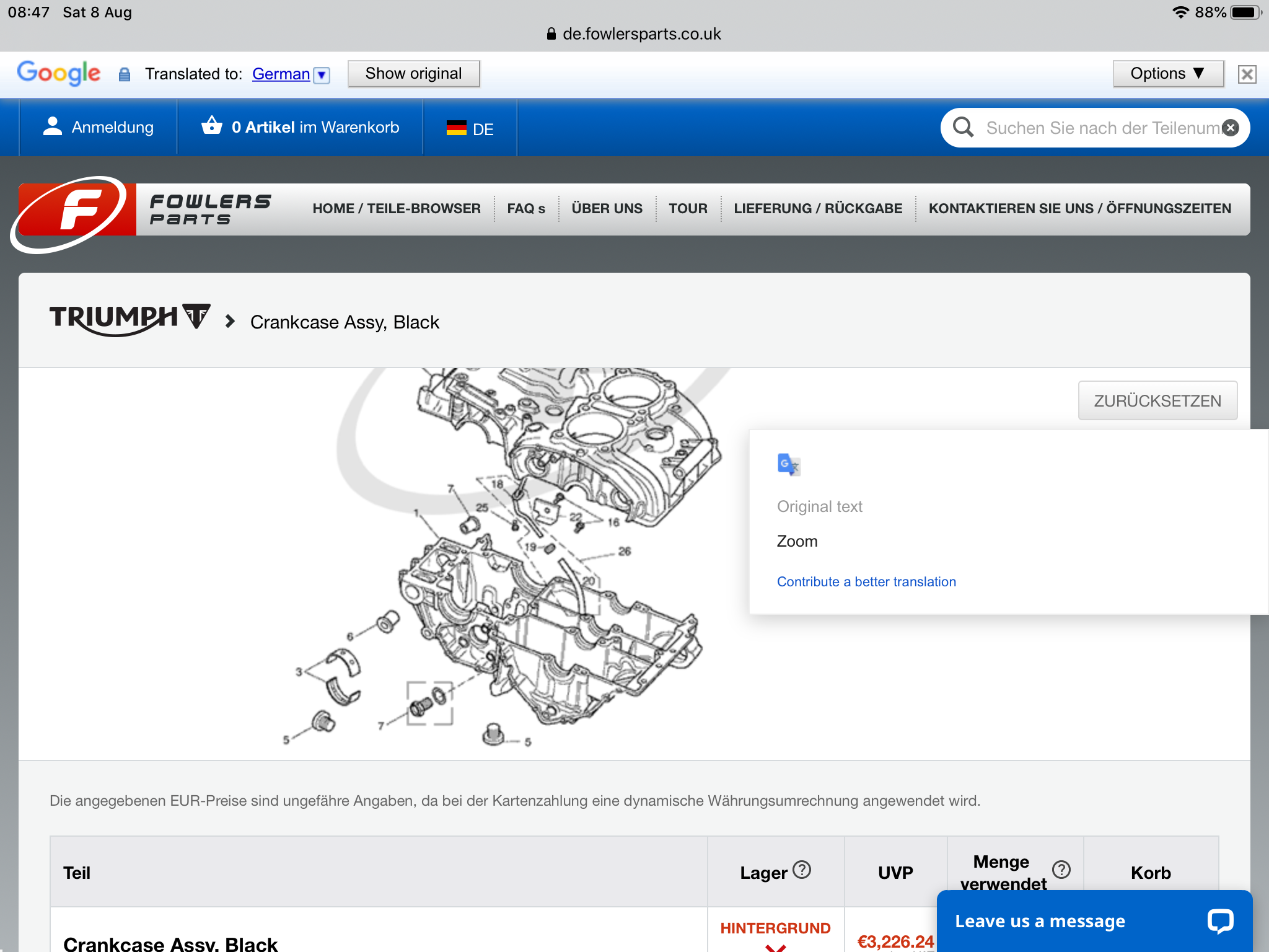

    I need some advise please. I have a cracked crankcase on my 2018 Street Scrambler and I want to replace it with used crankcase from a 2012 Bonneville part number T1160118. The part number on my 2018 street scrambler is T1163042. Does anybody know if the 2012 crankcase will fit on my Street scrambler. From the research that I've done it looks almost identical, however I cant find any information on the internet that say it is interchangeable.

    Looking at the two crank cases on Fowler’s parts site, based on those part numbers they look very different.
