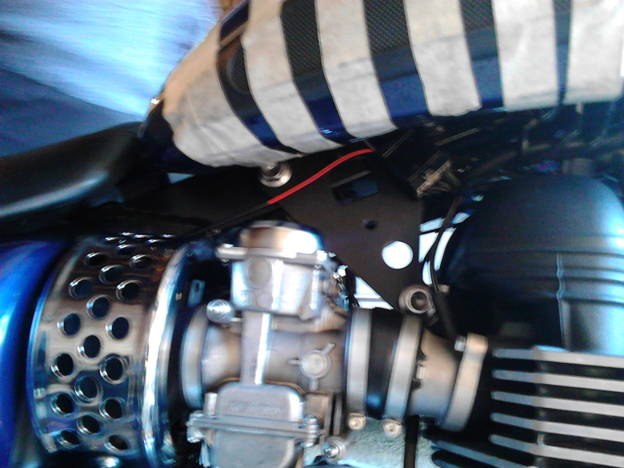

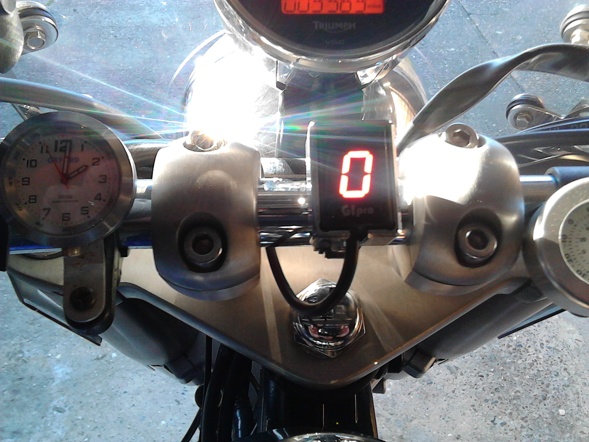

    Nice sunny day here so decided to fit the gear indicator and knee pads, thankfully it all went well and in functions perfectly.
    Instructions wanted me to splice into a power lead via the kill switch and it suggested the leads going into the plug for the alarm. Not a fan of splicing anything so because I don't have the alarm or plan to fit it. I got hold of the pin needed to go into the dummy plug fitted to the alarm block. Pin 4 is power via kill switch. Thankfully idea worked.
    It does now mean I have 49 spare pins for this block (could only buy a pack of 50), lol, so if anyone wants to feed off this block for any reason happy to send a few to you, just pm me. It's a neat way of getting power without cutting and splicing.
