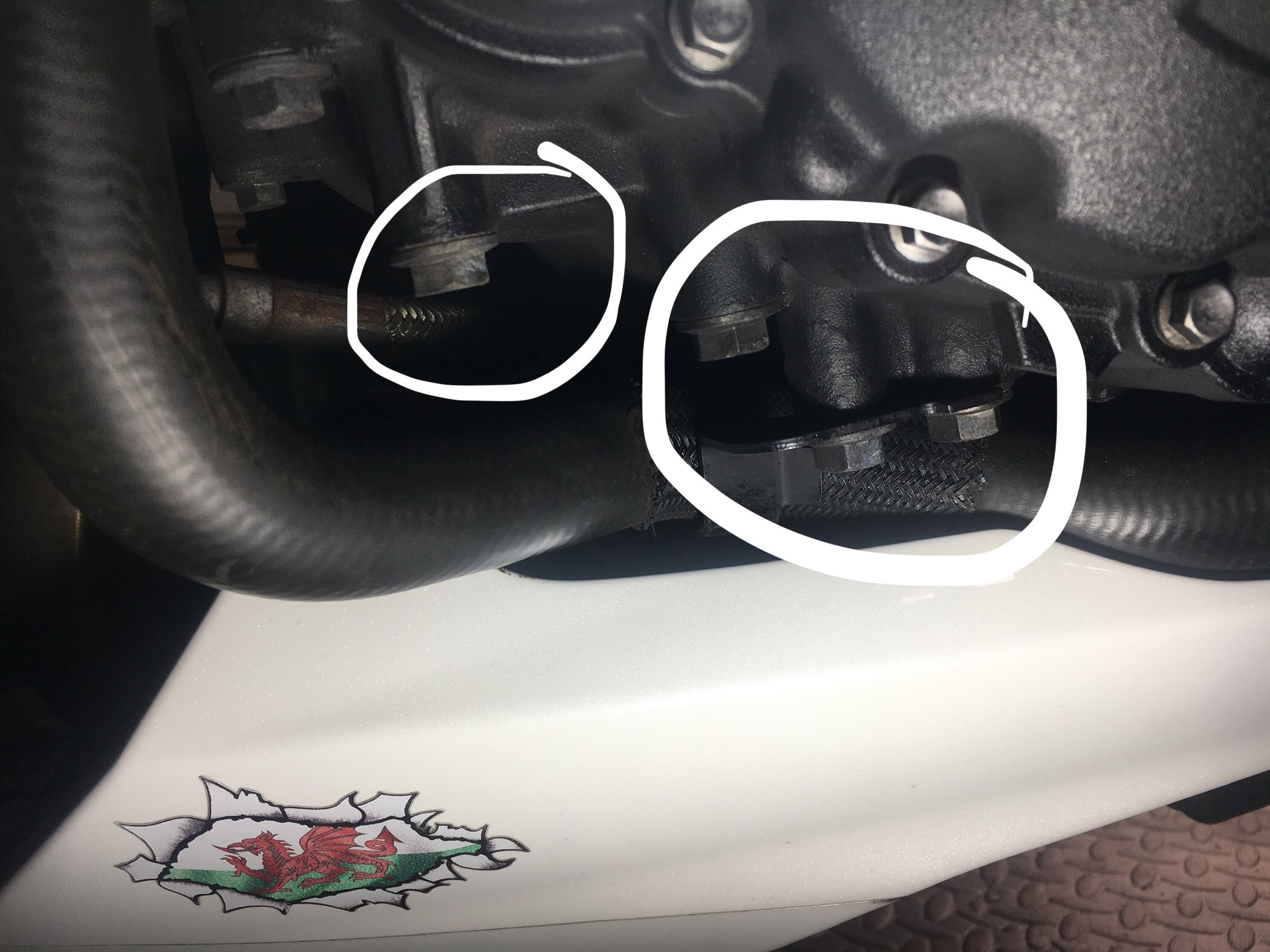

  7. topbanana0
    topbanana0 Well-Known Member
    Mar 27, 2016
    226
    South Wales
    Can't see any drain bolts but exhaust, just these (2016 speedy)
    Looked at manual ( 1st gen 1050) it just says take off bottom hose.
    Could someone take a pic of this bleed bolt
