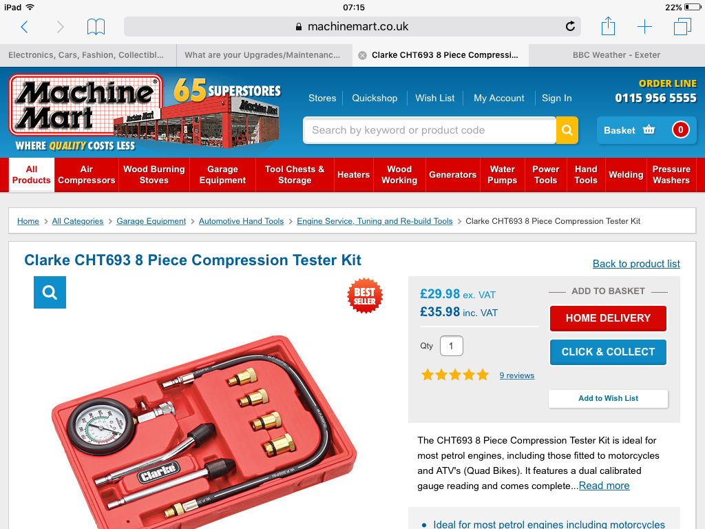

  16. Clarkey231
    Clarkey231 Noble Member
    Jun 9, 2016
    473
    313
    Exeter
    Off to get one of these today!

    Ok after buying tester and adapting a spark plug tool I've got the results!!
    C 1, 68psi
    C 2, 75psi
    C 3, 71psi
    So plus 15 psi for cold gives a range 83 to 90 psi. This is with old oil, no carbs and stone cold.
