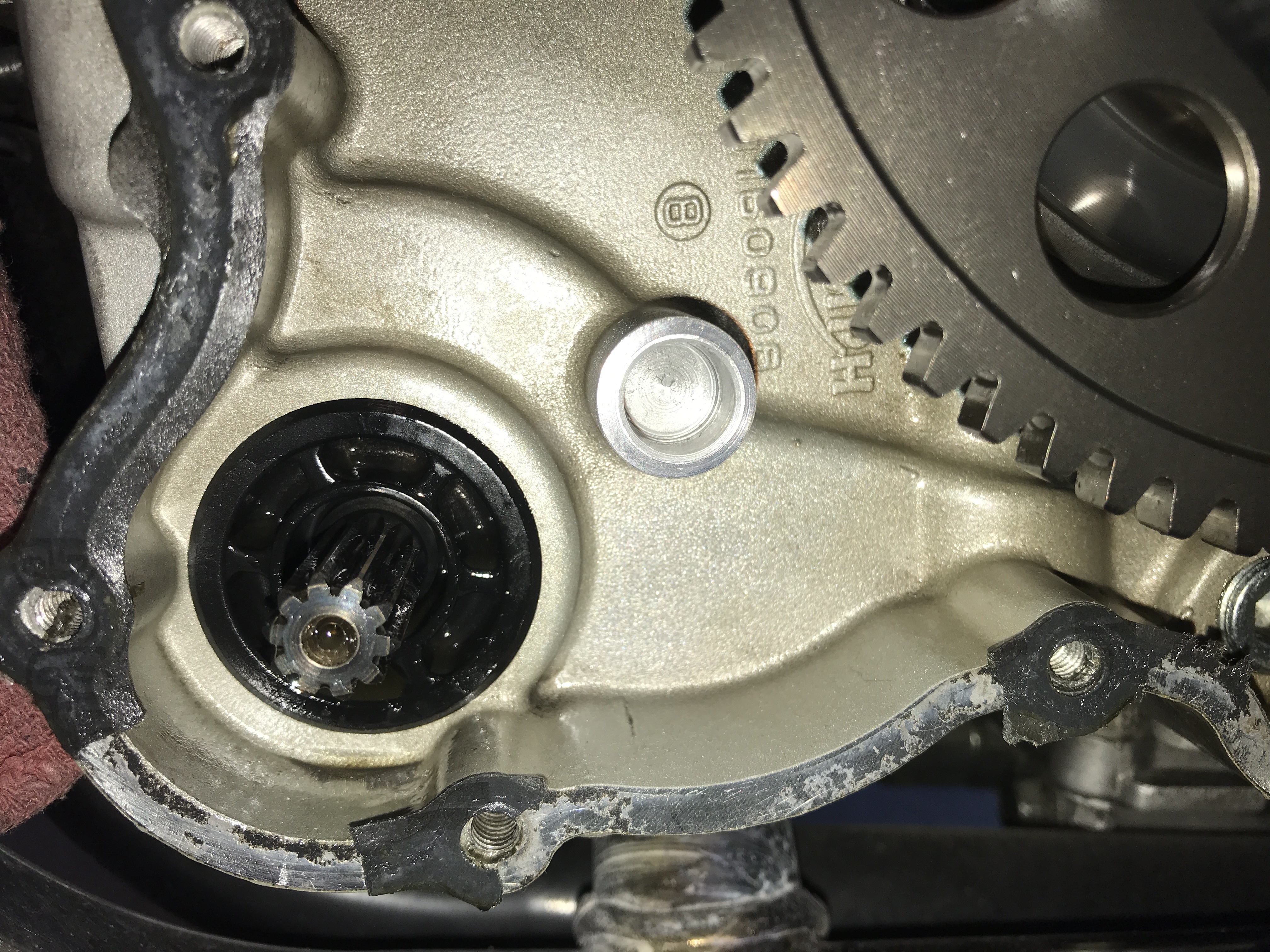

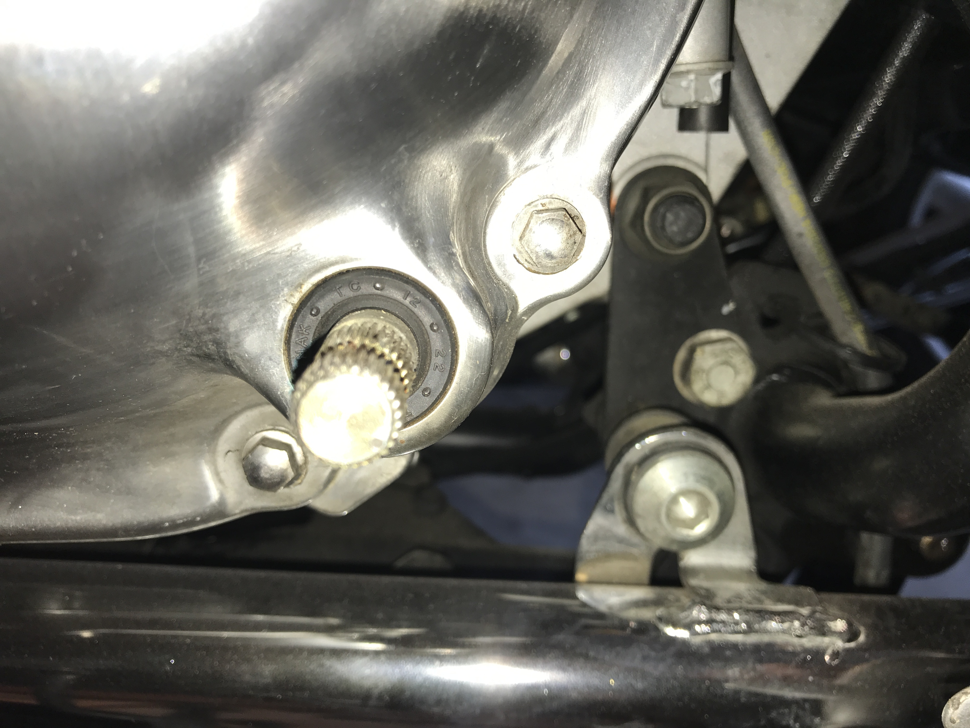

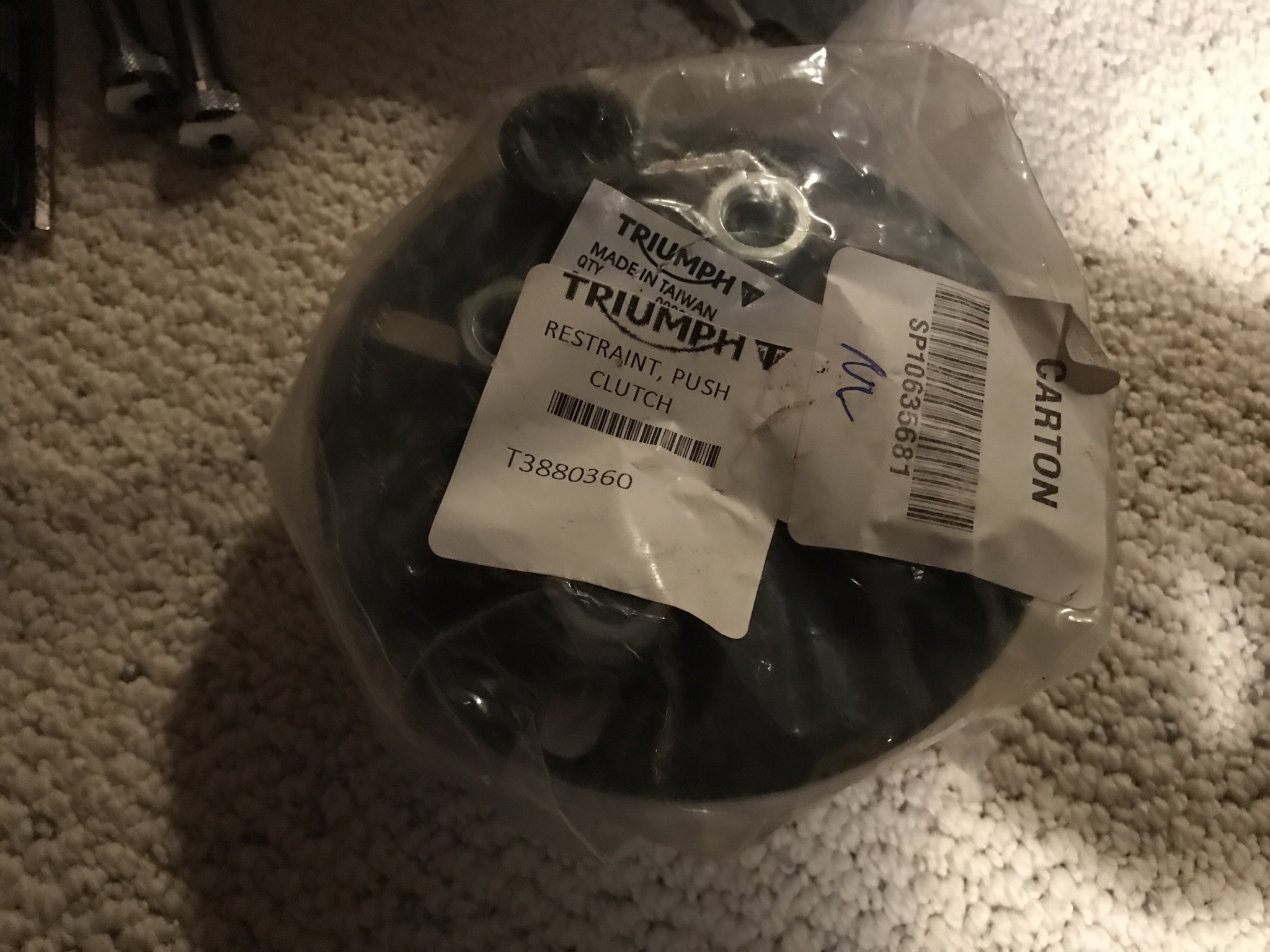

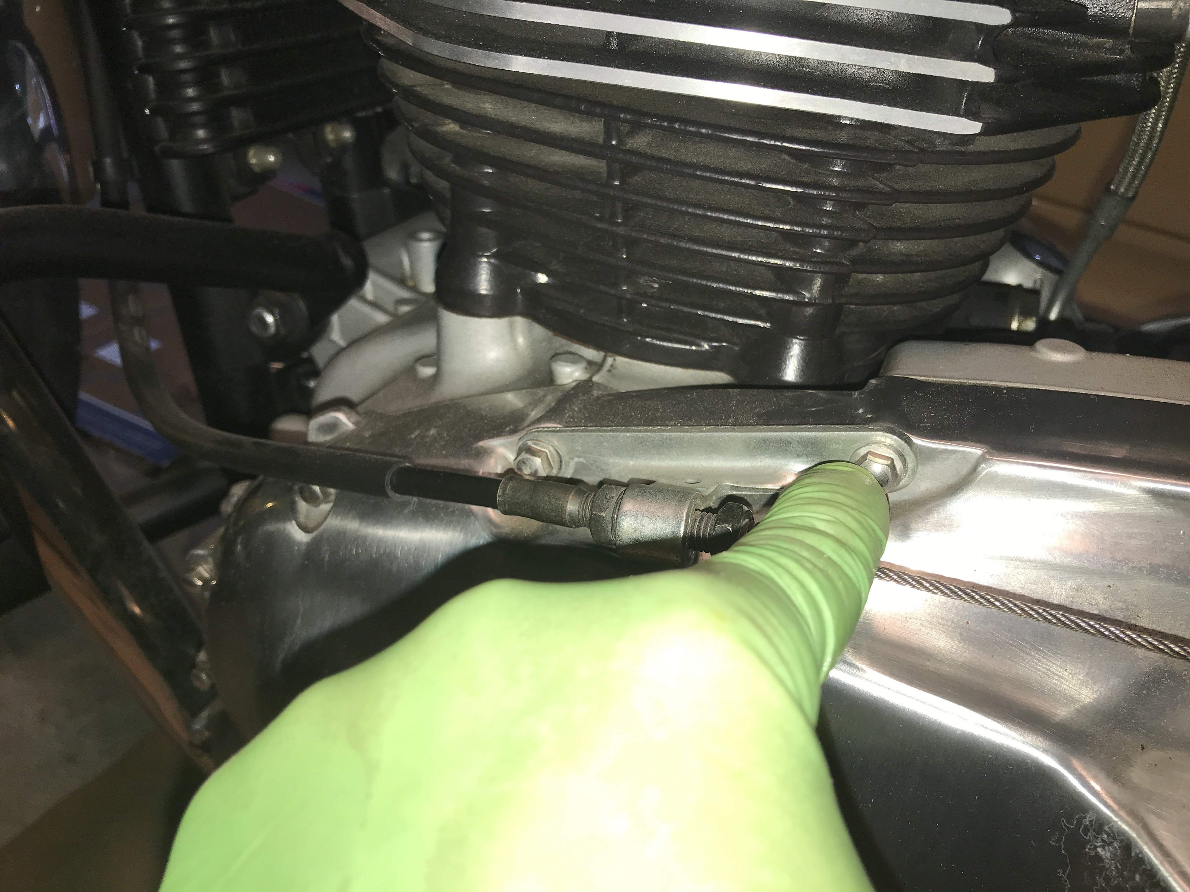

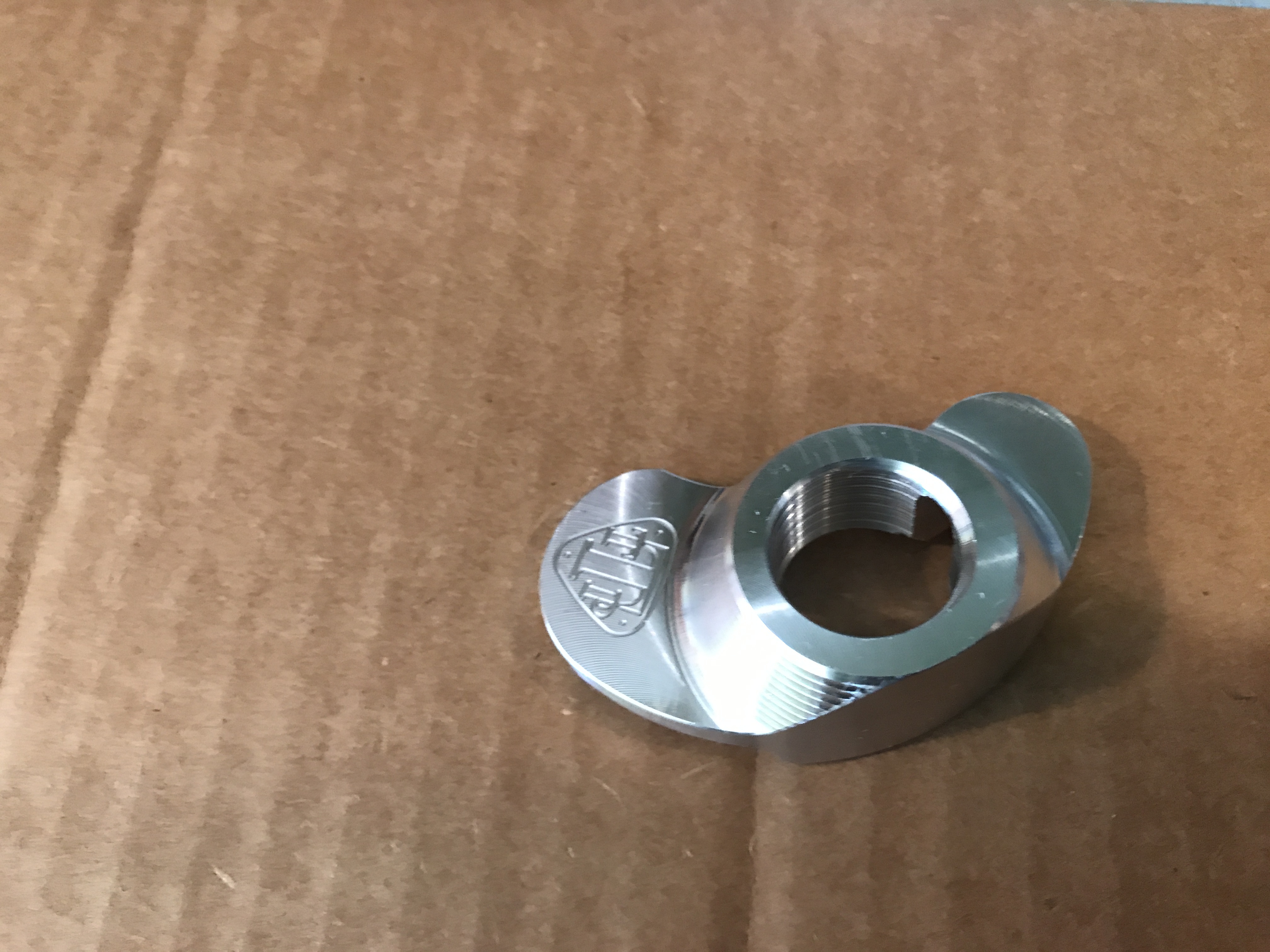

    I’m going to do an idler boss reinforcement on a 2005 Thruxton. Since I’ll have the clutch cover off I’m going to check the clutch and most likely replace the discs. I have the clutch restraint tool for disassembly and assembly. I’ve understood the job can be done without the clutch alignment tool. Any thoughts and recommendations appreciated. 0578CD5C-E36E-4F8D-8907-49596E64B421.jpeg E98F057C-153B-458E-9F31-0ABFFCF6ED36.jpeg AA387628-DFFD-4665-9A6D-F2126A42F9E3.jpeg

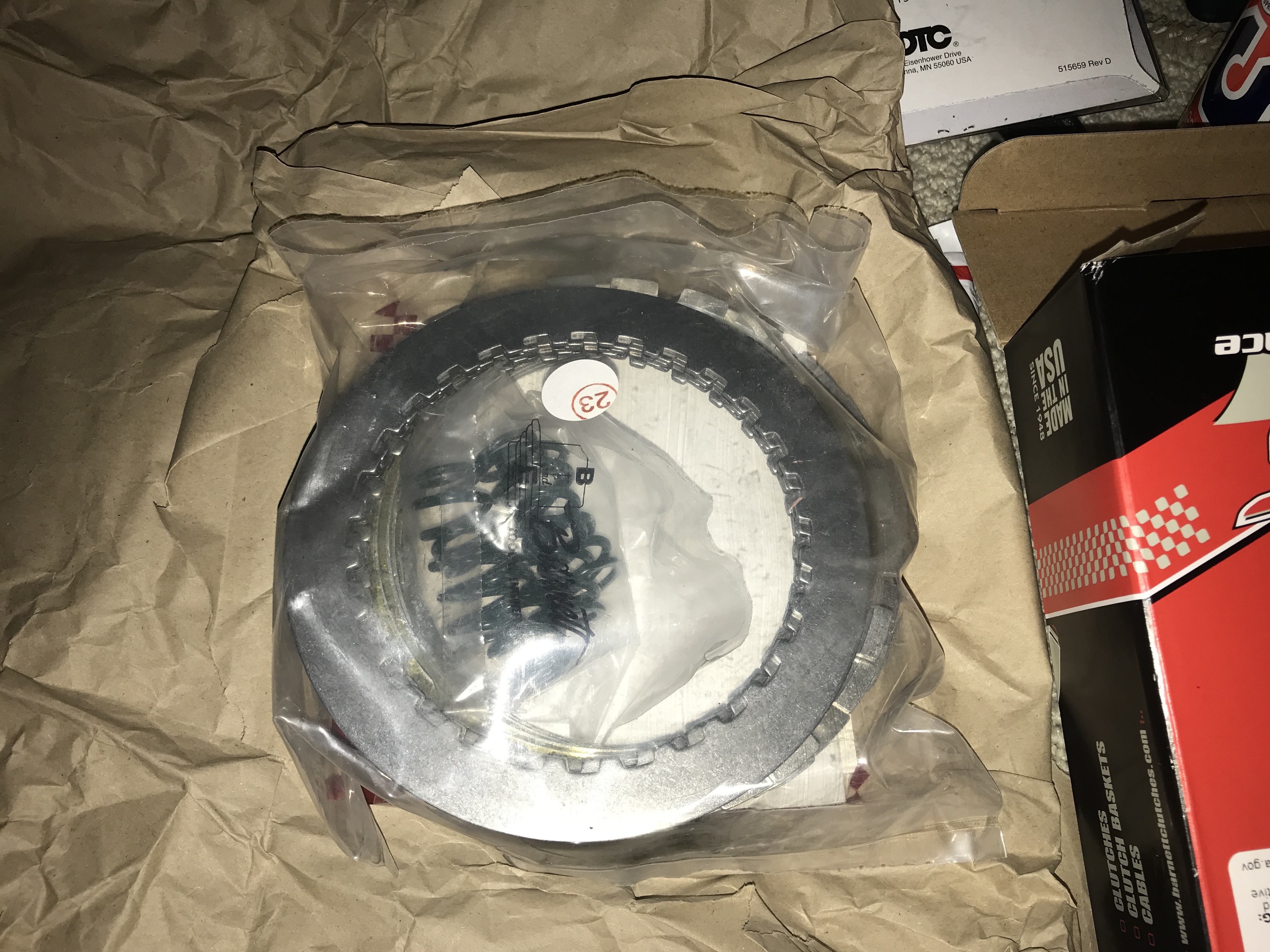

    CBB859CB-9FFE-4473-A175-110B7DFB8216.jpeg B053BD97-DBE9-483A-829A-75C1D7678DDD.jpeg The parts came in a bit back, but had other jobs to do. Going to start this this weekend.

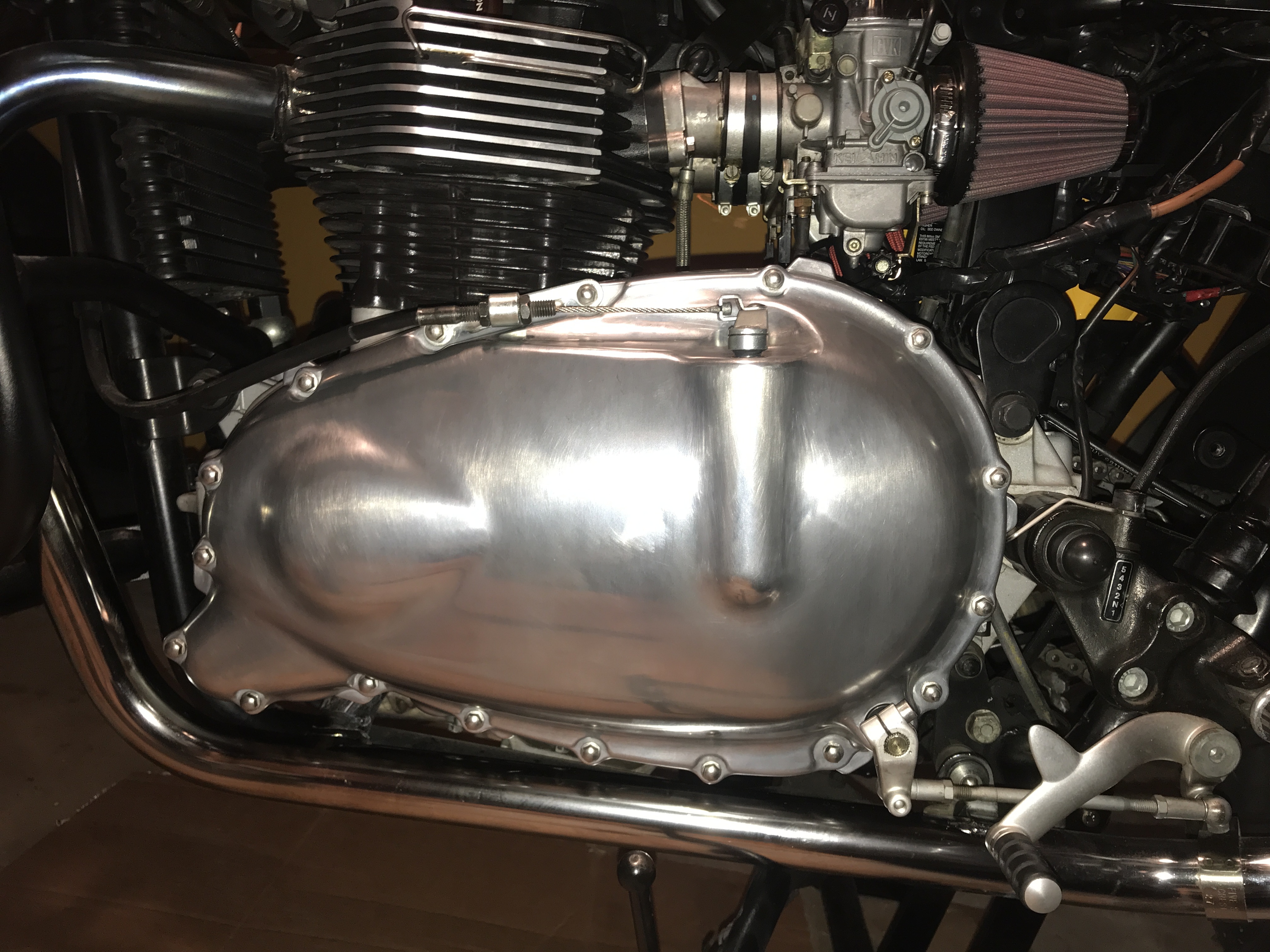

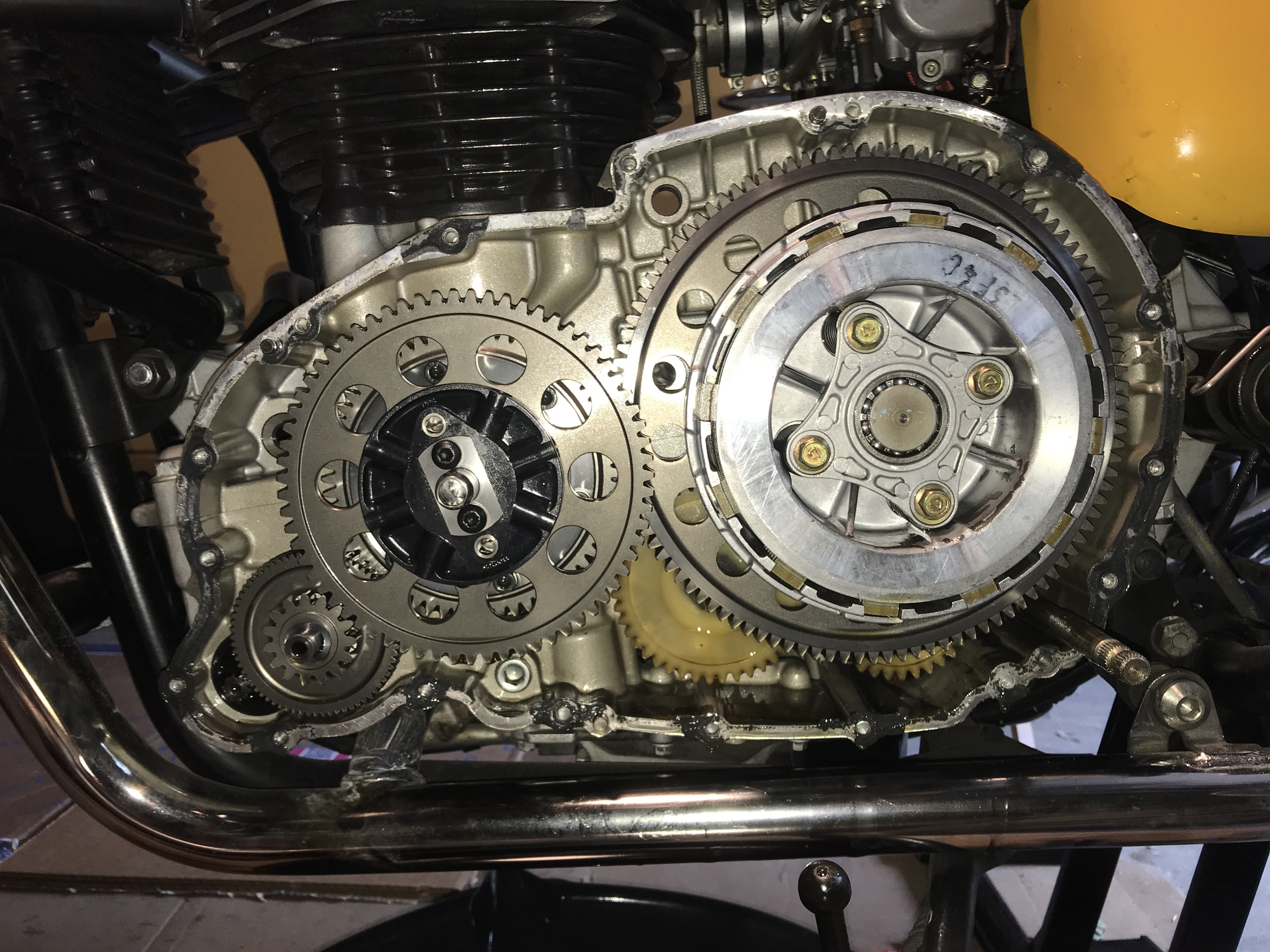

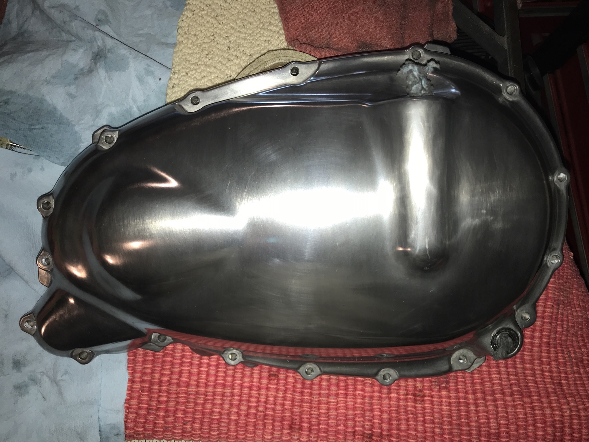

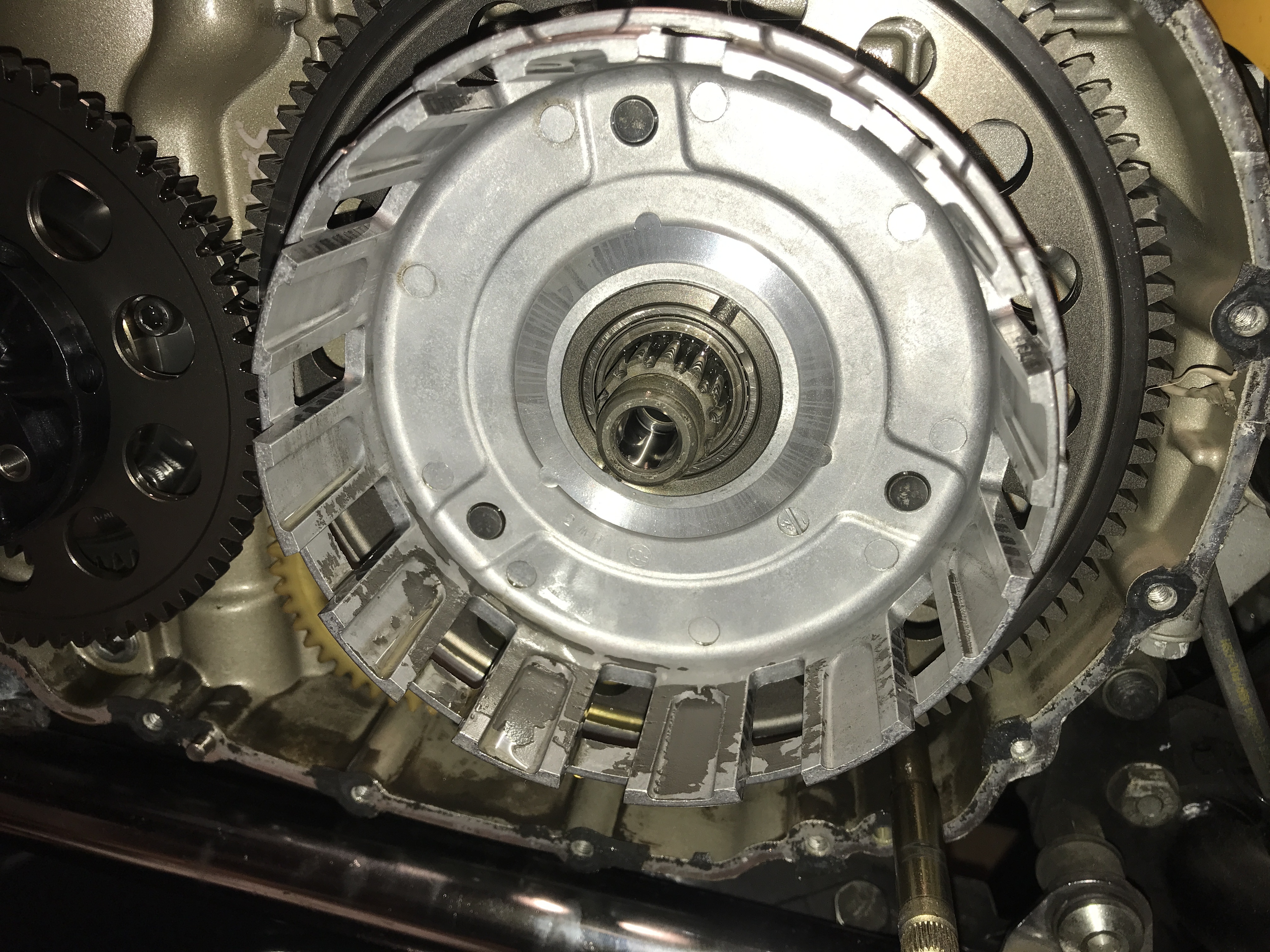

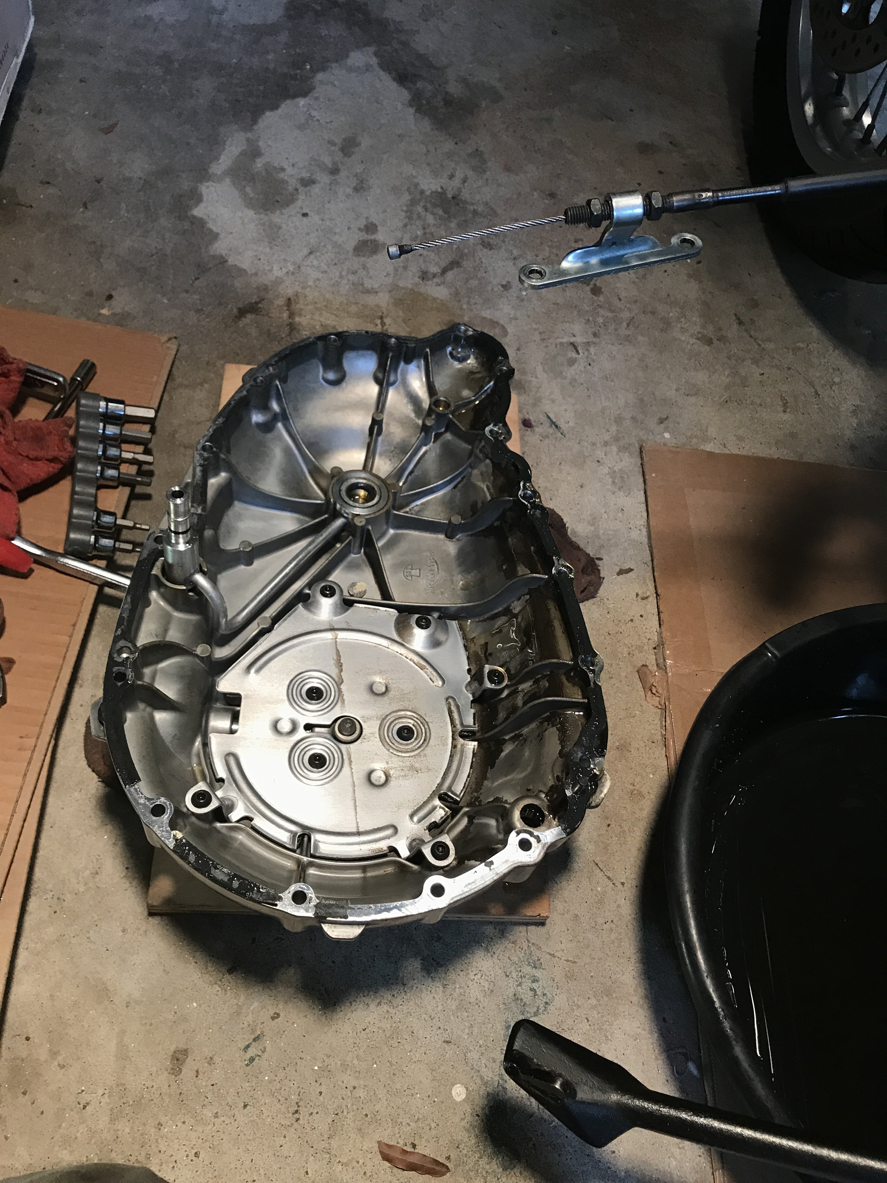

    Started disassembly. Removed shift linkage, clutch cable, and bolts. Disconnected breather hose tube and clamp. Tapped the cover with a rubber mallet and used a handy piece of wood to break the seal on the cover. Pushed the breather tube connector and wiggled the loose cover off.
    75CD7D07-10CE-47C5-8CCE-8D3C6CCDBDCC.jpeg 7270E695-5AA4-4CAE-A6C2-5ADD341E319C.jpeg 8836C7E4-7613-4CBB-A0FD-8F4F387924A4.jpeg D6F0D084-4730-420E-8FCB-37B84C7008A9.jpeg
    Nothing too unusual, some crud oil. Good chance to clean it a bit.

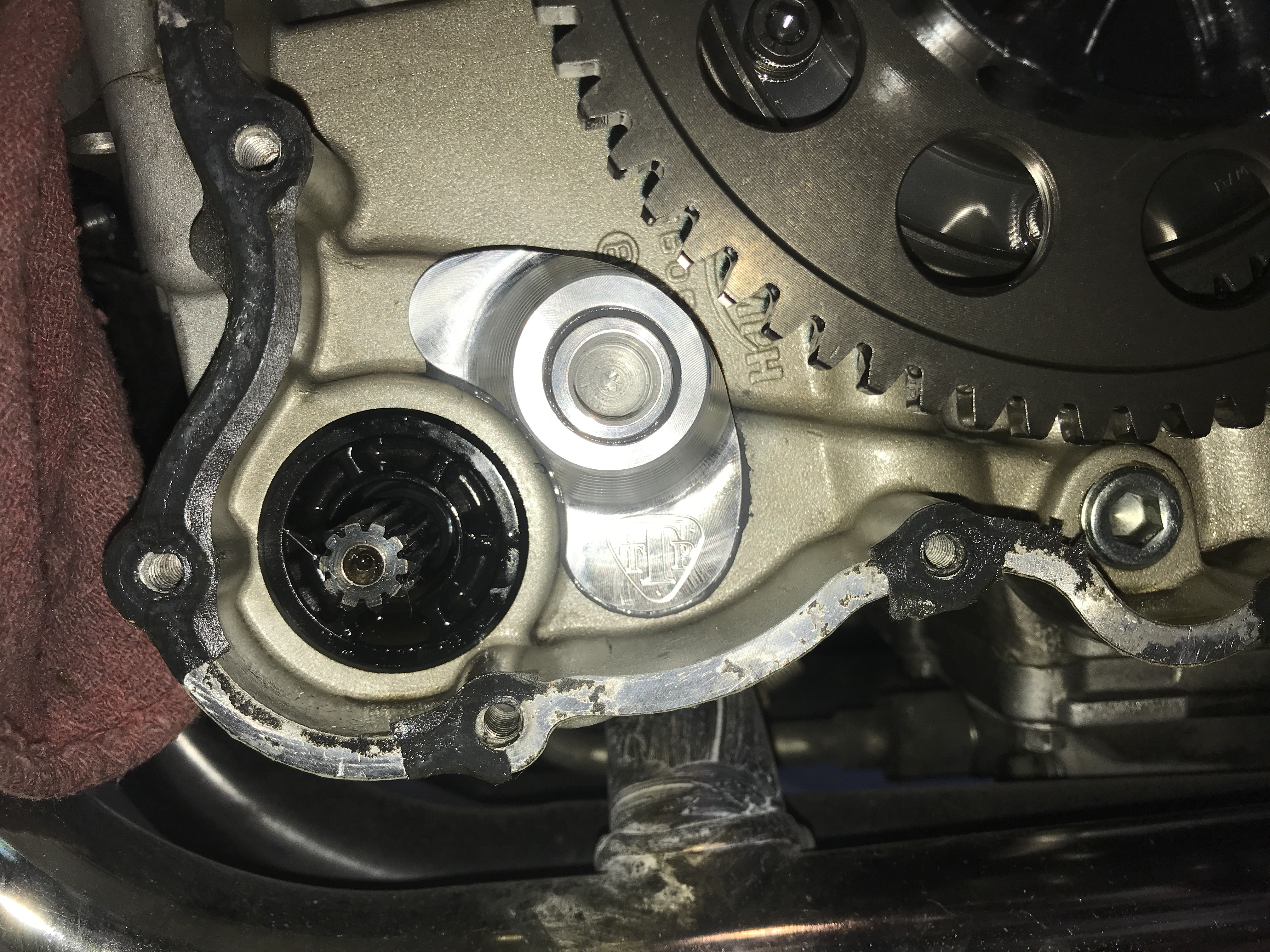

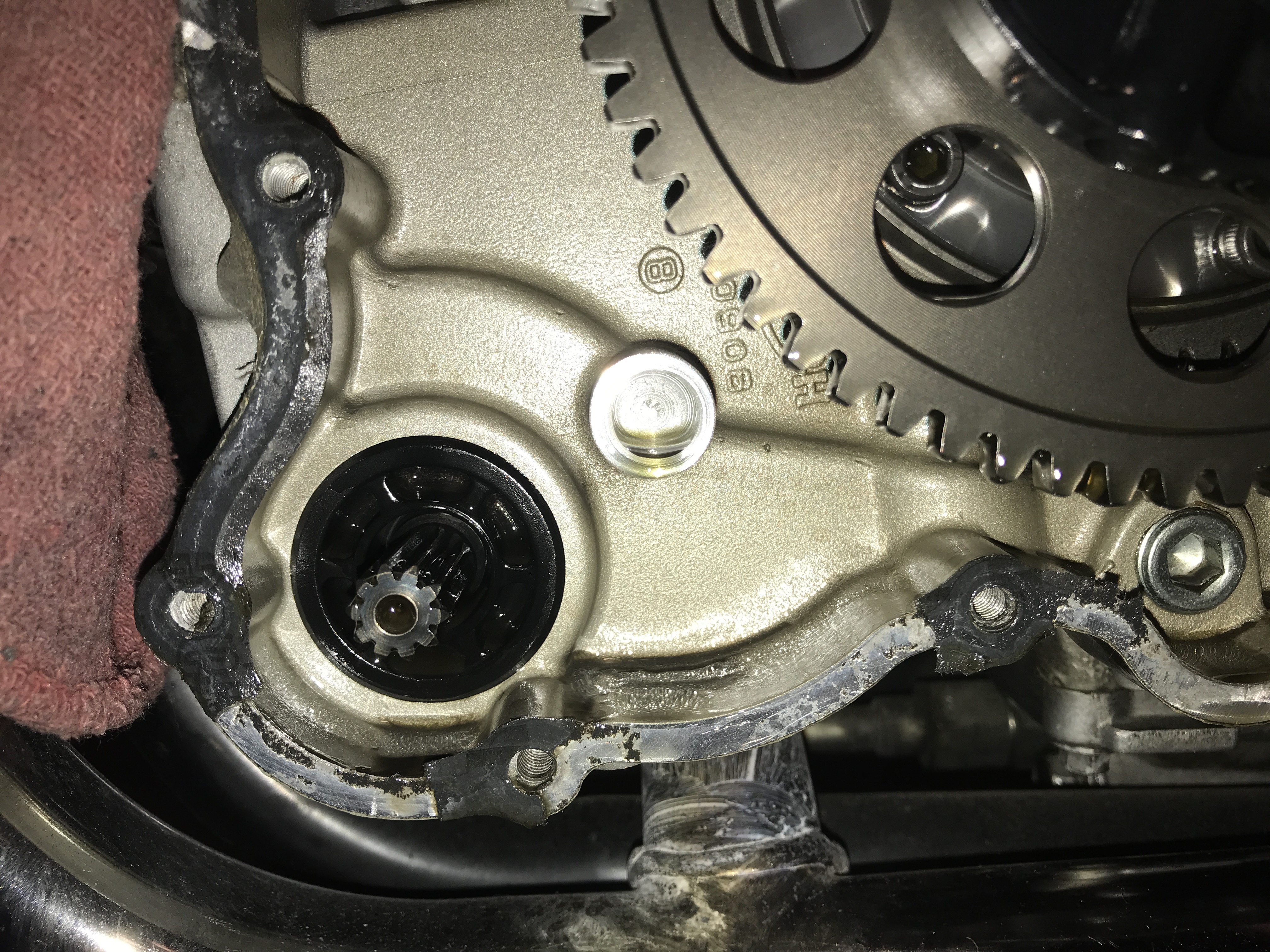

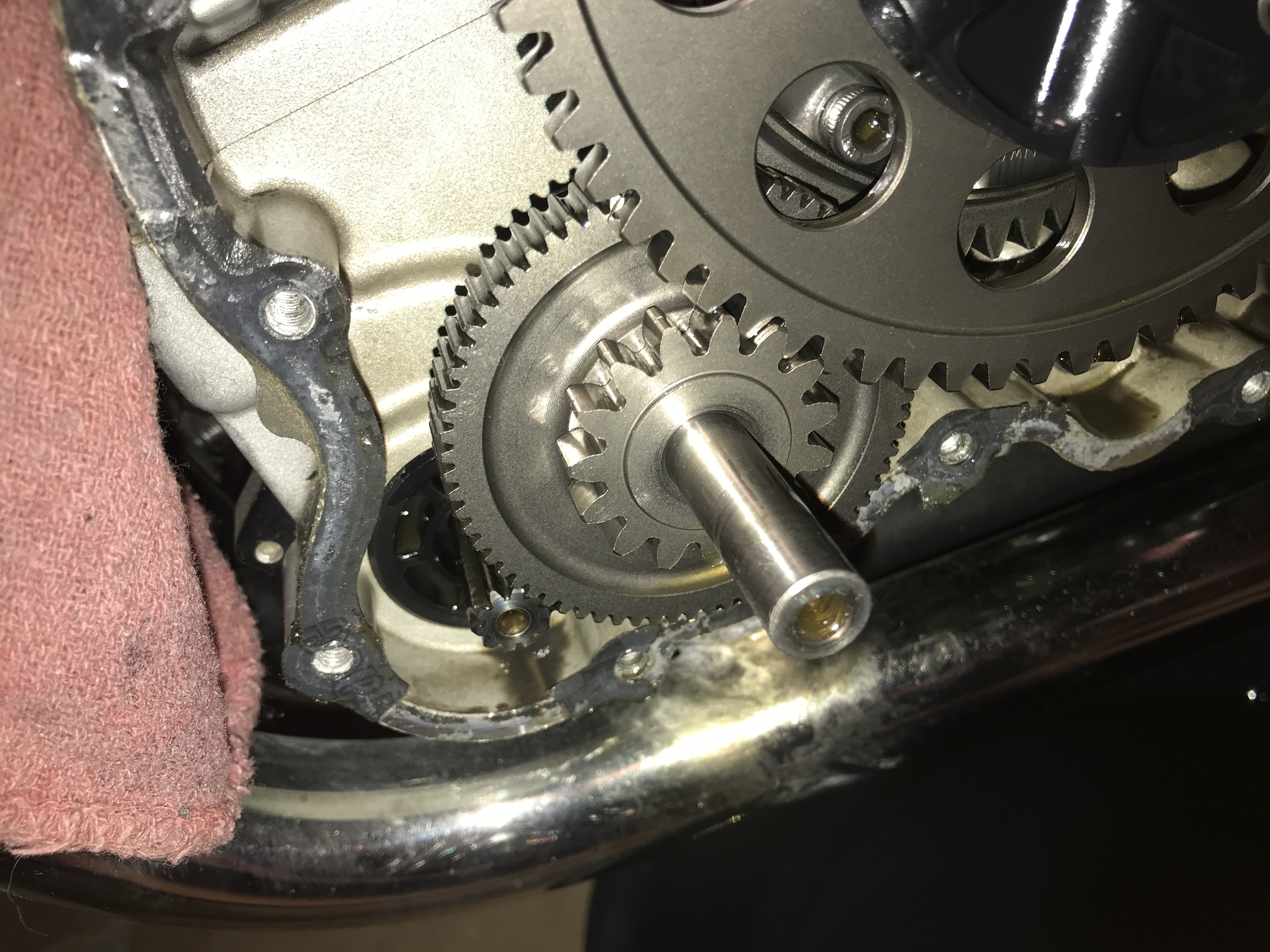

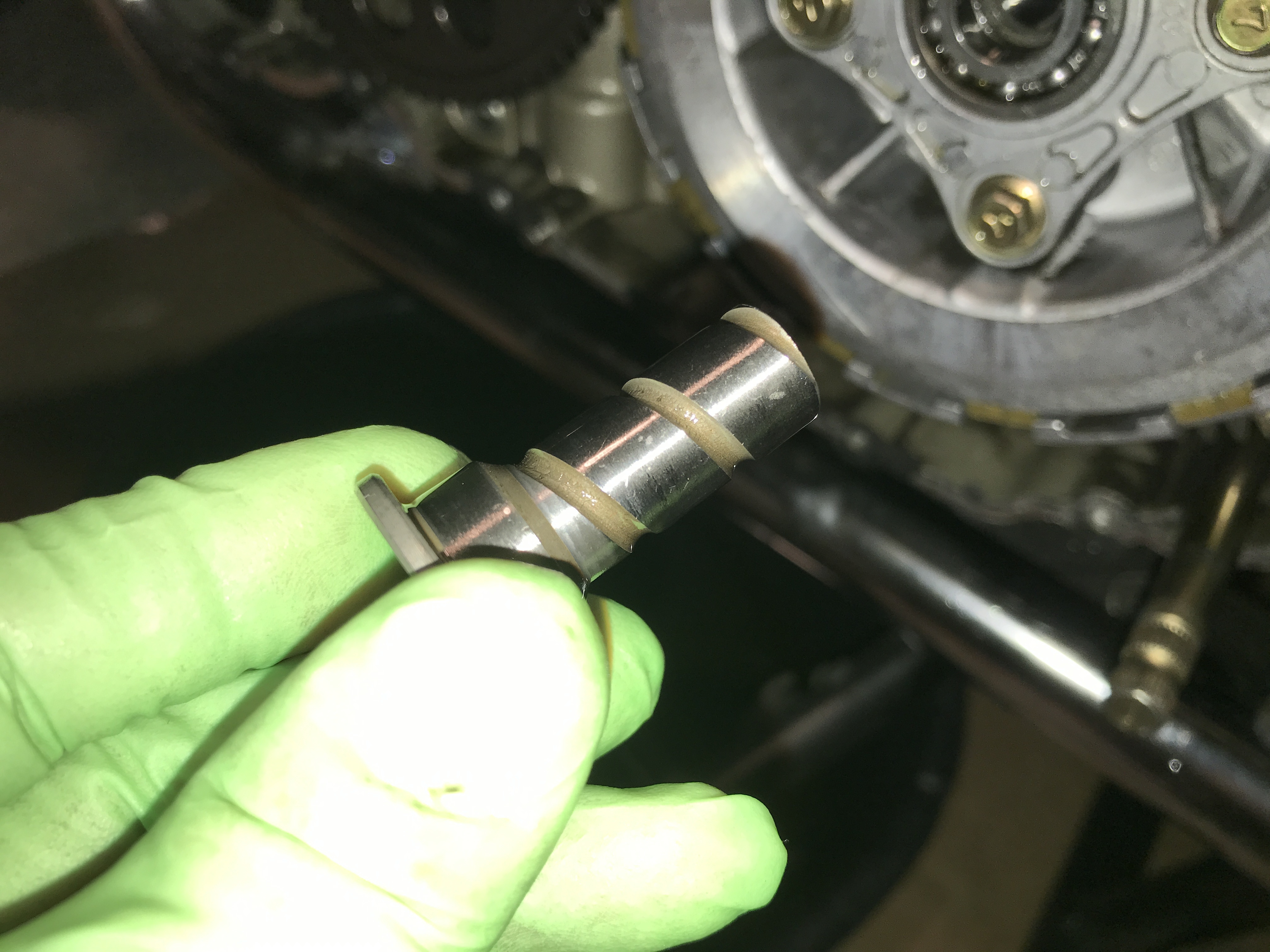

    Since I’m doing an idler boss reinforcement, removed the wavy washer, the idler shaft and the idler gear. Note the last picture, the boss walls are not even, weakest on the right side. The shaft hole is a bit offset. Reinforcement is probably not a bad idea.

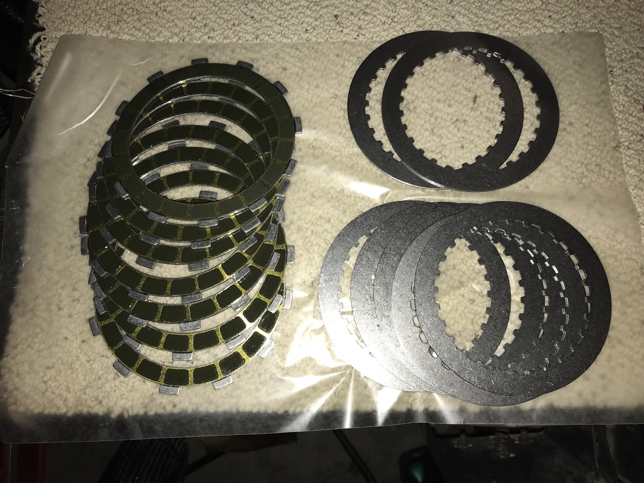

    Interesting problem. The Barnett High Performance Clutch kit has seven friction discs and seven steel discs. It should have had only six. Two of the seven steel plates are thicker and then there are five thinner discs. Question is which six do I use? 709B10D9-21DE-4BF1-A245-35D1E60E84A0.jpeg 497982C9-05D4-4A63-9AA9-FE6F484D0E8D.jpeg 1F5338D7-7A2A-4C8B-8F25-6DC4A6F0D528.jpeg
  14. sikatri
    sikatri Member
    May 23, 2019
    61
    Houston

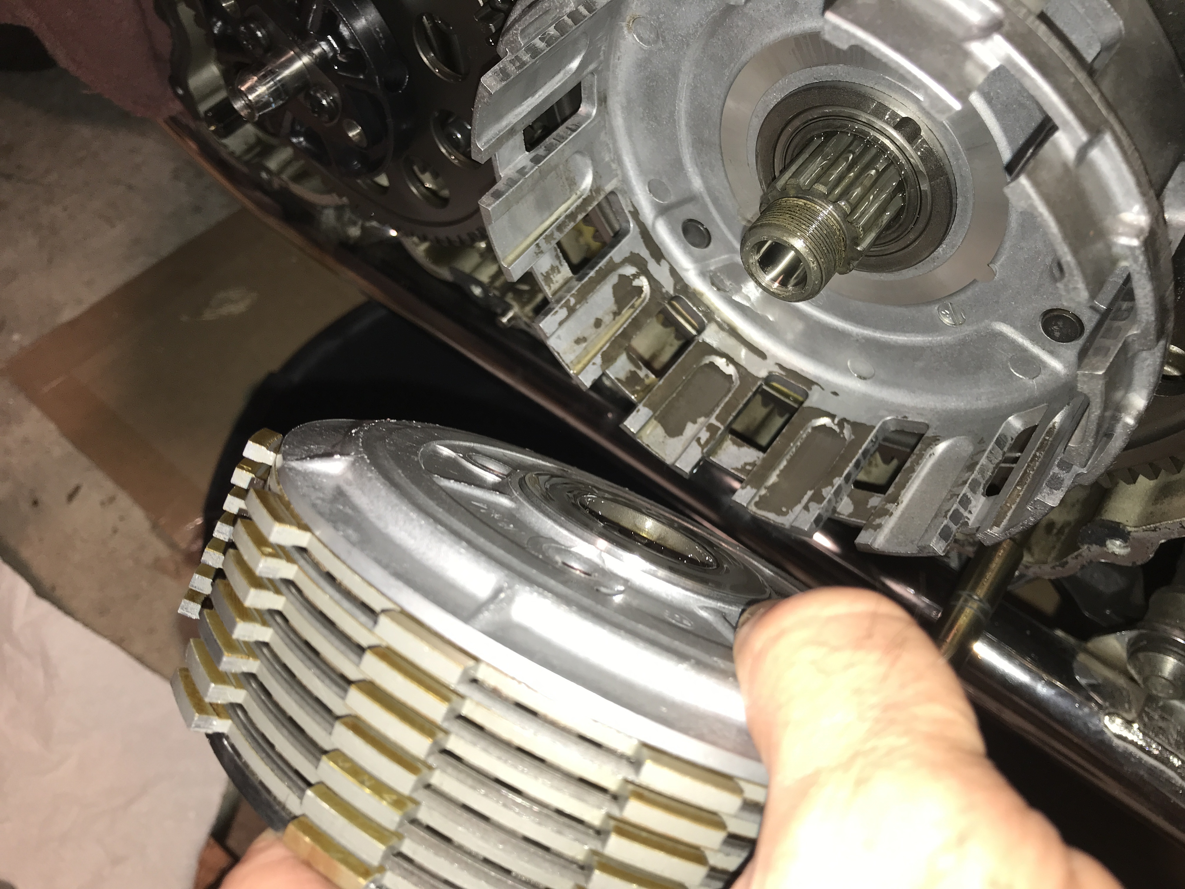

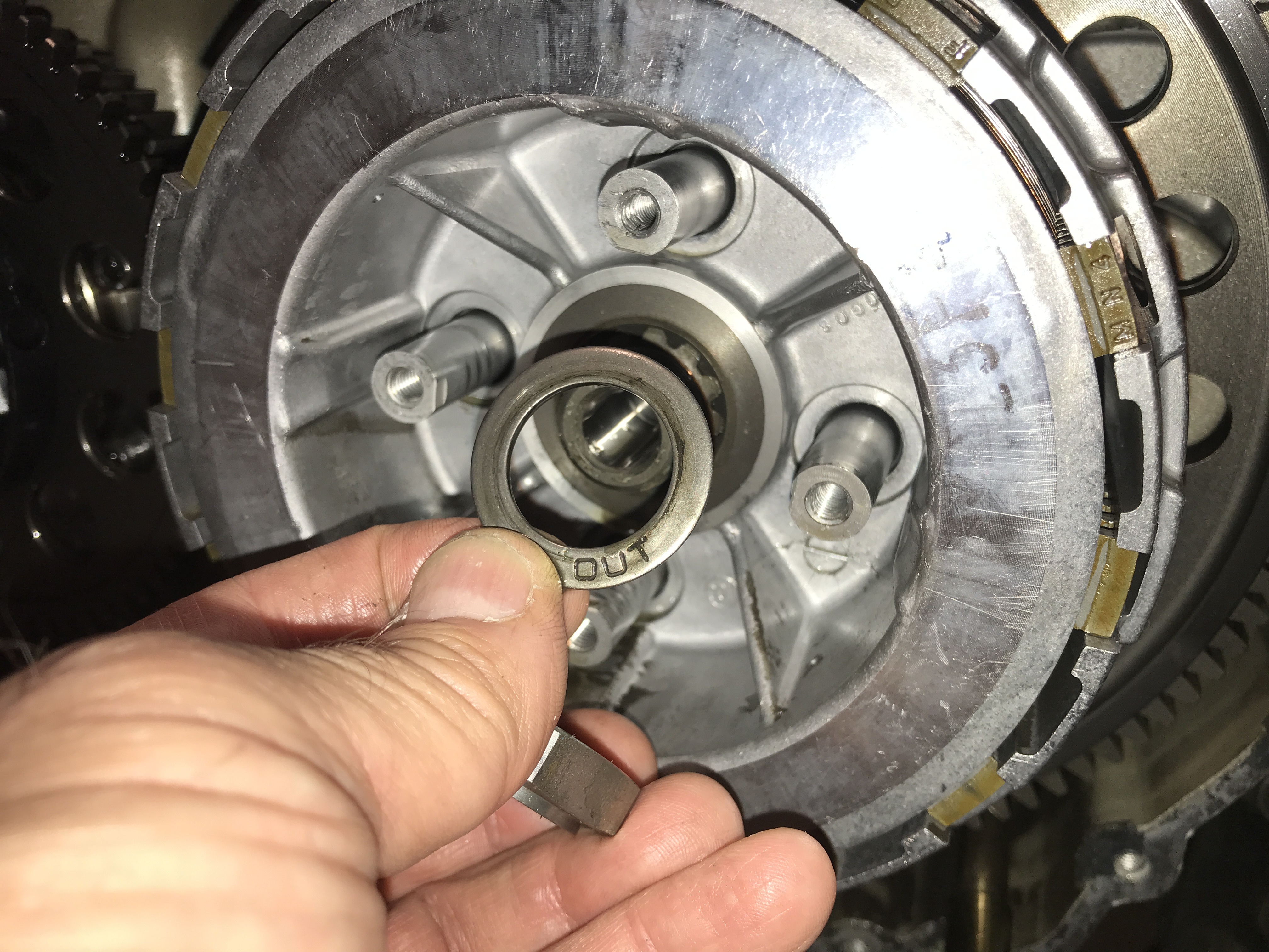

    I removed the old clutch discs Friday. I have some partial answers to my questions. I’m still curious what is listed in the part list and contacted the manufacturer. If the set is only meant to have one thicker disc or two. If with only one then is it wrong to use both thicker plates. I suspect I could use both the thicker ones and four of the thinner plates. The vendor mentioned something about being able to fine tune with a thicker disc. Sounds good. It would increase the stack height slightly.
    F0004F57-834D-41D9-BD97-CA6803139F14.jpeg 6FA63B49-B9B3-4CED-9728-DD2BE3293D5E.jpeg 79A4A992-9802-4A7F-866A-B1B9C0A206CA.jpeg 2AA783D8-FC16-44DB-B8C6-B4F8650A3B10.jpeg 5CEF1BD5-6949-49FE-90C7-77E8AD1F3950.jpeg
    The steel plates on the original have shiny patches, but the old stack is slightly thicker than my new Barnett. Go figure.

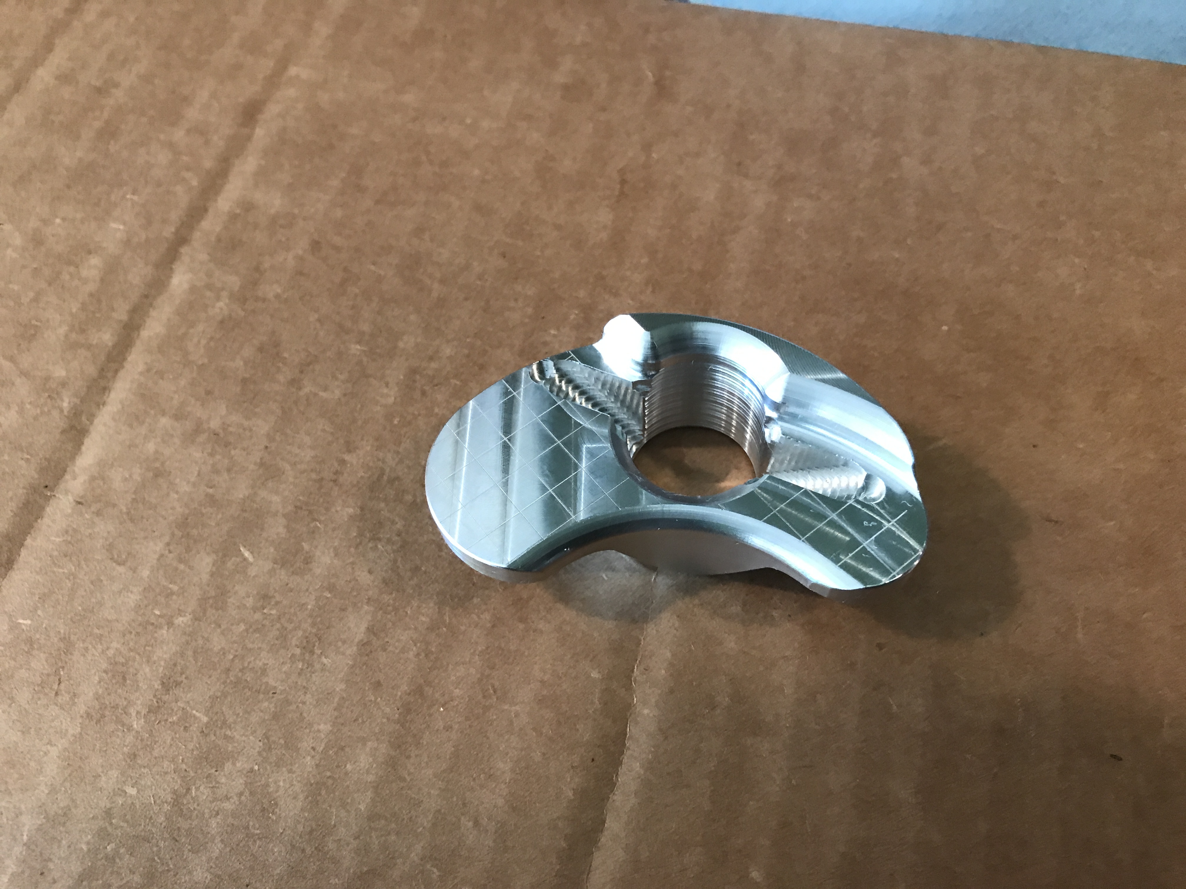

    Finally had time to work on the Thruxton again. Cleaned up the idler boss. Put the white dot on. Mixed some JB Weld and stuck the reinforcement in place. Cleaned up the edges. Now waiting 24 hours before putting the shaft and idler gear back in place.
    91E7E358-E25E-463D-A32F-1538693B5C62.jpeg 26C406F5-4D6C-4943-A3D7-6E7B9BF62CB0.jpeg 819E6F6B-A96D-4E57-9B3F-B96CDB0DFB34.jpeg D6CDEFD2-85F4-4AB1-B1FB-0FF6A300CA7E.jpeg
    Now, to start cleaning off gaskets and miscellaneous items. Waiting on a response from the clutch disc manufacturer. If I don’t get a response, I’ll install the two thicker steel plates on both outsides and four of the thinner in between. Soaking discs now. I’ve read people have different time recommendations, not sure if more is bad or less good.

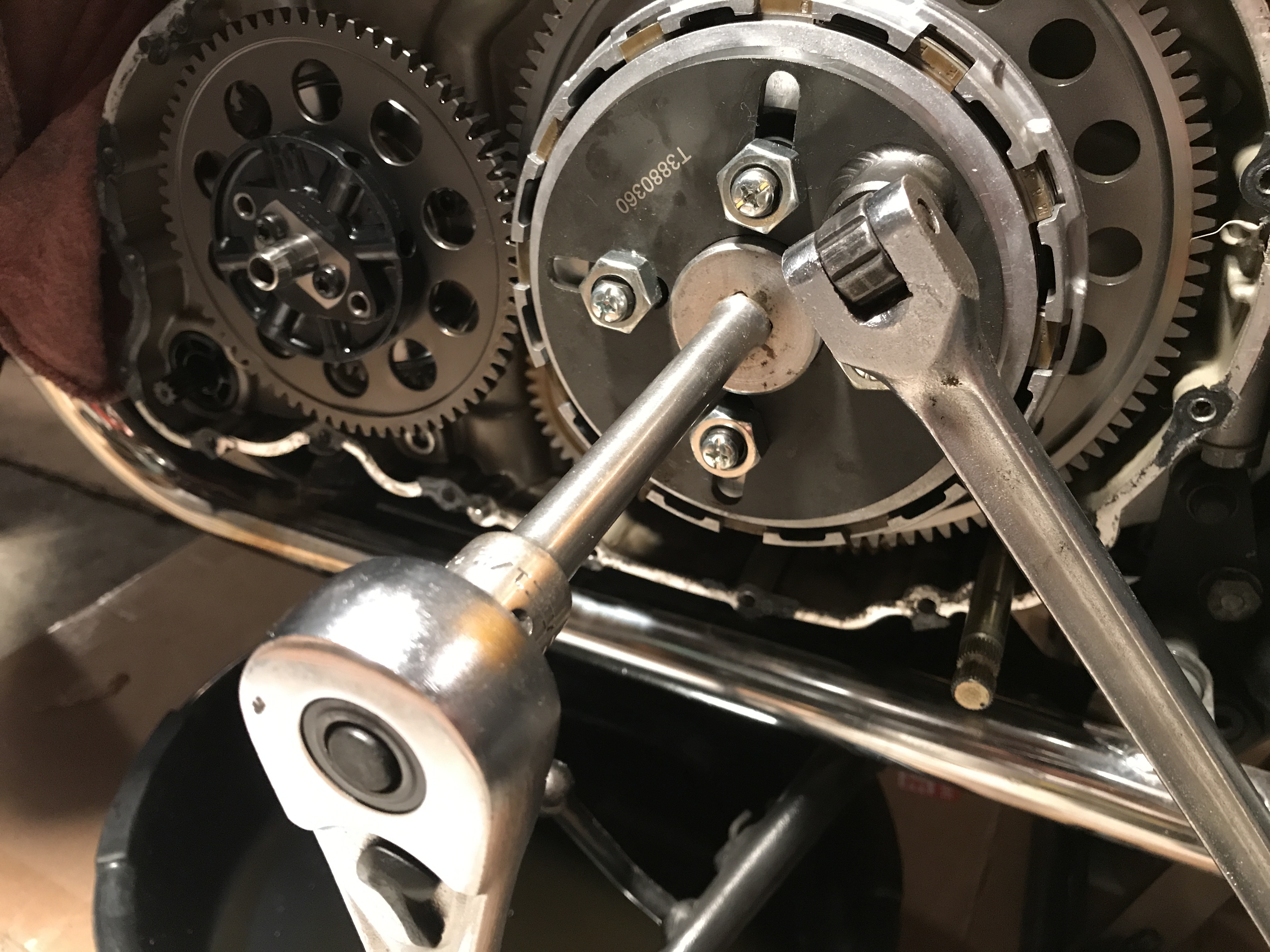

    The clutch disc replacement was a fairly straight forward job. The biggest job was removing gaskets and miscellaneous clean up I decided to do. Center bolt 105Nm. The bearing assembly torqued to 9Nm. It indeed was a very fiddly job. Took me hours to do. Had to stop and walk away two to three times. Done in an afternoon though. Then complete the clean up and remember to install the wavy washer on the idler boss gear shaft and install cover. Cover bolts at 9Nm as well and the gear selector screw 9Nm. Fill with oil and done.

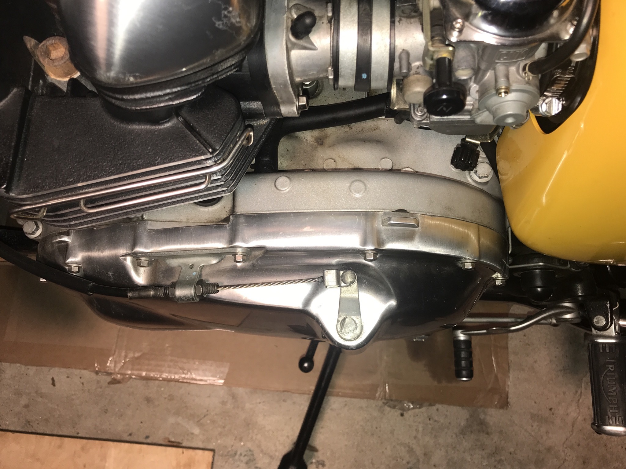

    Houston

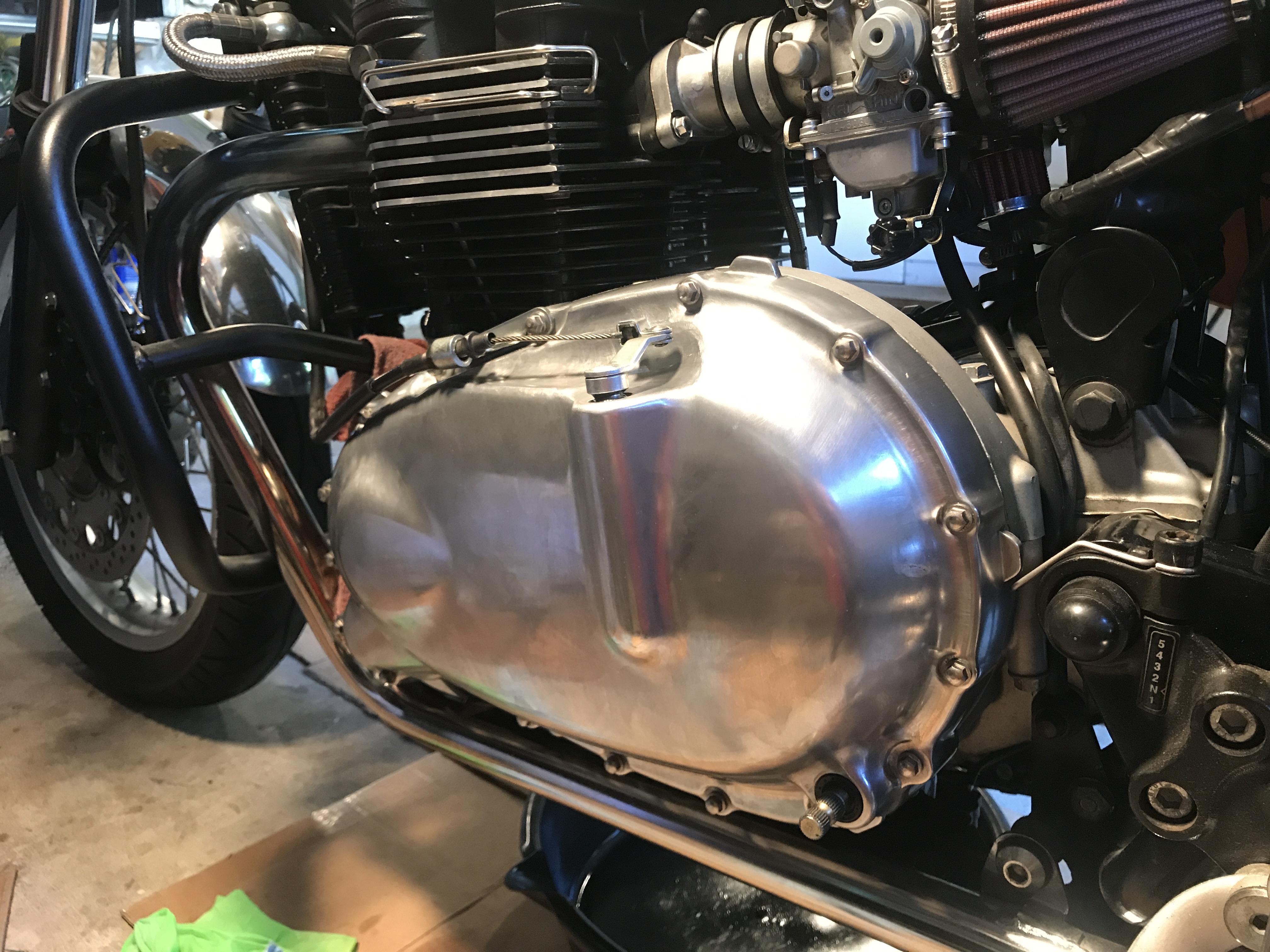

    The final steps, cover and adjustments. Time to ride!
